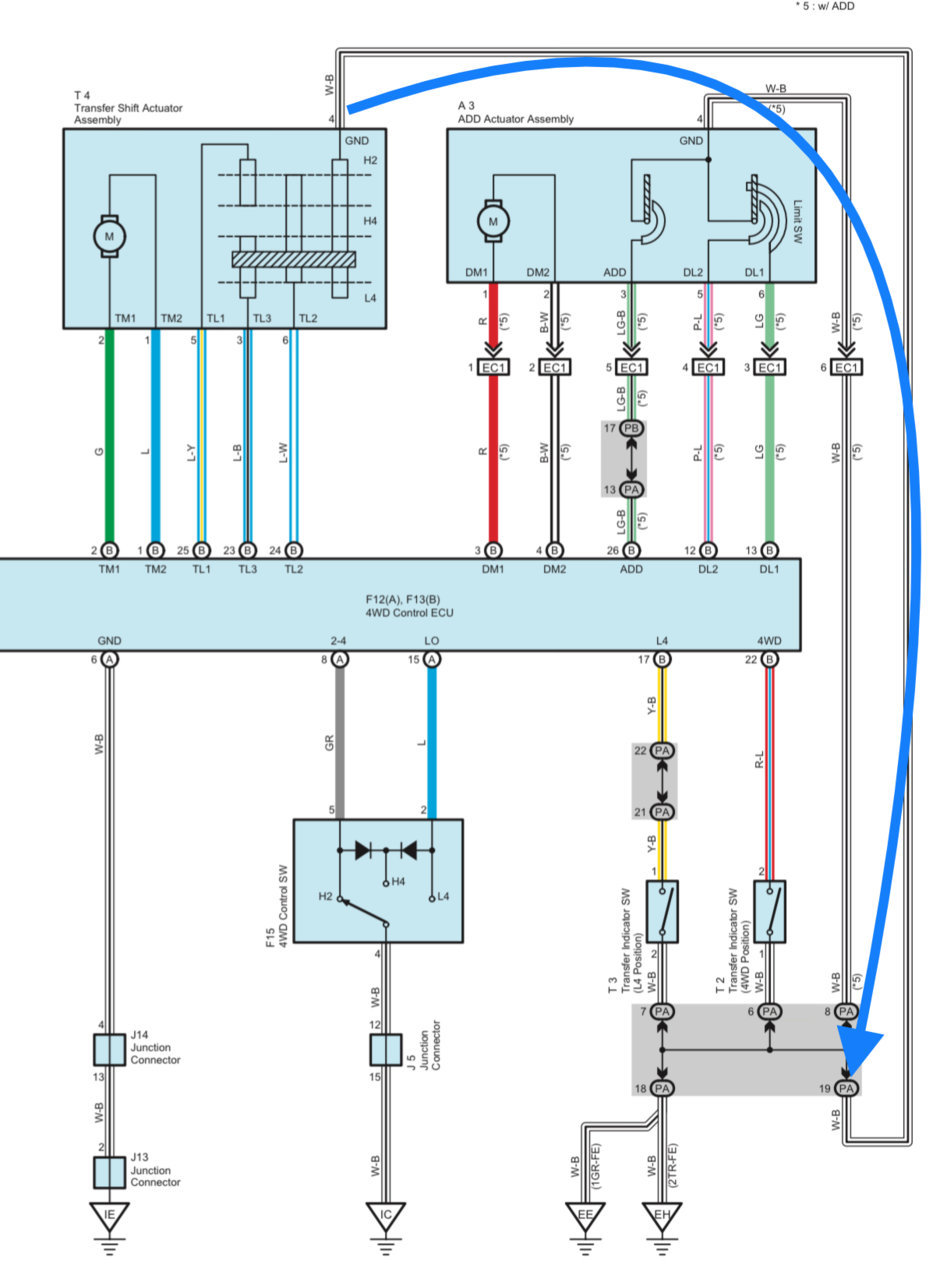

    Okay really quick.
    In your diagram, 4 is GRND.
    the 5&4 that I checked are Blue and green wires based off the T4 connector diagram I’m looking at on page 1.
    If you mean the ground as Pin 4, I did that incorrectly lol
