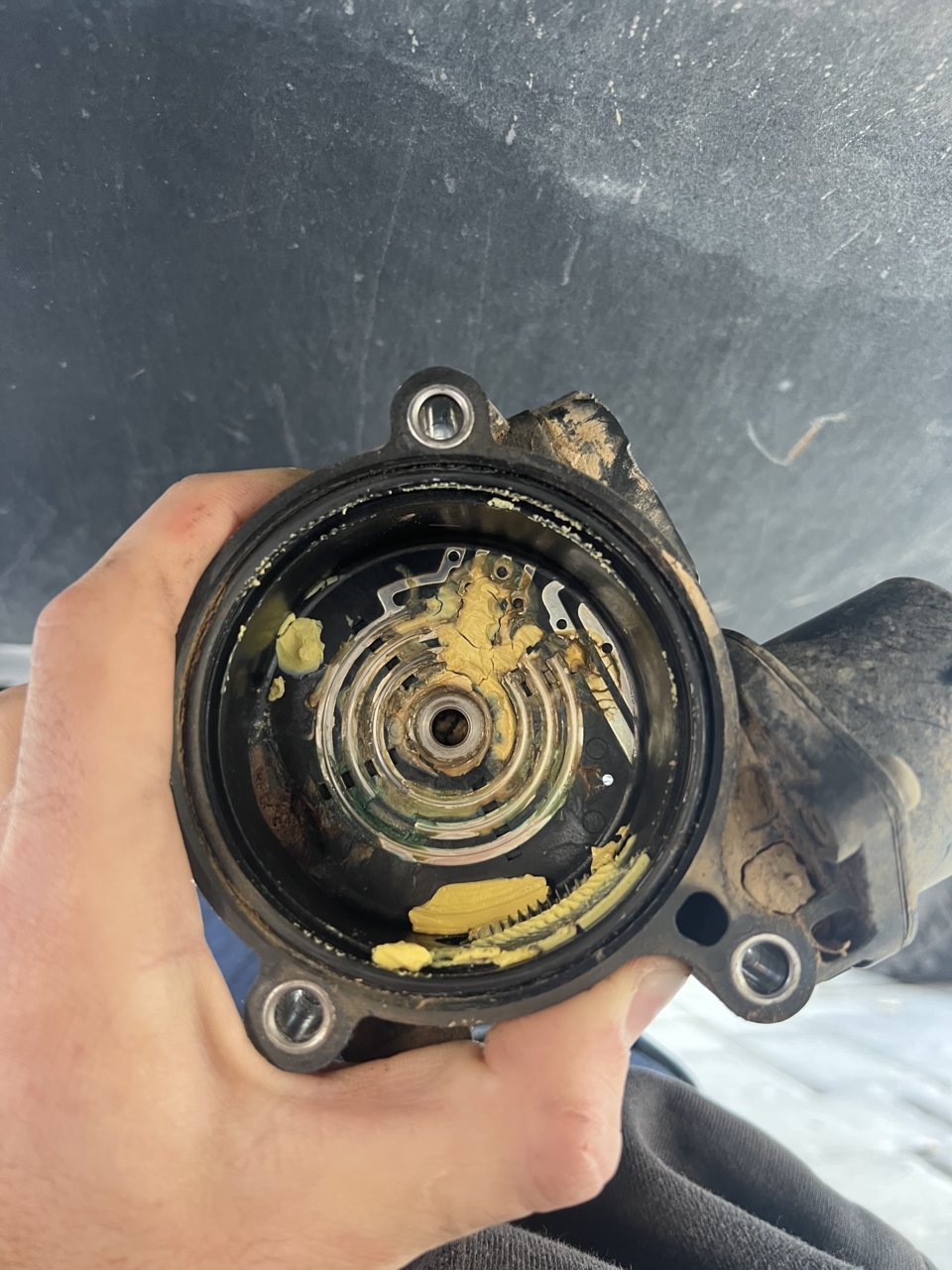

    So is there any chance that the black cover of the Actuator where the contacts are for the TL1-3 and Ground is where I’ll find my problem/possible corrosion?
    I’m watching the YouTube video on how to take it off and am wondering if it’s possible to check that without taking the whole actuator off just yet. I see it’s only 3 10mm which is an easy pop off, take a look and if I don’t see anything I put back on til next time I work on the truck next and can test the actuator motor and look at the rest.
    Thank you for all your help dude. Truly saved me a lot of swear words and migraines. Now I can focus all my hate and discontent on just this actuator.

    There is a very good chance.
    That’s what I would do.

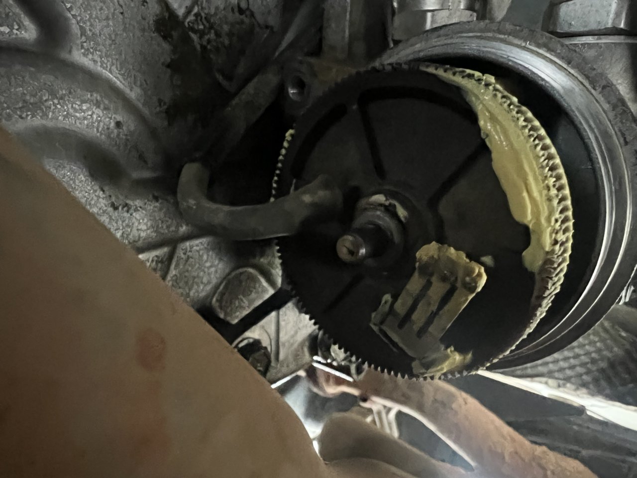

    Yellow Playdoh

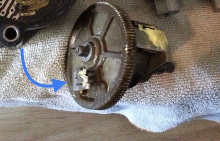

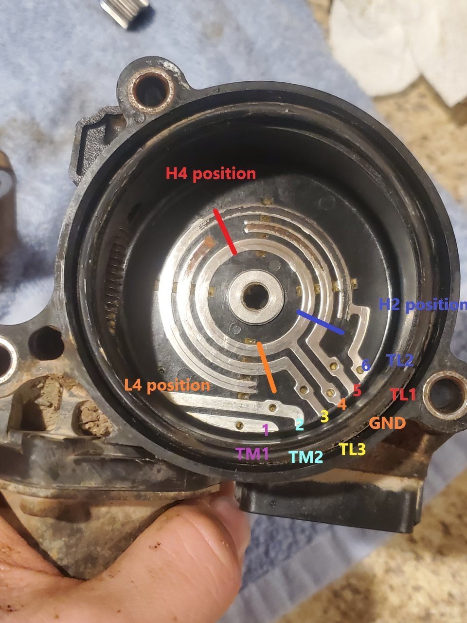

    I see what looks like green goo. That’s usually not a good sign.
    Try cleaning the traces off.
    You can use dielectric grease in-place of the yellow when going back together.
    For testing, you don’t really needed it. - Longer term. You do.
    Wipe the yellow grease off. Inspect the traces.
    You are looking for issues with the TL1 and GND traces.
    You also need to look at the little fingers on the gear.
    Those fingers are what make contact with the traces.
    Those little fingers “connect” TL1 and GND when in 2WD.
    Little fingers
    Jimmyh, Dm93[OP] and TacoZim like this.

    Yeah I saw the greenish plague in there and seent that it was corrosion in another post on here. Gonna get in there nice and deep like and see what we’re working with. Is there a better way of cleaning this all out?
    Running to store to get some dielectric grease now.
    Took a pic of the fingers on the gear but my phone made the resolution look like I took it with a potato.
    Dm93[OP] likes this.

    Side note: I did look at Willthethrill’s post about manually spinning that brown gear with the fingers on counterclockwise and it should be in 2H. So I tried rotating it by hand and I couldn’t move it so I figure it is all the way in 2H?

    Hey guys srry I've been busy all day, haven't had time to respond but looks like @TnShooter has gotten you squared away.
    As long as you don't pull that gear out you won't lose your timing, if you do take it out mark the way it was and reinstall it back the same way or you will have to be re-timing it manually.

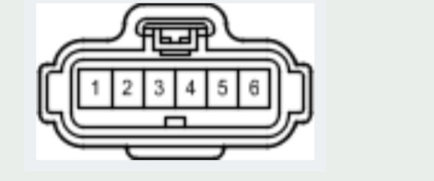

    just getting some time away from the wife and kids to continue. Can you confirm that the connector to unplug is at the transfer case? Then check the voltage at the ECU?
  17. Dec 18, 2022 at 4:12 PM
    #437
    TnShooter
    TnShooter The TacomaWorld Stray
    Sep 2, 2010
    #42625
    20,983
    Deogee
    07' TRD Off-Road, Auto
    STOCK
    You already checked the voltage at the ECU.
    It was 1.1v
    By unplugging the connector at the Transfer Case and checking TL1.
    We are confirming where the short is.
    If you unplug the connector and check pin #5 (TL1 # Blue/Yellow wire) and it reads 12v
    The wiring is good to the Actuator.
    If you have the same 1.1v then the wiring between the ECU and actuator is shorted.
    Actuator harness
    Travel John[QUOTED] and Dm93[OP] like this.

    Yes unplug the transfer case actuator and verify your voltage on TL1 goes to 12v, if it doesn't then the wire is shorted somewhere, if it does then the problem is likely in the Transfer Case Actuator.

    11.47V in 4H @ pin #5 (TL1 # Blue/Yellow wire)
    Is the next logical thing to open the plastic case and look for corrosion / clean?
    Grateful!
