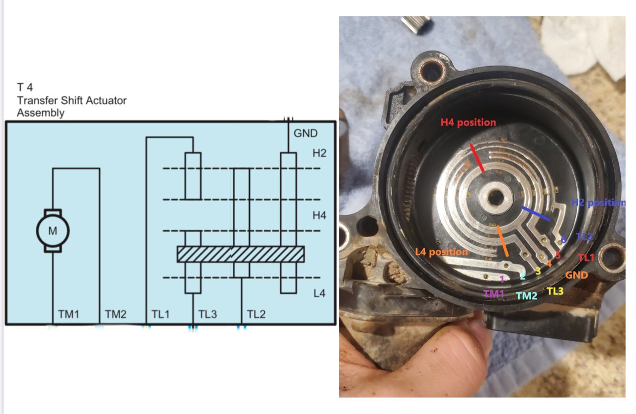

  15. Dec 19, 2022 at 12:15 PM
    #475
    Williston
    Williston Well-Known Member
    Aug 21, 2021
    #374833
    2,472
    New England
    2014 Tacoma SR5 4x4 DC SB V6 AT Tow Pkg Entune+ Mostly stock with a few OEM mods.
    Stock (99.999%) OEM Bed Floor Mat, Front Bed Rail Cargo Net and hooks, Auto-Dim mirror w/Compass and outside Temperature display, TRD Pro Grille, Uni-Filter air pump modification, WeatherTech floor liners f/r. OEM All-Weather floor mats (summer).
    I think one of the most valuable pieces of this thread (for me anyway) were the sequence of pictures showing the disassembled control actuator motor, initial interior shots after the cover was removed, pics of the gear wheel, the inner contacts, re-lube and prep and more. Seeing it apart this time finally made it "click" for me and understand clearly what goes on in there when you turn the knob as well as confirming a possible repair was possible, (and reasonably likely) without removing it and/or replacing it. The simplicity of it also impressed me.
    Those pictures and the narrative back and forth between the main players convinced me that if mine ever starts acting up, I can do this too: at least this initial testing, disassembly and inspection without tiny springs and little ball-bearings flying everywhere to disappear forever (ask me how I know) and ending up with my truck on the back of a flatbed going for a ride to the dealer.
    TnShooter[QUOTED] and Dm93[OP] like this.
  16. Dec 19, 2022 at 12:43 PM
    #476
    TnShooter
    TnShooter The TacomaWorld Stray
    Sep 2, 2010
    #42625
    20,869
    Deogee
    07' TRD Off-Road, Auto
    STOCK
    Yes, that picture of the actuator disassembled is much easier to read than the diagram in FSM.
    Once you understand how it works, the diagram make total sense.
    I take it you too were confused at first.
    Until I had a good understanding of how the system worked, theses 2 pictures had nothing in common. :rofl:
    Williston[QUOTED] and Dm93[OP] like this.
  17. Dec 19, 2022 at 1:52 PM
    #477
    Williston
    Aug 21, 2021
    #374833
    2,472
    New England
    I was confused and unclear from the past pics of the circular contacts (inside) all alone in the pictures of the cover. I still don't have a severe-clear visibilty picture in my head, but I'm getting there. :smack: Let me know if I have it correct now: I have it in my mind as a cover: remove the bolts, remove the cover and turn it over and there are contact paths underneath. (Like a distributor cap) The light finally went on when I saw the pic of geared contact wheel with the three contact fingers in focus all alone in there: It's the last piece at the "bottom" sitting next to the transfer-case housing. Leave it alone and clean them in-place. Somewhere underneath it, on the edge of the circular housing is another hidden gear turned by a electric motor. Those pictures also drove home what the penalty would be if you were to remove it without thinking or not knowing what you were doing. Conversely, it also made clear why you really didn't have to remove it. It looks like you could do delicate surgery to clean and lubricate those three parts right in place. The contact "runners" look robust, but I would treat those three sprung contact fingers with a wary surgeons delicate touch if trying to clean them or more risky: attempting to adjust them. I didn't understand the labels TM1, TM2 and TM3 until today. They are the pathways to the hidden spring fingers. (I hope):rolleyes:

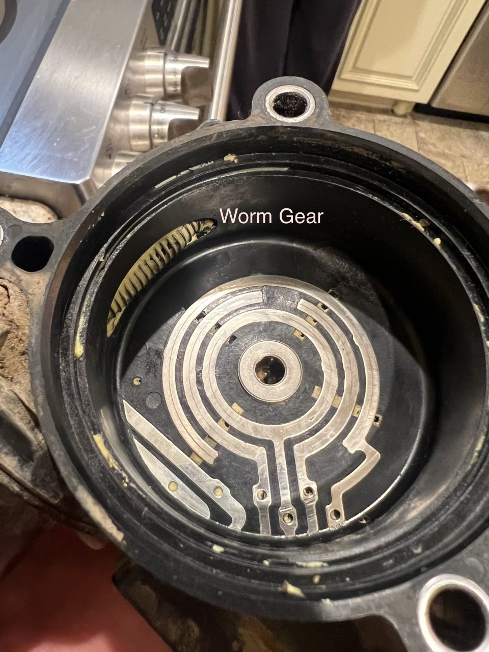

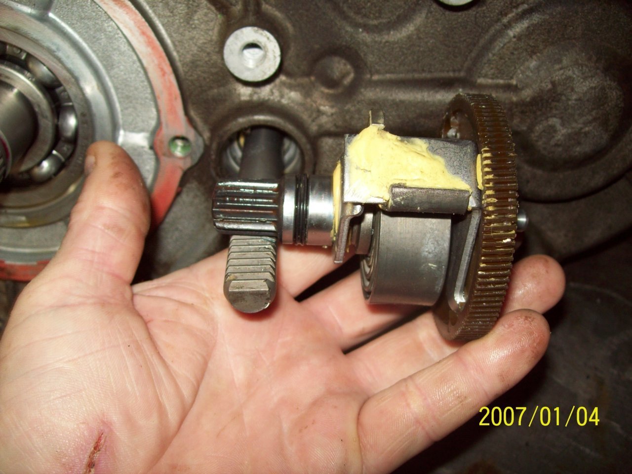

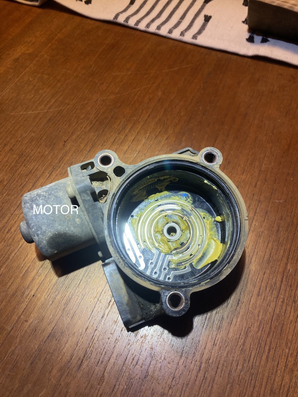

    The electric motor is on the piece you take off.
    The motor turns a worm gear, that turns the big gear you leave on the truck.
    Under the big gear, is smaller reduction gear. That gear drives (pushes) the shift rod.
    Motor
    Worm Gear
    Big gear (driven by worm gear)
    Reduction gear and shift rod (picture is from a 1st Gen, operation is the same)

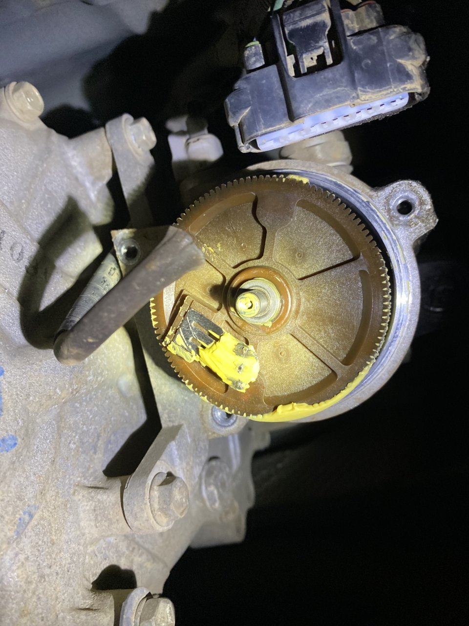

  19. Dec 19, 2022 at 2:55 PM
    #479
    Williston
    Aug 21, 2021
    #374833
    2,472
    New England
    OK: Got it! :thumbsup: The pic (#3) with the toothed wagon wheel look is the first thing you see when the cover comes off: and there are the three little contact fingers that run along the circular paths on the cover barely peeking out from the globs of yellow grease. Leave it in place. Thank you for sticking with me through this. It makes perfect sense why regular operation of this system helps to keep the contacts communicating and why long-term hibernation with no exercise, heat, cold, old grease and condensation causes contact problems.
    Dm93[OP] likes this.
  20. Dec 19, 2022 at 3:02 PM
    #480
    TnShooter
    Sep 2, 2010
    #42625
    20,869
    Deogee
    STOCK
    Correct. Leave the big gear with 3 fingers in place.
    Do NOT remove it. Clean it while it’s still in place. (On the truck)
    If you have to remove it, MAKE SURE to mark the position it is in.
    Put it back in exactly the way it came out.
    Do NOT press the shift rod in or out. Other wise, you will have to retime the actuator.
    You do not want to do this.
    Again, don’t remove it unless you HAVE TO.
