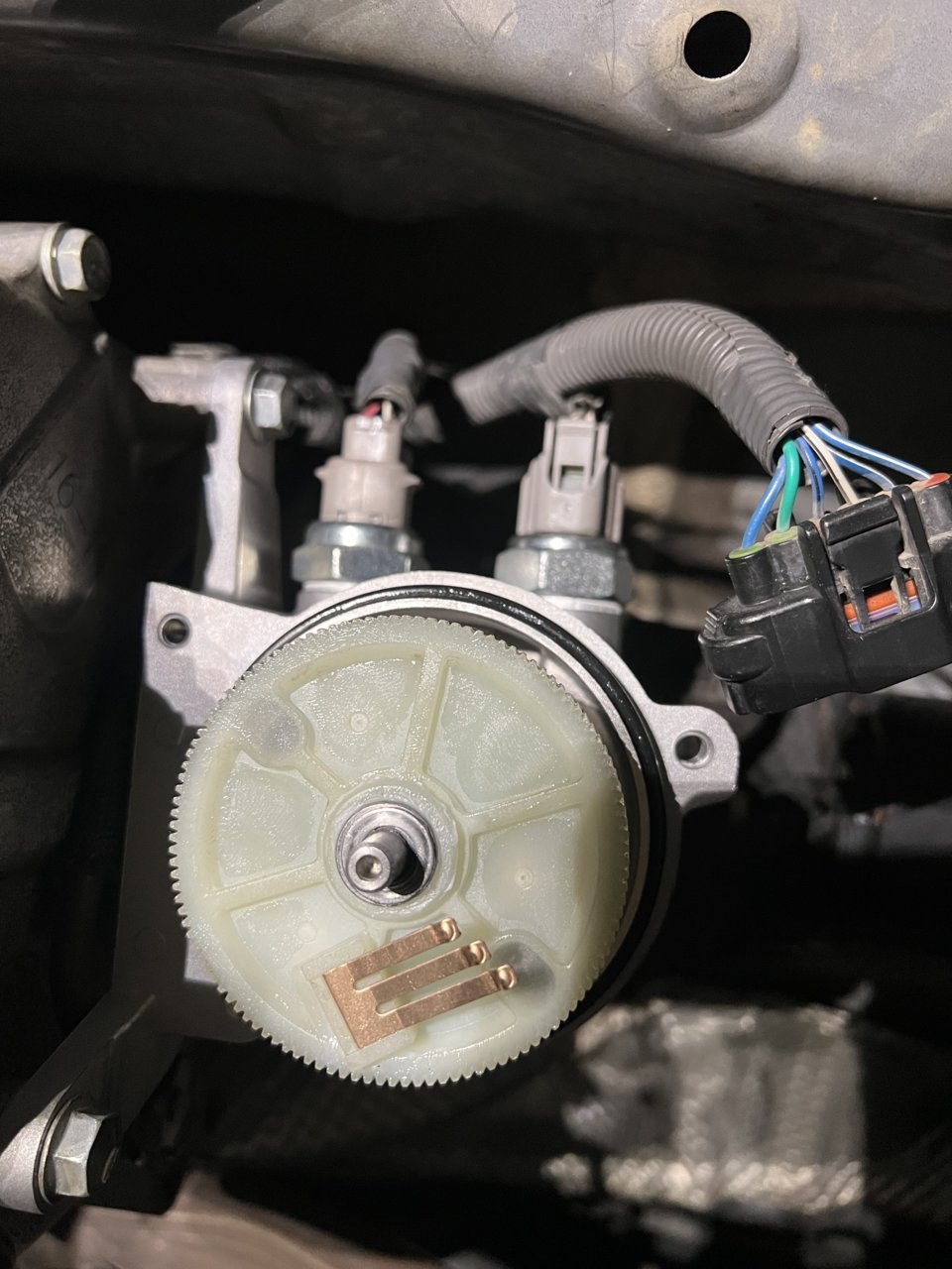

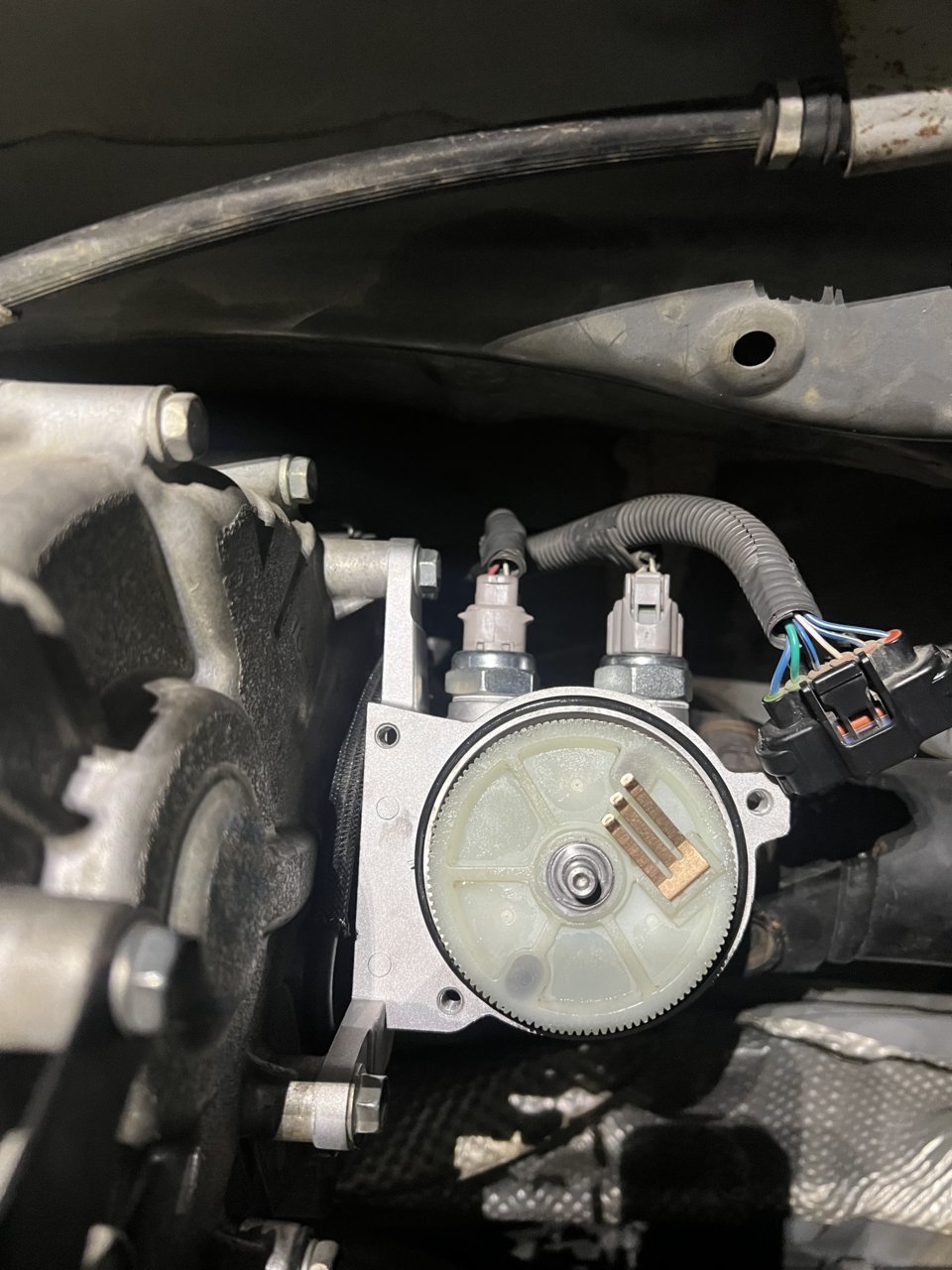

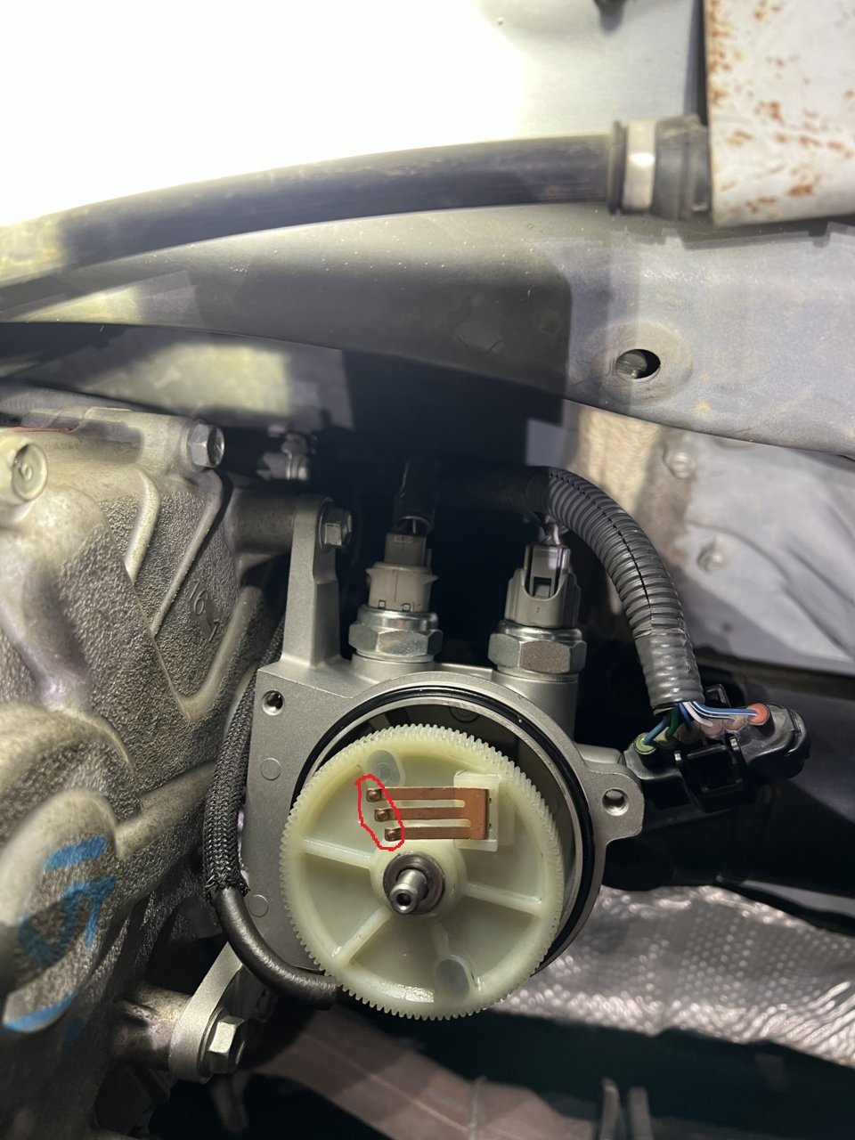

    Tried 4 different positions with no luck! 96D13B12-EC36-4012-8446-883C08CD3DFC.jpgF1344AB9-48FB-436A-A2D3-C7472DD95F5A.jpgA36161C1-174D-46EC-A163-C06321E631C9.jpg3763DA2B-4888-4B7F-B5BF-A7D4563F2AAA.jpg

    First make sure the Transfer Case is in 2wd by rotating the gear as far counterclockwise as it will go then line up the contacts so they match the 2wd position on the cover.
