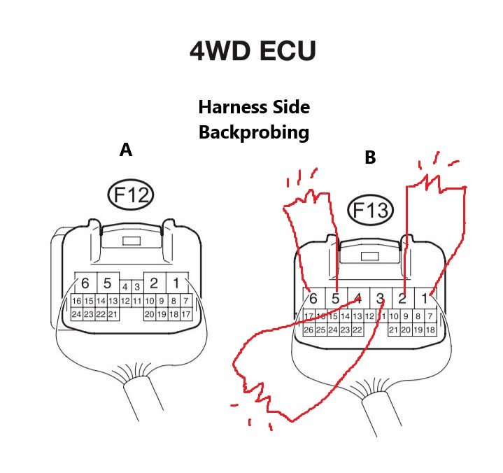

    Yea test light, meter, and something to backprobe with.
    Yes if you have something suitable to backprobe the connector with.
    Forgive the crude drawing but this would be my setup if I was testing it I would want to check the following when the buzzing is occurring and see what we have:
    Test light across power (F13 Pin 5 (Violet)) and ground (F13 Pin 6 (White/Black)) coming into the 4wd ECU.
    Test light across F13 Pin 3 (Red) and Pin 4 (Black/White) (ADD Motor Circuit).
    Test light across F13 Pin 1 (Blue) and Pin 2 (Green) (Transfer Case Actuator Motor Circuit)
    You will need to be very careful to not touch the pins together while testing but this is how I would do it.

    Ill get my supplies and try to do it this weekend.
    Let see what happens.
    So im assuming i alligator clip one back probe and touch other back probe with tip of the light?
    can i put a piece of rubber in between the two probes to make sure they dont touch?
    Thanks again

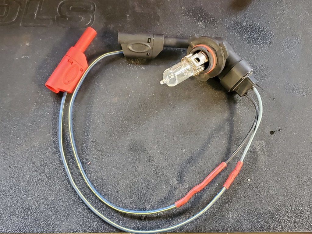

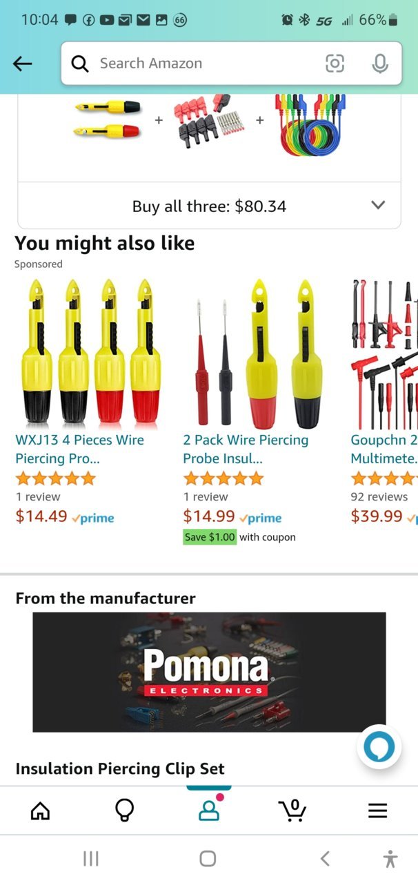

    Yes, you may need another person to move the switch for you though.
    I made several test lights from old light harnesses with banana jacks on them for ease of use.
    That would work I guess.
    These work well when backprobing is inconvenient, the genuine ones are pricey but the generic ones are relatively inexpensive.
    Only note is if you use them on exterior wiring put a dab of liquid tape on the hole in the wire when you are done.

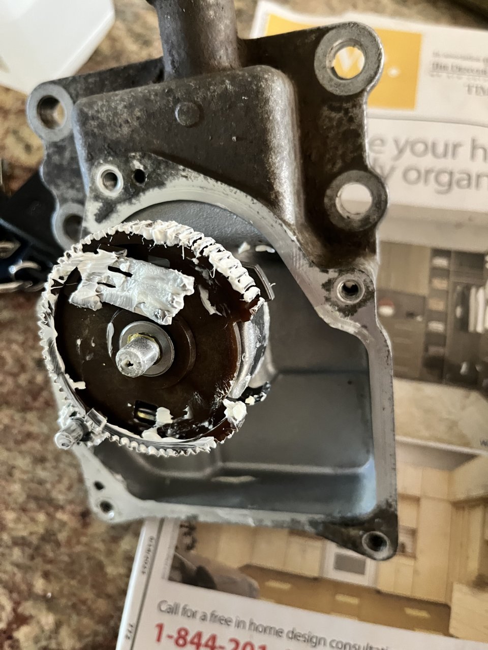

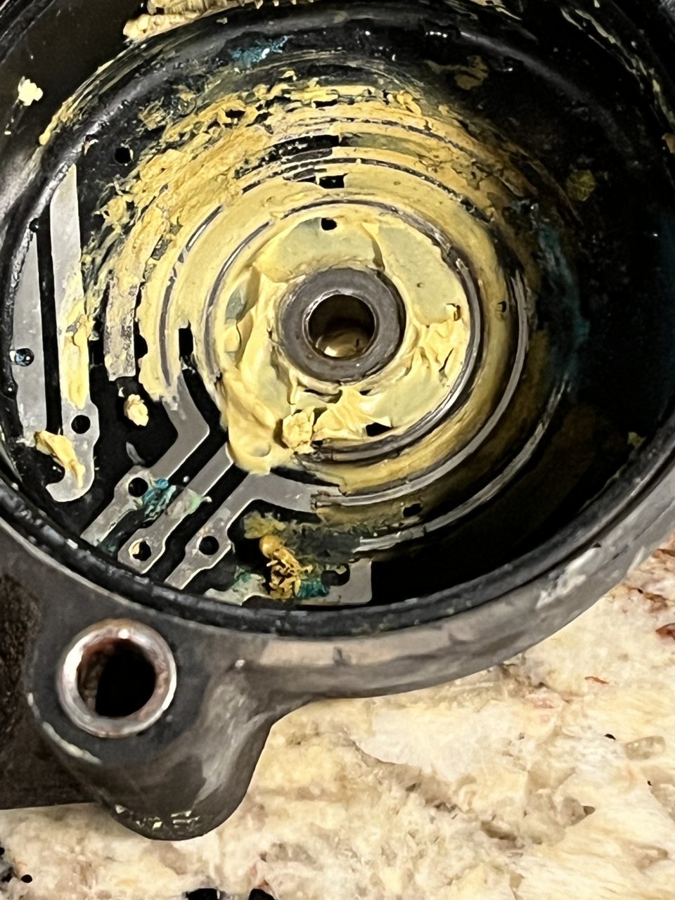

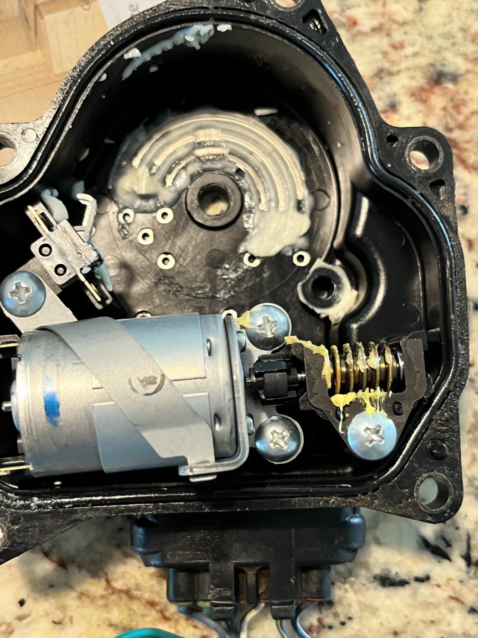

    Ill right i didnt want to leave ya guys hanging..
    I took apart front diff ADD bench tested solder it, it was clean to begin with and no obvious problems.
    Welp that wasnt the problem..
    To be honest testing those tiny wires freaked me out.
    So i decided to check transfer case actuator
    BINGO!!
    Water inside and corroded electrical.
    Frayed breather hose.
    Clocked it backed to 2wheel.
    Cleaned electrical with green pad and alcohol.
    Greased it up with dialectic on electrical and white lithium on gears.
    Thanks again for your help.
    Im so happy im up and running!!
    This thread was my answer!!
    IMG_0313.jpg IMG_0316.jpg Corroded and full of water transfer case actuatorIMG_0325.jpg

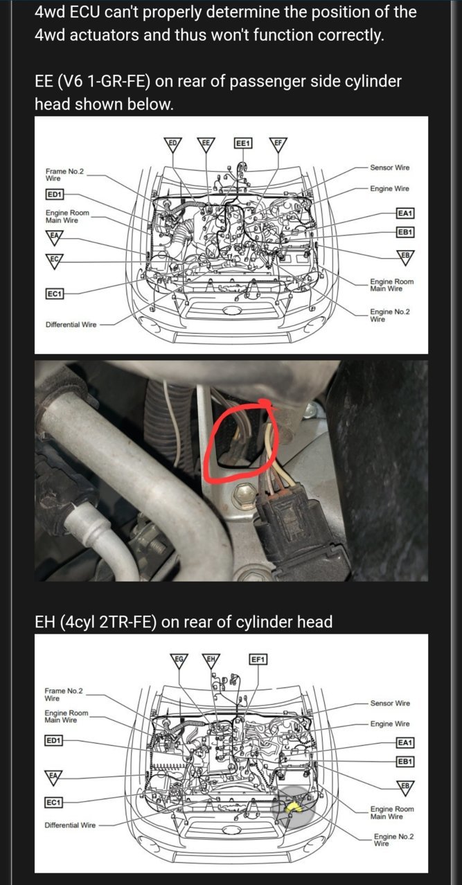

    This thread is amazing. Want to check for ground on engine (EE) but having trouble locating it. Anyone have clear picture of it on block?

    I have it in the first post, it's on the rear of the passenger side cylinder head near the coil connector.
