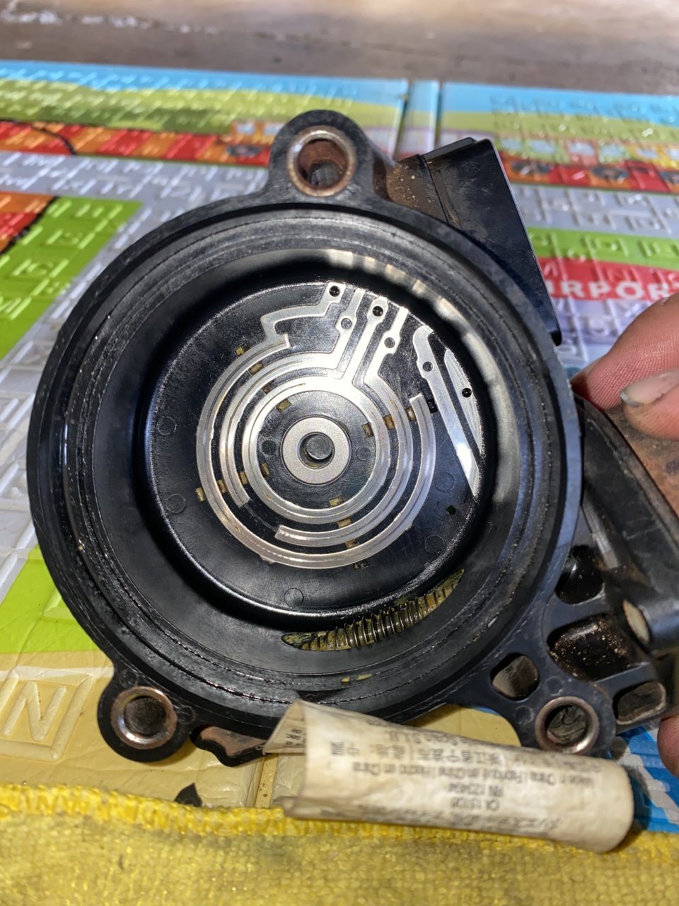

    Now. Truck won’t go into gear. Grinds gears when going back to PARK.

    Hmm it seems it stopped in between low and high, you might need to take it back off and turn the gear manually.

    You have to rotate the gear counterclockwise to shift the transfer case back to 2H

    When I start back up after turning gear counter clock wise. Do I start truck in 2H?

    :angrygirl:I also pinched and broke rubber o ring for actuated cover

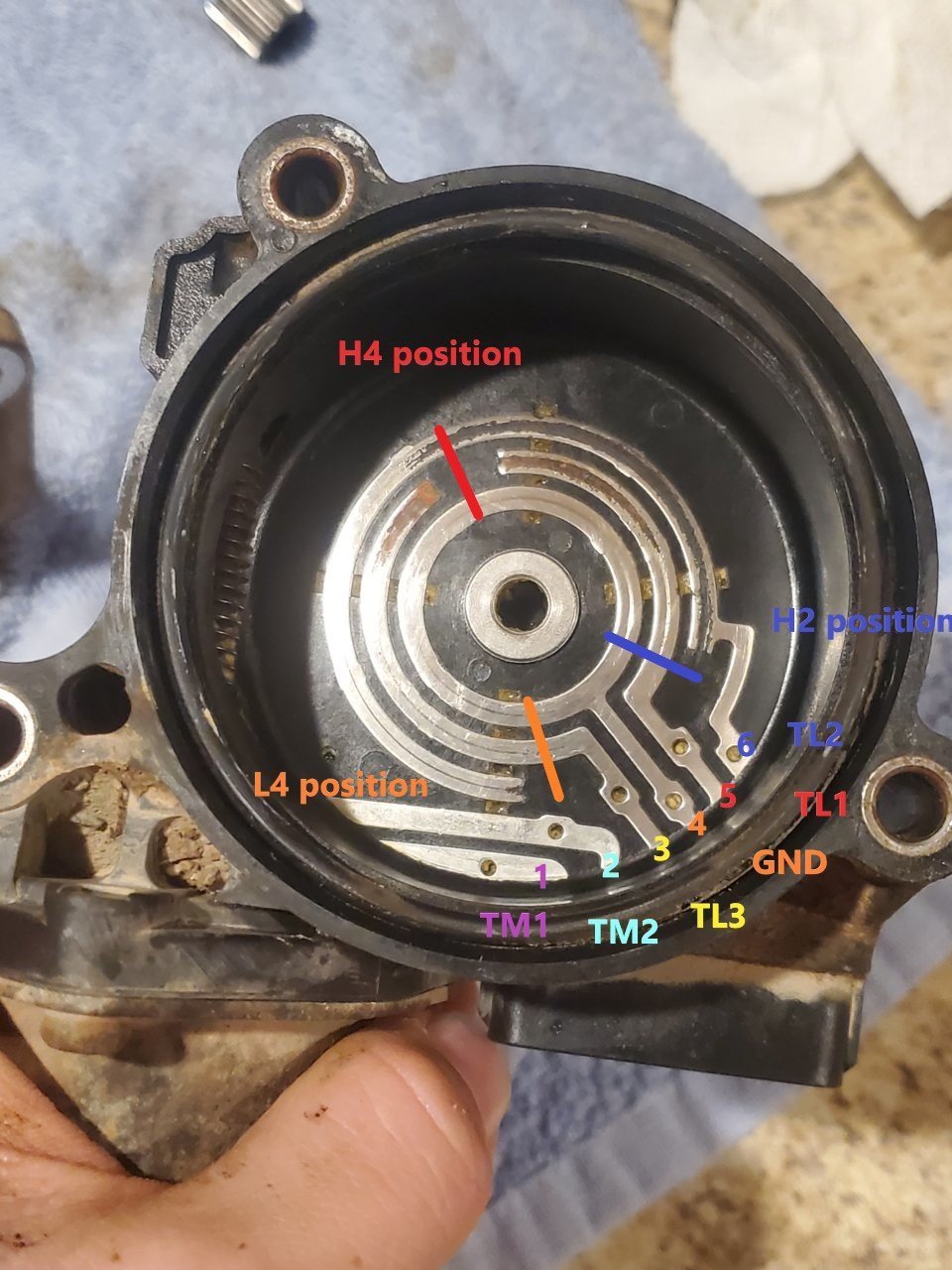

    Yes, fully clockwise and transfer case in 2H the contacts (circled in red) should be inline with the 2H position on the actuator.
