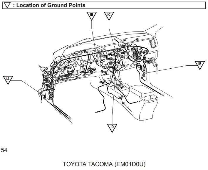

    I saw that, I'm concerned about the 1.7v on the ECU ground and the fact that the problems started after a clutch job. Trying to figure out how it could be related other than a pinched wire or damaged or improperly connected ground somewhere.

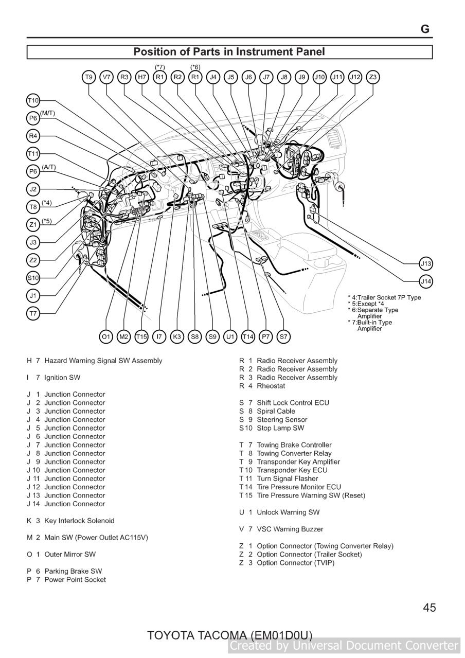

    That’s what I’m thinking too?

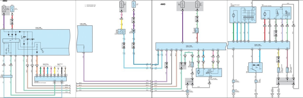

    I suppose there is a small possibility there is a problem at junction connectors J13 or J14.
    But it’s not likely. And I can’t seem to find the diagram where they are. I suppose it’s worth testing at those connections. But I doubt that where the issue is.

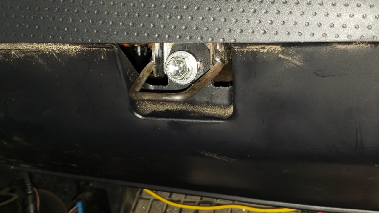

    I will check that kick panel ground I think something might be ran under it and compromised the 4x4.
    just checked it, it read .4 so I’m not worried about that ground. I didn’t have anything ran there like I thought I did

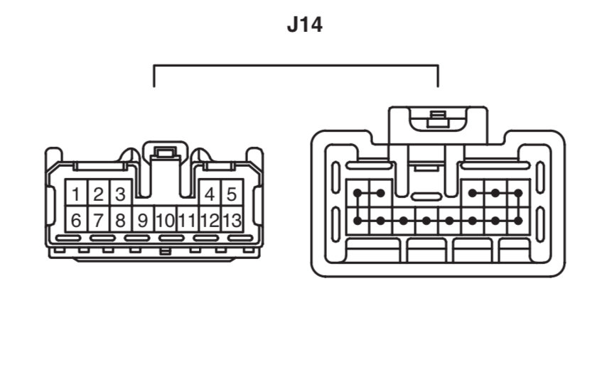

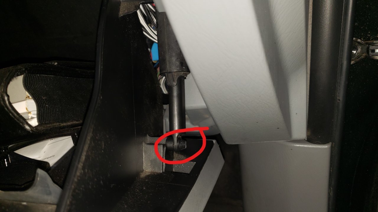

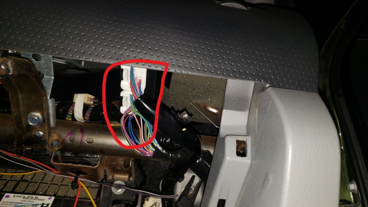

    Looks like they are behind the right kick panel as well.

    .4v measured on the ground wire at the ground?
    How are you checking it? If you are checking the wire with it still connected, I believe you are essentially doing a voltage drop test. Which means, there is voltage there? @Dm93

    Be nice if you could isolate the White/Black wire from IE ground.
    Then test it to battery negative.

    i just realized, it was .4ohms not volts at that ground, i did check and pulled no voltage there

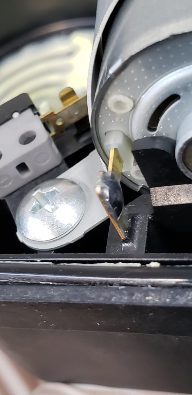

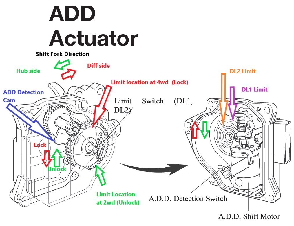

    And I'll add this to it..

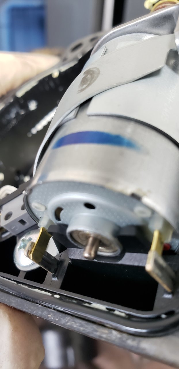

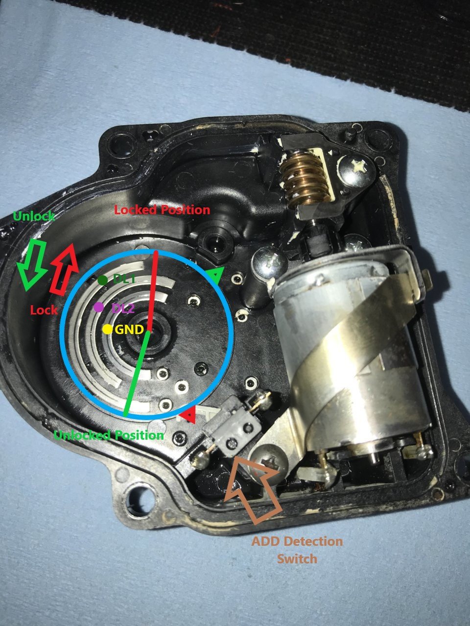

    Might as well add some solder to the two joints at the motor if when the cover is off, this often solves or prevents the corrosion problem that causes the common no 4WD engagement when commanded and the dreaded blinking light.

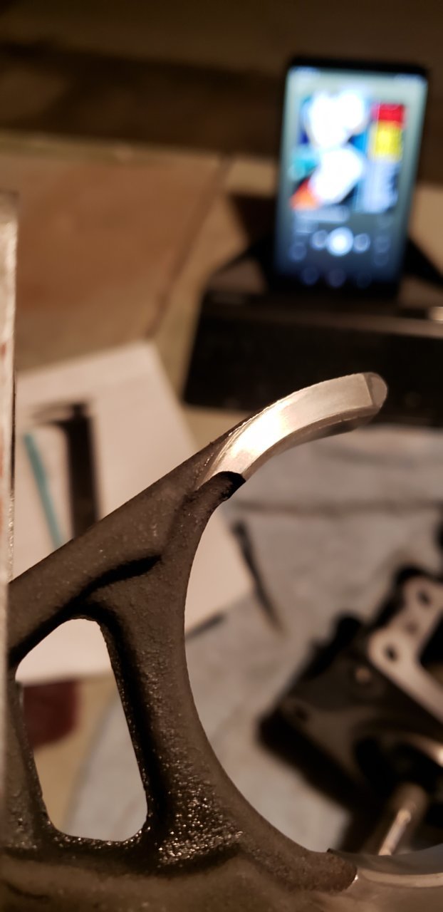

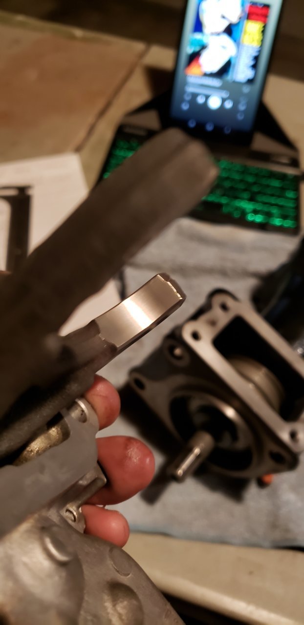

    And on a side note thta's related to 4WD System, I polished the ADD shift fork with fine sandpaper and some WD-40 to help a smoother engagement when I recently had everything a part.. which can be found here https://www.tacomaworld.com/threads/monkeyproofs-misadventures.697489/#post-24678936

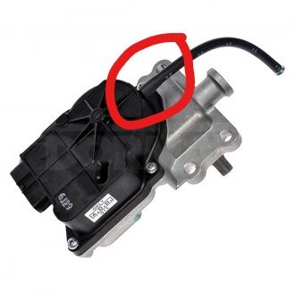

  15. Dec 12, 2021 at 7:16 PM

    What did you test? The wire or the bolt at IE?
    That is odd.
    You have a voltage of 1.7v on the Ground wire AT the 4WD ECU.
    I’d take another reading at the J14 connector pin 4. (Note that all the wires on J14 are joined when both connectors are plugged in)
    DM93 posted the J14 location a few post up.
