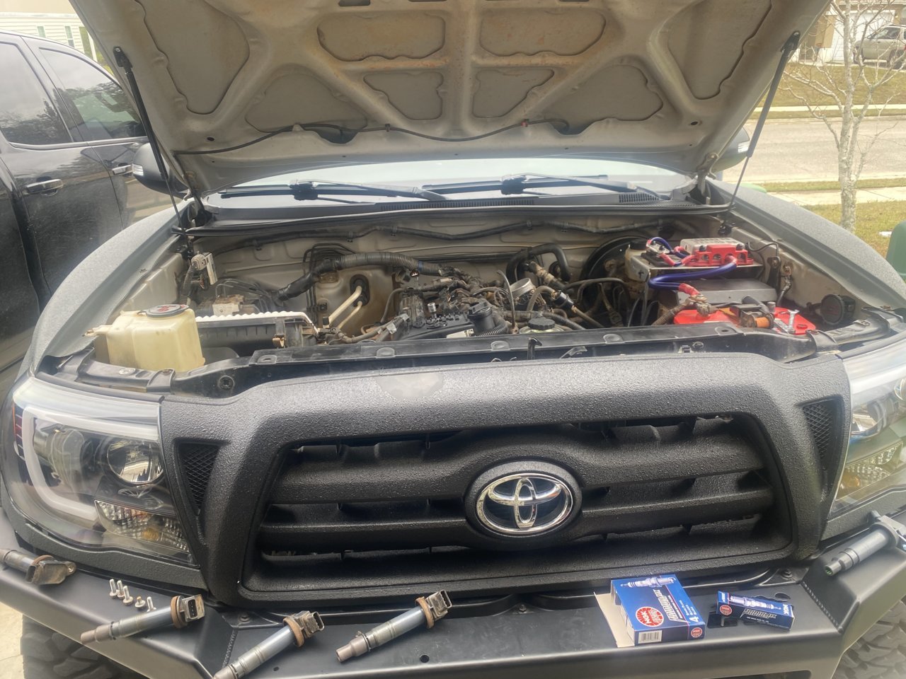

    0CF6DA06-FE6F-41CF-9F80-01B217790CC4.jpg Well… almost as if it was meant to happen. Engine started sputtering really bad under acceleration and then randomly kicking back to normal. Seems to be a real gremlin now, took the day off work so I can actually diagnose this pos

    I know it's been covered already, but I think you may need to revisit the grounds. A continuity check and wiggle of each circuit is recommended

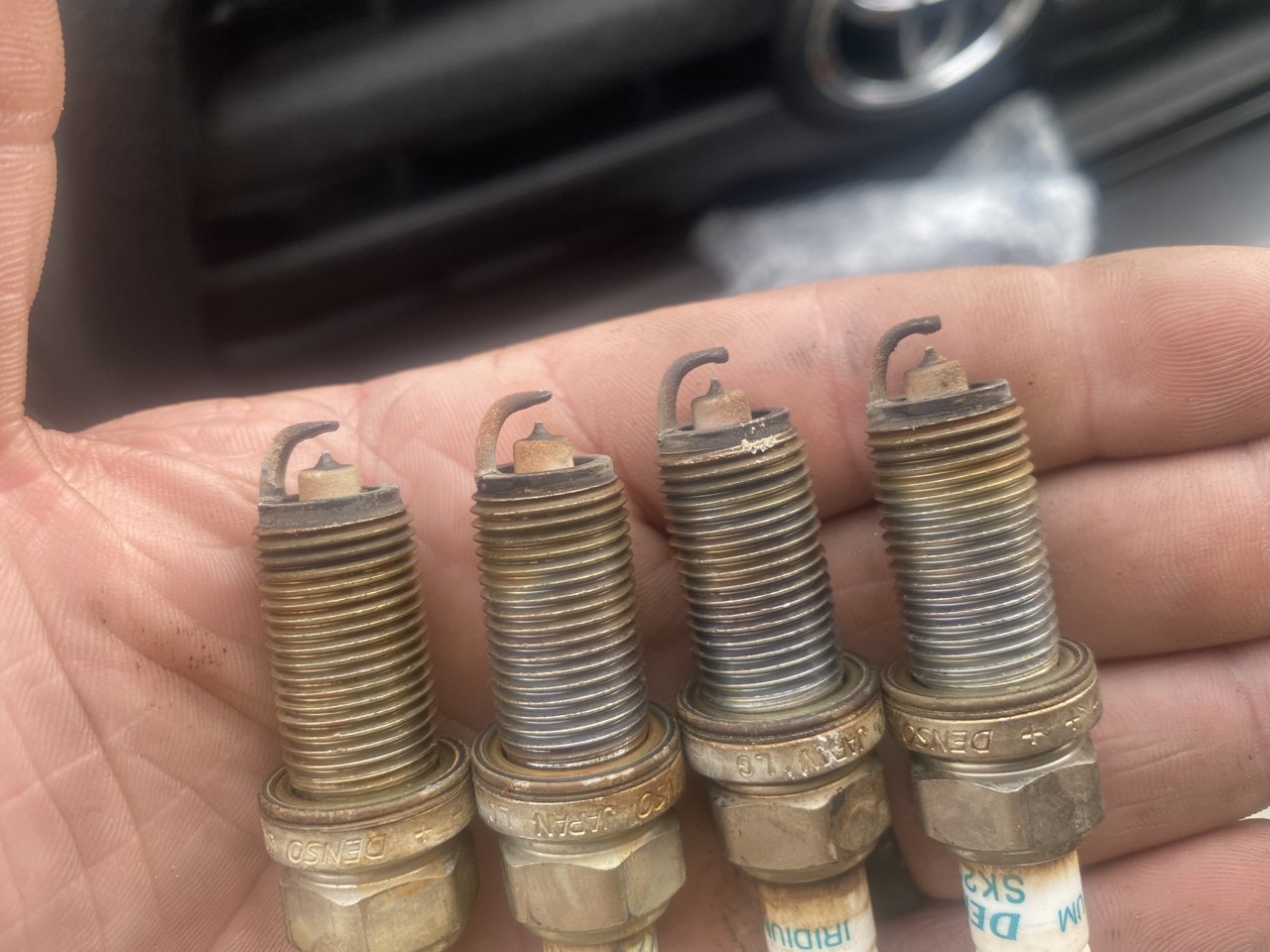

    10361180-EE8A-4EE8-93A6-FD97552B5CFA.jpg Well. I ain’t no mathematician but them suckers are lean af

    Wonder what the fuel trim numbers look like

    Lol motor is in some bad shape, so much blow by that the oil fill cap lifted off the valve cover. Further investigation required… 4x4 no longer a priority

    That sucks man. Sorry to hear.
    I’ve seen worse as far as Lean.
    But those ground electrodes are nearly gone. Just changing the plugs should show a vast improvement.
    Do you have a scan tool?
    I wonder what the fuel trims are doing?
    Also, with the amount of blow by you say you are having, you’d think there would a bit of a low compression issue as well.
    Do you have a compression tester?

    So…no idea what I did but I fixed the engine. I’ve never been under the valve cover before but every single bolt was hand tight, doesn’t explain the way it was running but I pulled every sensor on the intake and replaced it, also new ngk plugs and denso coils initially it didn’t make a difference but I just drove around the block and shes running better then ever, however blow by is still present but far less than it was

    Those plugs look pretty normal color for a modern engine aside from being worn out.

    Im just surprised they are so badly worn, I did those 35k miles ago
