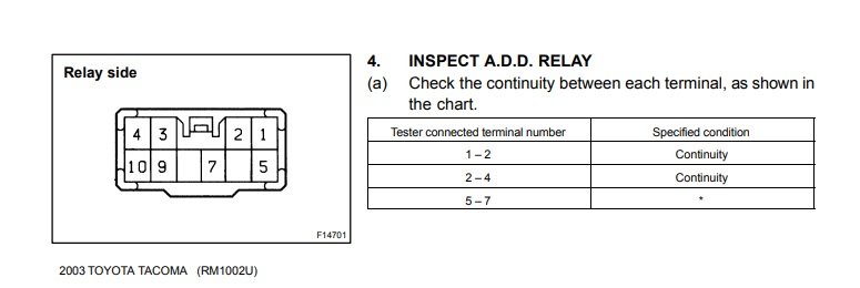

    2003 4WD 5SP Supercharged Taco Shitrunner
    whole thing modded out to be a Prerunner
    I did the resistance test on the harness and it all seemed right. I tried putting the harness onto new ADD and shifting when truck was in accessory mode to see if it would engage the ADD but nothing happened. Does the truck have to be running for the ADD to get power? My truck is on jack stands RN without front tires so I’m apprehensive to start it up and try shifting it into 4L to test run to make sure new ADD actually moves.
    in theory I could hit the clutch start button, have the 5sp in neutral, and shift around between the gears with the 4wd shifter to test new ADD before reinstalling it ? I’m cautious the truck is gonna jump off the stands

    #150066
    13,813
    Texas
    2014 DC OR 6spd 4x4
    Predator tube steps, Ranch Hand grill guard, Magnaflow CatBack exhaust, Toyota tool box & bed mat, 2LO Module by @Up2NoGood, Rearview Compass/Temp Mirror, Tune by @JustDSM.
    I'm pretty sure the ADD should shift with the key on if everything is working correctly even if it's not attached to the axle, I know the 2nd gens will.
    Gahhhhh I’m wondering wtf could be the issue if it isn’t the ADD unit itself then D: that only leaves the harness potentially or maybe the transmission relay I suppose. What else am I missing that could be the issue ? I saw some curosion on the frame it looks like from battery acid I’m going to do a closer inspection and try to follow the harness wiring as far as I can to make sure the wire isn’t currupted somewhere. About to reinstall the ADD rn and do the gasket maker

    2014 DC OR 6spd 4x4
    Did you verify the switch on the transfer case is working and connected?
