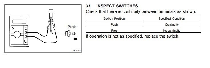

    It's going to be the switch on the transfer case with the Black/Yellow & White/Black wires going to it, that's what tells the relay that it's in 4wd so it locks the ADD.

    The switch should be closed when the button is pushed in and open when it is released.

    No I meant the button on the end of the switch that screws into the transfer case.

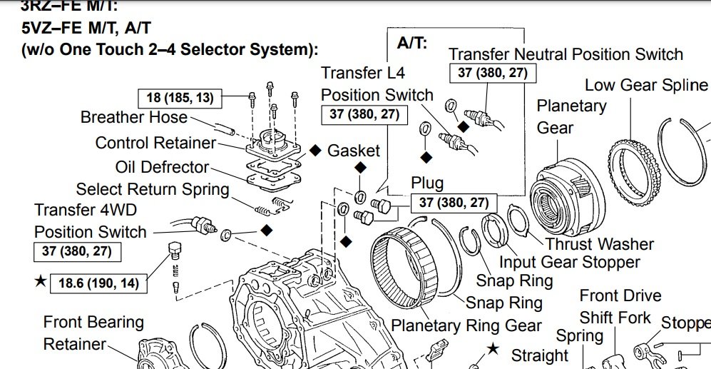

    The neutral, low range, and 4wd detection switches are still on the transfer case to tell the PCM, ADD relay, and indicator lights what position the transfer case is in.
    The button your referring to is the 4wd select button, that system adds an electronic actuator to the transfer case that shifts it into and out of 4wd in addition the the ADD actuator.

    This is the best I can come up with, looks like it's on the top passenger side of the transfer case.

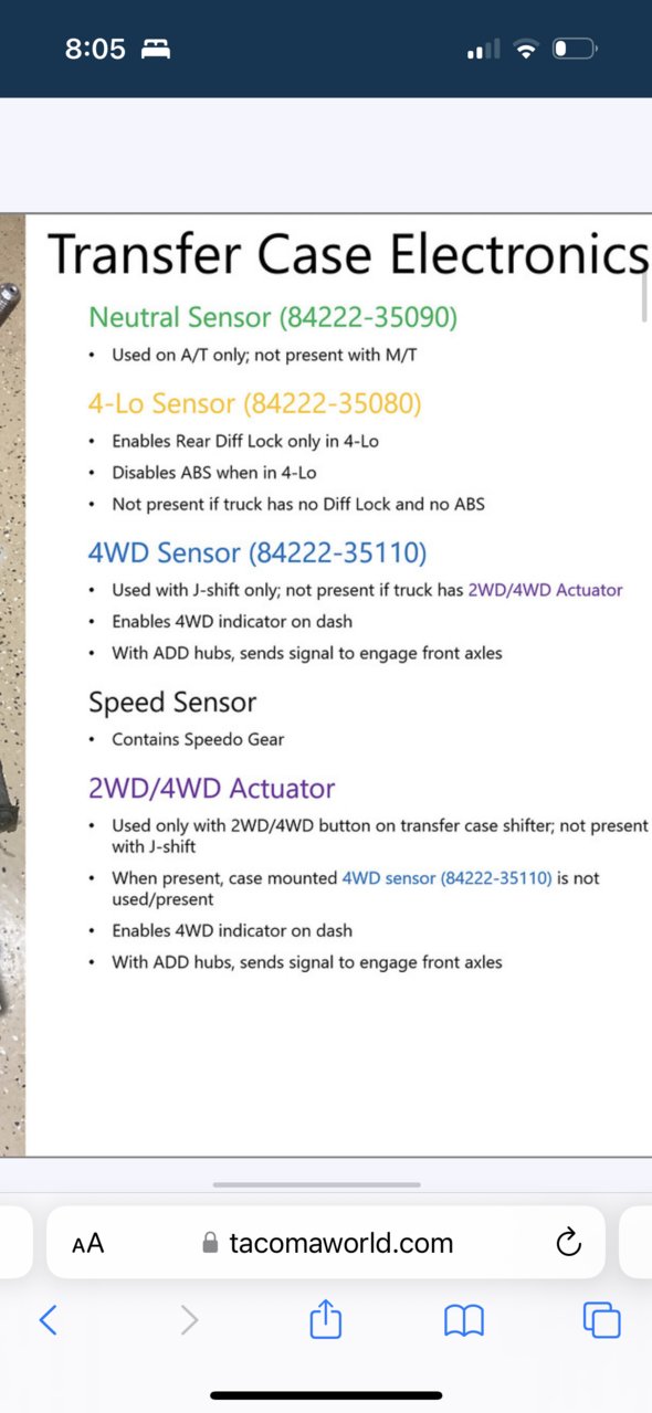

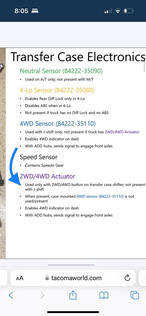

    Do you have a J-shifter?

    it's the 4WD sensor (84222-35110)
    "Actuator" in this instance is the "button" on the non-J-shift versions
    dumb terminology IMO
