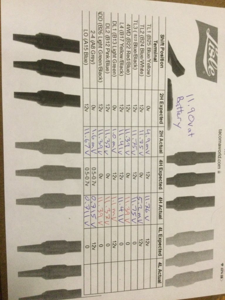

    A4673FAA-56D6-41A3-AE83-8C576FB5DC51.jpg I did those tests about the 4x4 voltages. There are 4 not showing normal readings. I attached a photo of the expected & actual voltages.

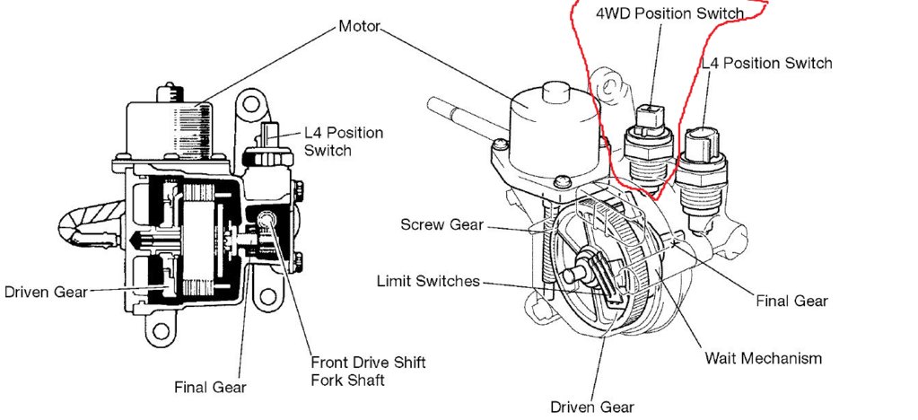

    Looks like a bad 4wd position switch on the back of the Transfer Case Actuator, we can verify this by unplugging it and jumping the terminals with a small paperclip then verifying 4WD (B22) goes to 0v.

    Yes one is the sense wire (Red/Blue) and the other is ground (White/Black), just jump across them and verify it goes to 0v at the 4wd ECU. That will verify our circuit integrity.
    Also need to verify with the switch in 4wd that the front driveshaft is locked in.
