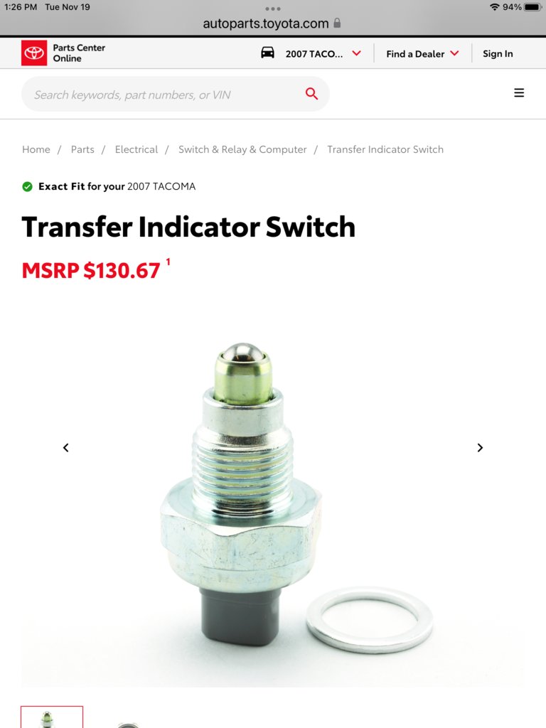

    I checked the driveshaft after jumping the Transfer 4x4 indicator switch. It does lock in! I’m guessing it I pull that switch & test it for resitance it will fail. Not totally sure about that. Replacing the switch should get me back to 100% I hope. The Toyota OEM Switch is $130. Any idea if there’s a cheaper aftermarket part that is reliable?156FE70B-530E-4D72-8A56-43CDB1688D27.png

    Standard Motor Products makes one but it's still $87.
    https://www.rockauto.com/en/moreinfo.php?pk=13958525&cc=1434686&pt=4412&jsn=935
