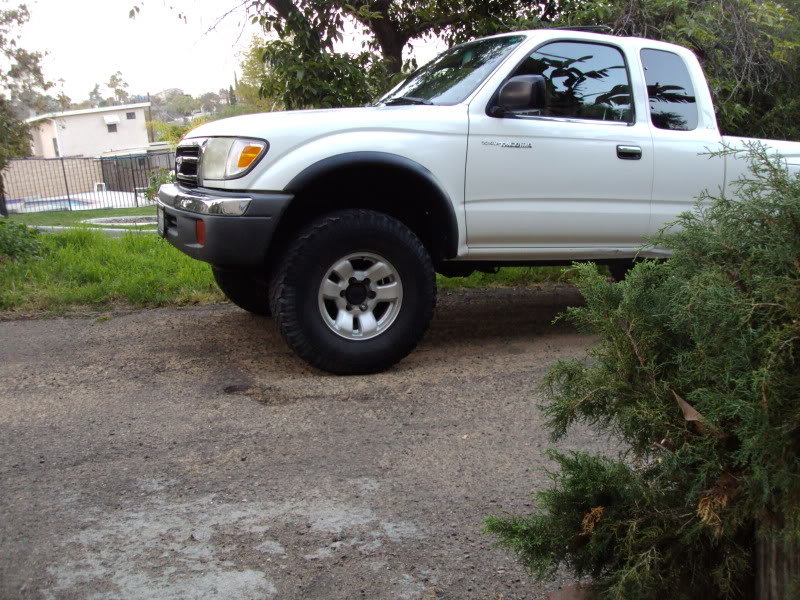

    Ahemm, ok moving on, yes Magikbean the Tundra 5100's are a straight up bolt on affair & I'm on the 3rd groove up with 2 to go if necessary.. They're awesome. Since you are here we'll address the painting of the rims which of course I got the idea from you....:D
    I'll get some better pics up soon

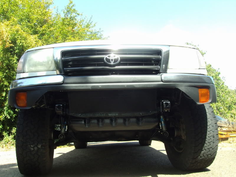

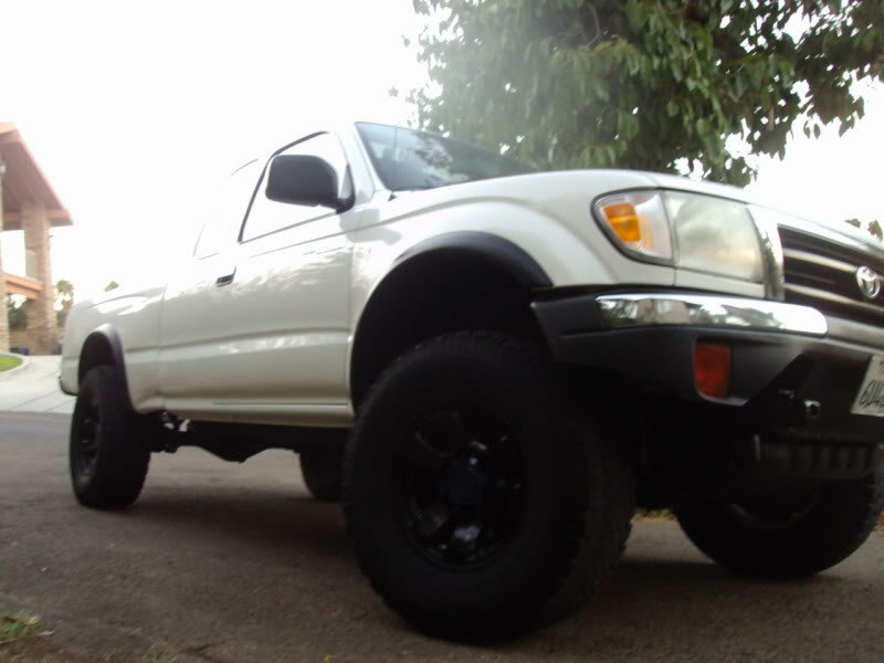

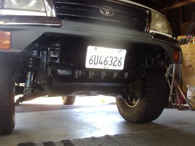

    Thanks CMACK a little different than last night huh, nothing like flaming yourself , was gonna put myself on the wall of shame..haha:D :facepalm::facepalm:

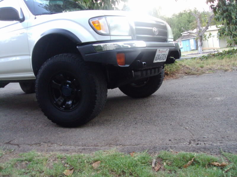

    Ok onward, now alot of you have heard/seen my OCD regarding the front bumper, now there is a true bumper in the works if my buddy & myself can get our shit together enough pull it off (& we will eventually) until then I couldn't stand looking at it so I took it off a 3rd time & armed with a pair of left/right angle tin snips, combo square ,black sharpie ( & no its not a term for a quick witted black guy) & tape measure & started trimming away the fat.
    But ya can't just hack out the middle like I did & leave the radiator vulnerable so I found a nice piece of steel mesh & a few tek tipped screws later fabbed a little armor for it & trust me it is rigid. it is tuff & passes alot of air to the radiator & alot more rigid than the OEM crap hanging off the front.....

    The one now? or the finished product ? theres a couple in the works..:D
    I don't think it looks too bad, like I've said its not good, not bad, just different but I like it so far
    Probably going to go with a pre runner type tube hoop with a light bar, I dunno just kickin' it around

    This was my "1 hour" bumper MOD, (cause it took about an hour to make)
    It's actually piece of metal steel stud like you'd use in commercial wall construction, notice I relocated the turn signals ...:D

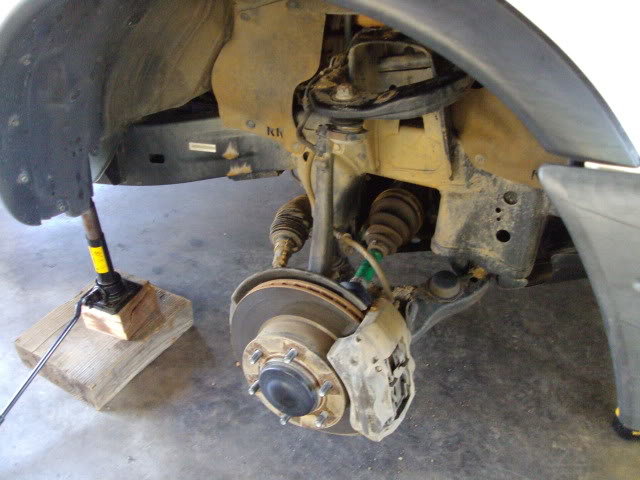

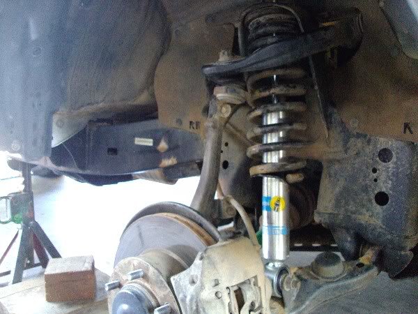

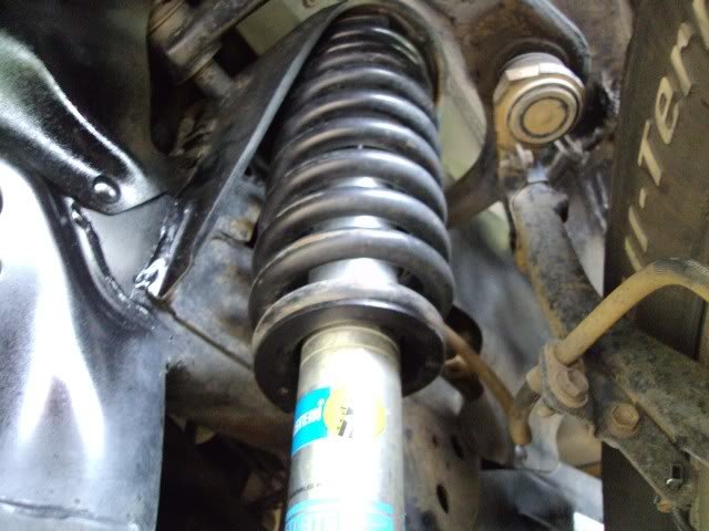

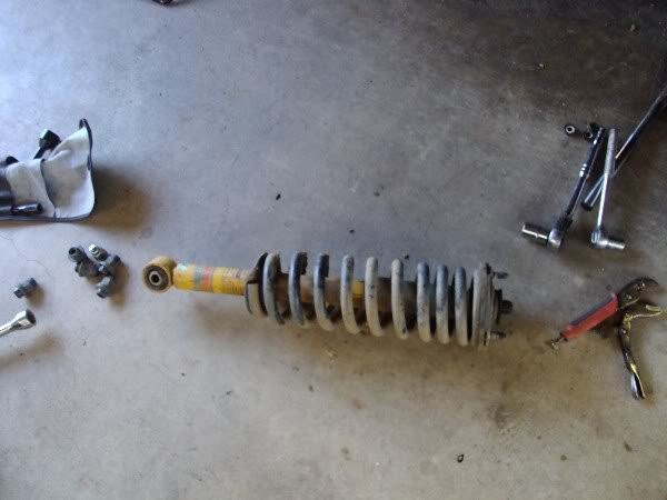

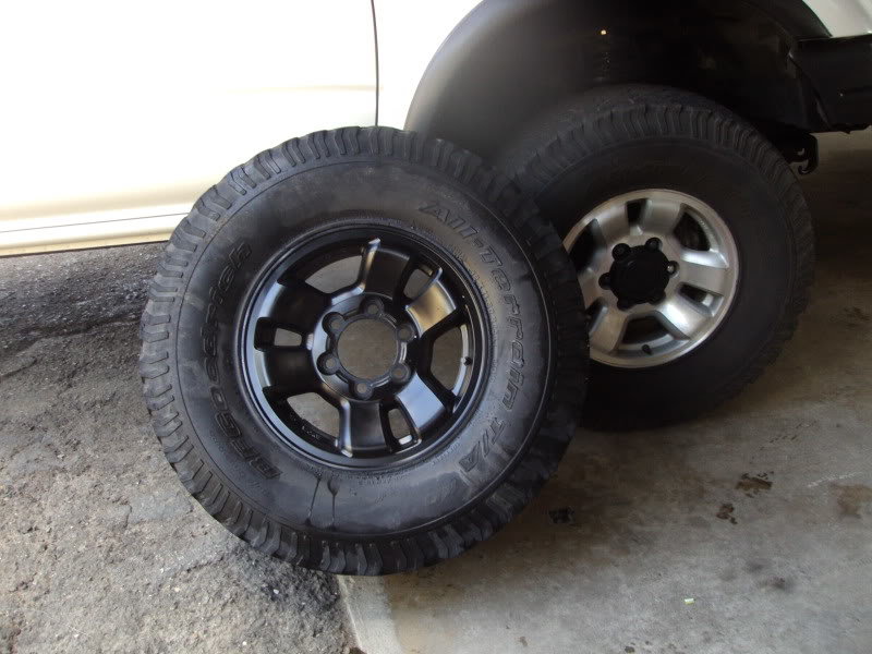

    Now I know evryone & their brother just about have the adjustable 3 setting Billies, this is where I again step out of the norm, I opted for the adjustable 5100 series 1st gen. TUNDRA Bilsteins....
    Why?:
    Heavier duty/dampening (good compensation for heavier aftermarket bumpers)
    & the biggest single feature: 5 SETTINGS !!! Thats right 5 instead of 3 !!
    I love them, no bottoming/topping out, ruts & bumps I had to brace for before I don't hardly feel anymore & by all accounts I have the only 1st gen Tacoma with Tundra shocks in this entire forum.....one of a kind, I like that.....
    My buddy Jay below (another old fugger) great wrench/machinist
    getting the first side together
    Towering coil after
    finishing up
    Have a small amount of rake (just did the fronts)

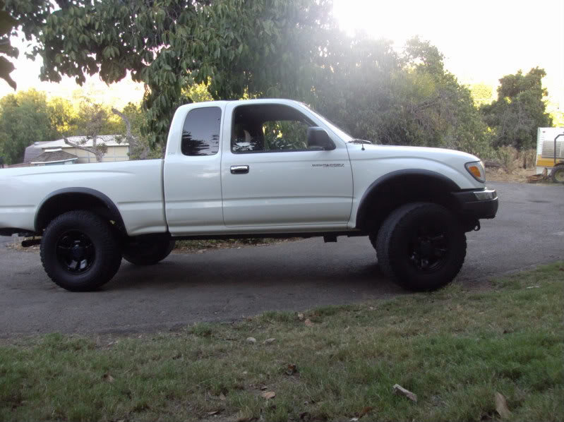

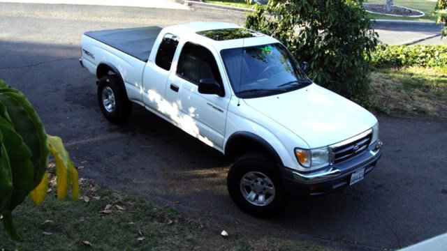

    Trucks awesome! Just the way a Tacoma should look imo, and pretty cool how you used tundra billy's on, one of a kind for sure. Great job doug

    Hey Conner how ya doin' buddy ? Yeah they are dimentionally the same as the bolt on 5100's for Tacomas, no MODDING of anything to install & I'm on stock coils, the ride is firmer not harsh to me anyway & get some Billies ASAP !! I'll have some front bumper pics soon too (since you & I hate the stock one haha:D)
