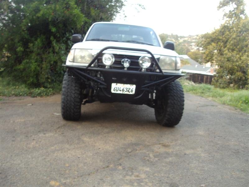

  17. Apr 3, 2013 at 11:57 AM
    #417
    4WD
    4WD [OP] cRaZy oLdmAn
    Jul 2, 2009
    #19185
    23,542
    Doug
    Lakeside, Ca / Gardnerville, Nevada
    2004 DC TRD 4x
    Grey wire MOD, deck plate, diff breather MOD, 2nd gen. OME 883# on Tundra 5100's, OMD custom 3" leafsprings, rear shock relocation, Ivan Stewart TRD rims w/285/75/16's, '02 bumper MOD, Famous Fabrications sliders , LED interior/exterior lights, bed bar, Custom tube bumper, Old school KC day lighters,Red Ring 8" HID flood, Kenwood vhf 2M.. umm some other shit I'm forgetting right now
    Thanks dude ...:)
    Just put a tube bumper up front.... member Taco_me_elmo designed it & now I have it...decent design too I like it..
  18. Apr 3, 2013 at 12:03 PM
    #418
    Trigo
    Trigo Because fuck you that's why...
    Dec 21, 2011
    #69160
    7,055
    Rodrigo
    San Diego
    1st gen
    Looks good Doug! :thumbsup: I originally wanted to buy Micah's bumper but I didn't because I wasn't sure how it would look on the 2000 front end, now I wish I would have bought it :( lol
  19. Apr 3, 2013 at 1:03 PM
    #419
    4WD
    Jul 2, 2009
    #19185
    23,542
    Doug
    2004 DC TRD 4x
    Haha, thanks buddy & yeah its starting to grow on me, plus theres 5 light tabs too !! :)
    I'm thinking about filling in some of the open spots to close it up some, it'll be a cross between a plate/tube bumper hybrid
  20. Apr 3, 2013 at 1:09 PM
    #420
    Trigo
    Dec 21, 2011
    #69160
    7,055
    Rodrigo
    San Diego
    1st gen
    :popcorn:
    My bumper has 8 light tabs ;) none of which are in use since I custom made a mount for my LED bar :eek: You planning on adding some more lights to it?
