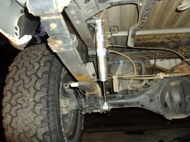

    Damn bro', now you got me re thinking shit,lol:D. I do know that 1st gens. have irregular shock lengths in the rear the shorter shock for the drivers side rear & the longer one for the pass. side rear heres the part no.# I have for the rear : BE5-D560-T0 (pass. side rear)
    BE5-D559-T0 (drivers side rear)

    I just opened my box of my new rear 5100s and your ID numbers match mine so im assuming that you have 5100s as well in the rear.

    Yeppers, I put them on a few weeks ago , so now I'm covered on all corners, I love'm ... so will you :D

    Hell, I just installed them the same way my stock billies were, it doesn't make a rats ass diff. as to how they perform either tube "up" or "down"..

    My buddy gave me the most convincing reason for turning my rear 5100's right side up (??) He said "less unsprung weight on the axle" As nutty as I thought this sounded, technically speaking, he's right, so I flipped them & Sunday going to see what ,if any difference it makes...:D

    :D well if ya think about it, the shock body is heavier than the shock tube, but they are both affixed directly to vehicle, but then again you come back to the weight of the shock body not being directly bolted to the axle but after offroading Sunday I didn't notice a nickles difference in performance.....

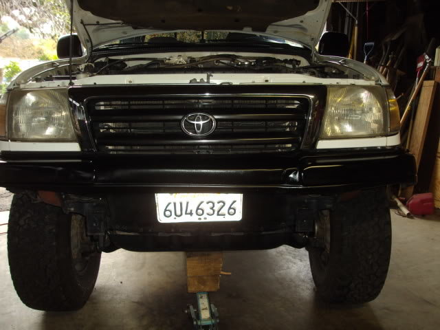

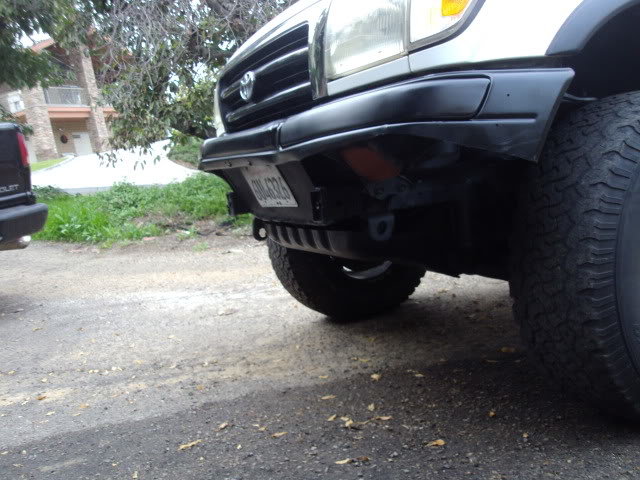

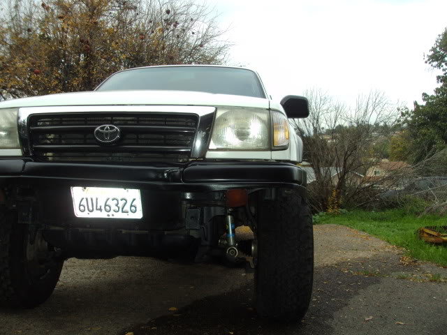

    Threw a little paint on the 2 chrome strips left on whats remaining of the front bumper, ehh I dunno, just kickin' it around..... Think I'll relocate turn signals today, we'll see what transpires....:eek:

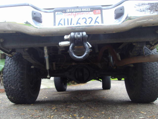

    Threw on a Clevis hook for recovering (Thanks for the receiver Matt Lemboski !!):D
