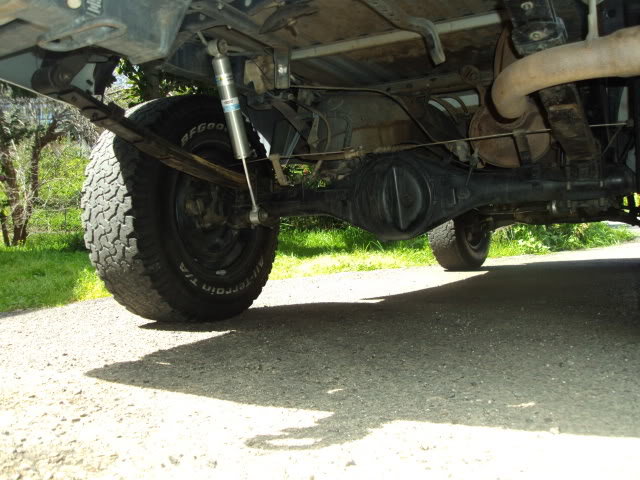

    Ok, today is the day I'm going to rebuild my rear leaf pack, keeping my main leaf & building off it with FORD springs (huh? go figure )pics up later, I've been told by a few that it won't work, HAA, absolute BS it won't work solving my lift & soft springs... pics later

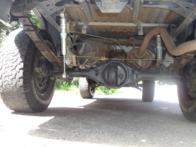

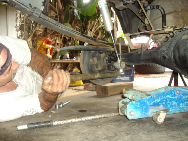

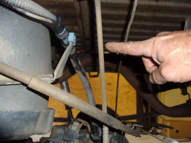

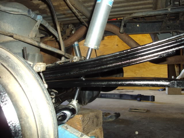

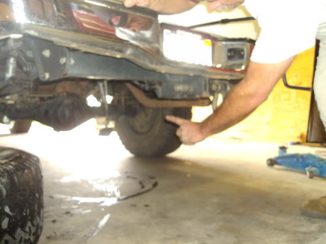

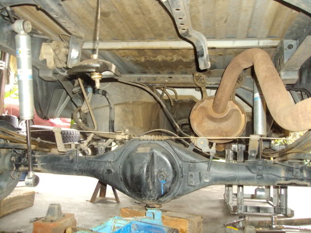

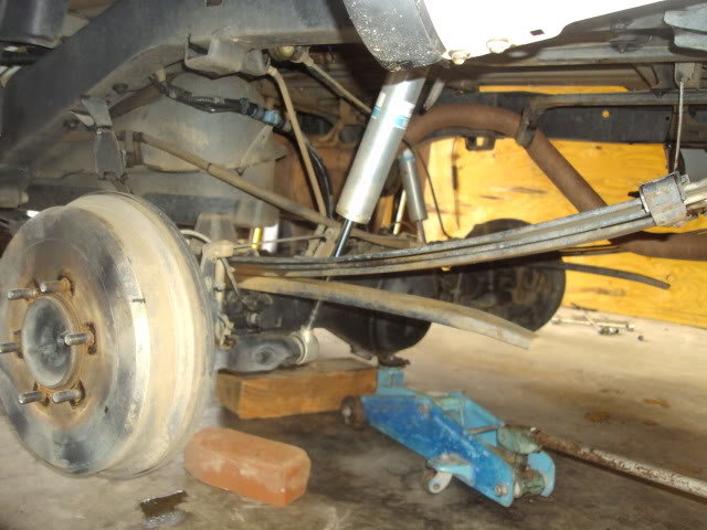

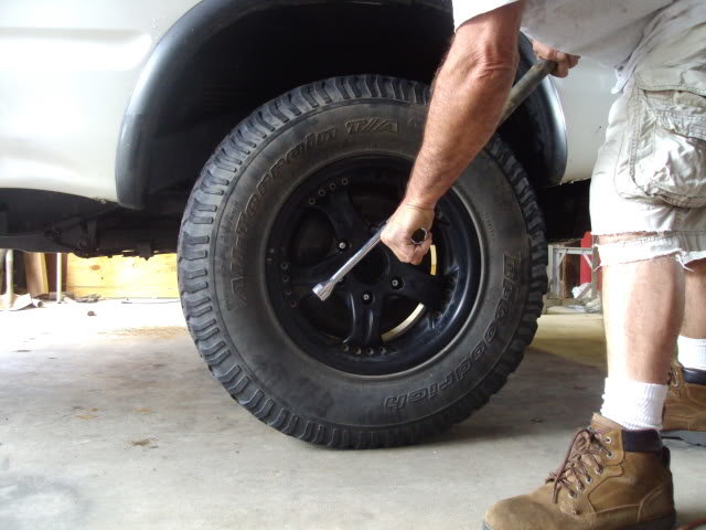

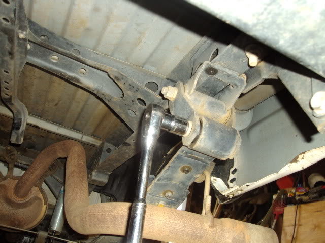

    Here is the first of many, break lugs loose before lifting..
    Drop your spare also, you'll need to....
    You need to support the truck (jack stands) & the axle (floor jack)
    You'll want to disconnect the brake line & loose the bottom of rear shocks....
    A cheater bar helps a ton with breaking the U bolt nuts loose....
    Undo both nuts on shackle to remove....

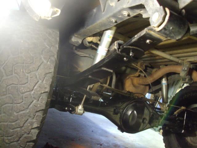

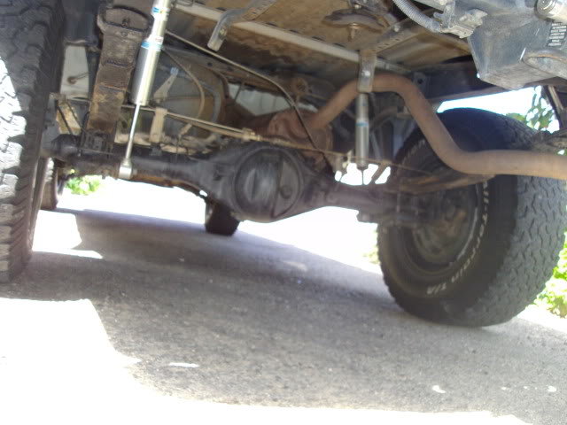

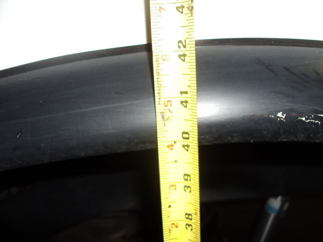

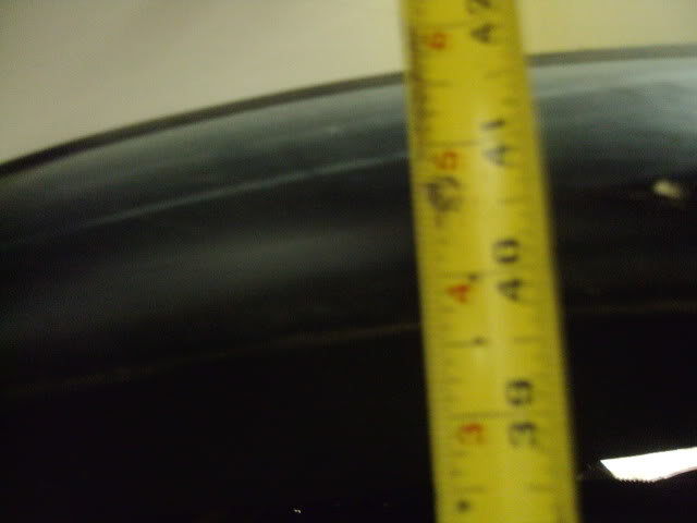

    I rebuilt my springs today, bringing them back to life with the addition of 2 leafs off a Ford & gotta say, didn't expect the lift I got, a solid 3" !!!! I now drive a stink bug .....:eek::eek::facepalm::facepalm:

    I havent really got one yet Ryan prolly tomorrow but I'm thinking its closer to 3.5" seeing how my 5100's are already set at max & now the rear dwarfs the front, feels like I'm driving down hill....:eek::eek:

    My home built junkyard springs are a success !!

    I expected the springs to come back to life & maybe an inch/inch & a half of lift....
    What I got was 3".... & I'm loving it !!

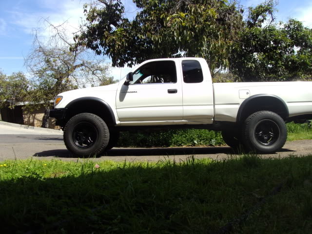

  19. Mar 15, 2011 at 12:55 PM
    #139
    4WD
    4WD [OP] cRaZy oLdmAn
    Jul 2, 2009
    #19185
    23,530
    Doug
    Lakeside, Ca / Gardnerville, Nevada
    2004 DC TRD 4x
    Grey wire MOD, deck plate, diff breather MOD, 2nd gen. OME 883# on Tundra 5100's, OMD custom 3" leafsprings, rear shock relocation, Ivan Stewart TRD rims w/285/75/16's, '02 bumper MOD, Famous Fabrications sliders , LED interior/exterior lights, bed bar, Custom tube bumper, Old school KC day lighters,Red Ring 8" HID flood, Kenwood vhf 2M.. umm some other shit I'm forgetting right now

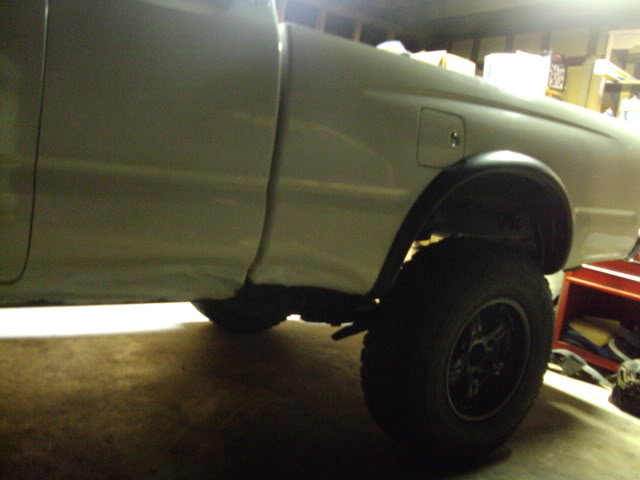

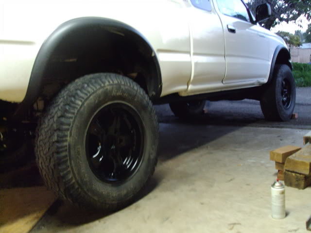

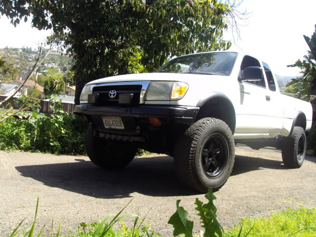

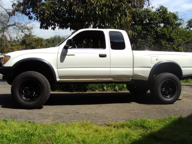

    Not great but a couple of you wanted to see stance after 3" leaf install.....
