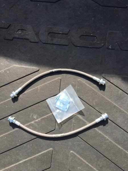

    I now have stainless extended front brake lines that will be installed soon.

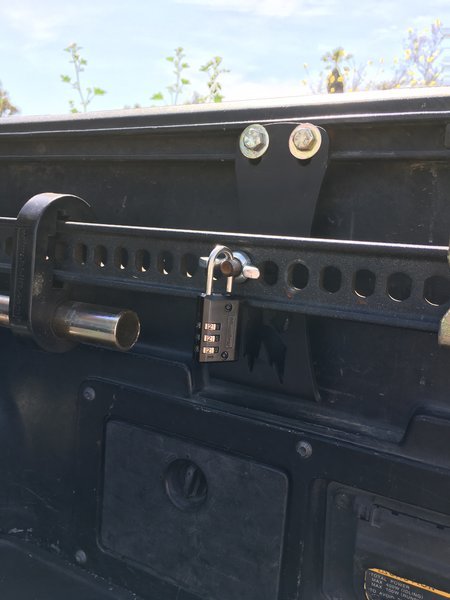

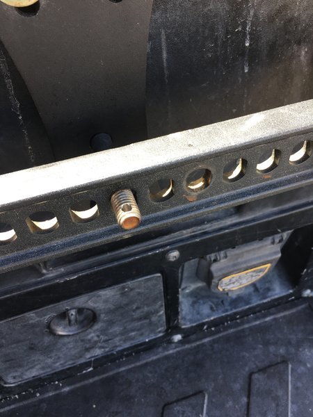

    Got holes drilled in my Relentless Hi-Lift mounts so I could lock it down.

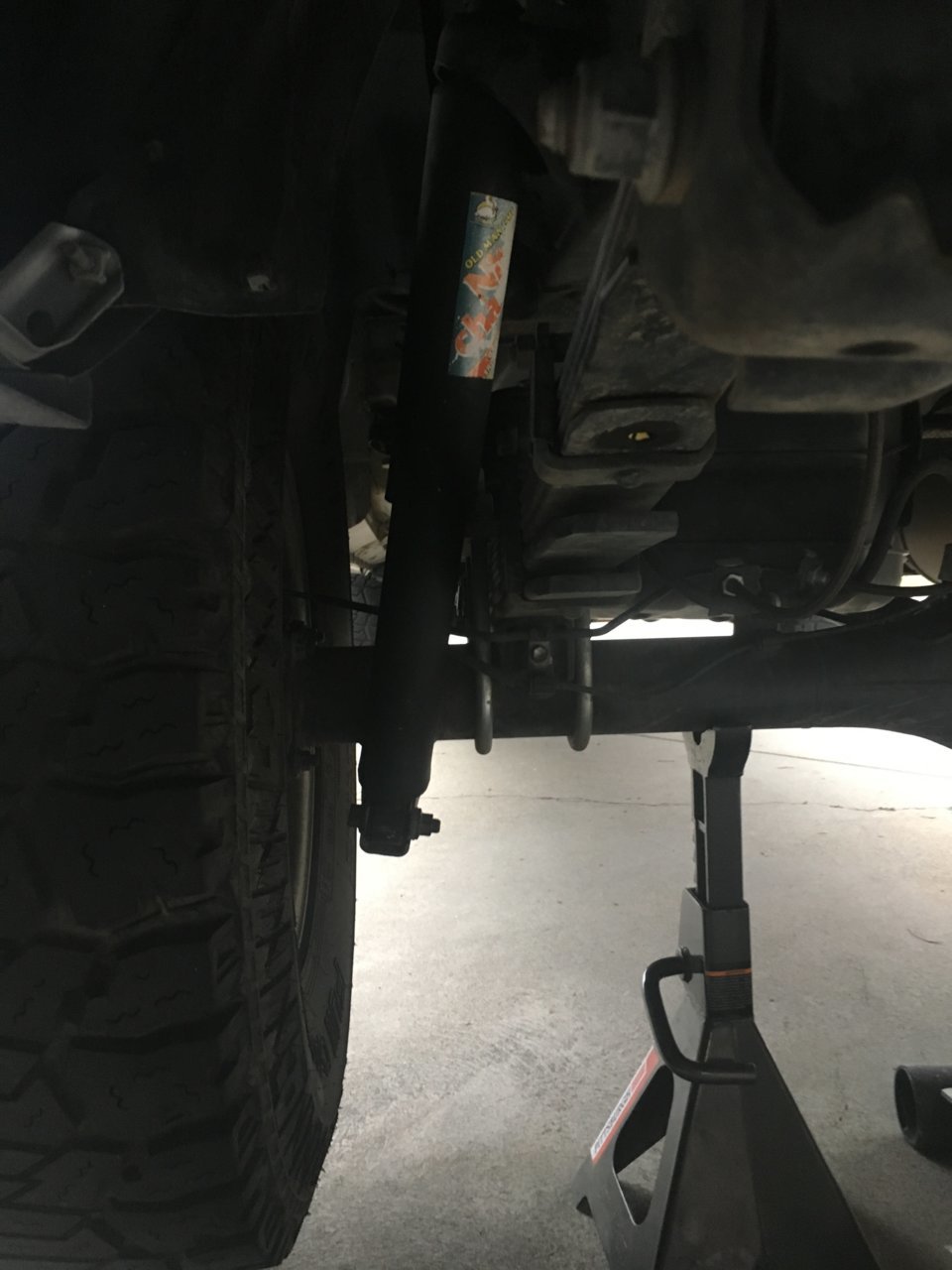

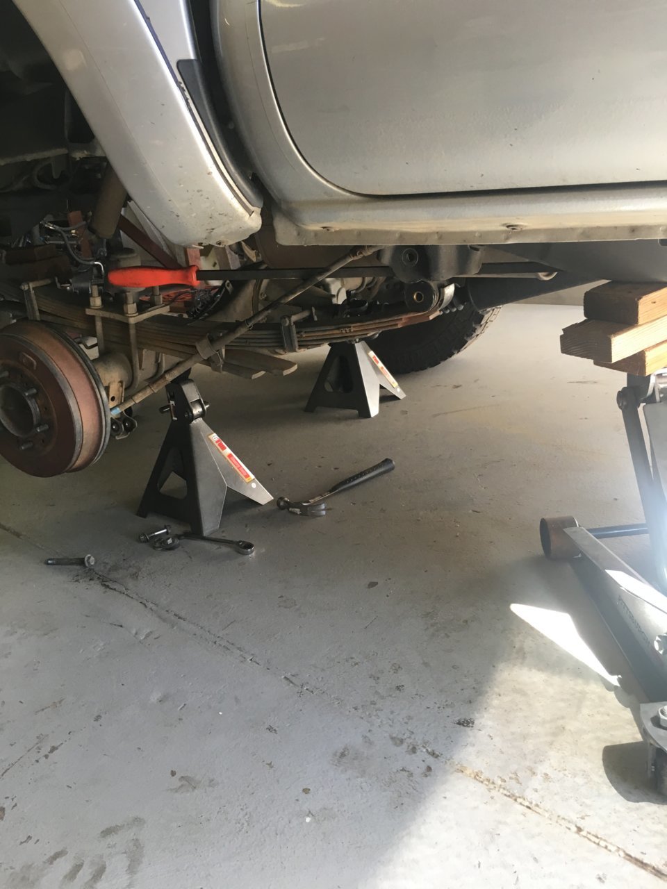

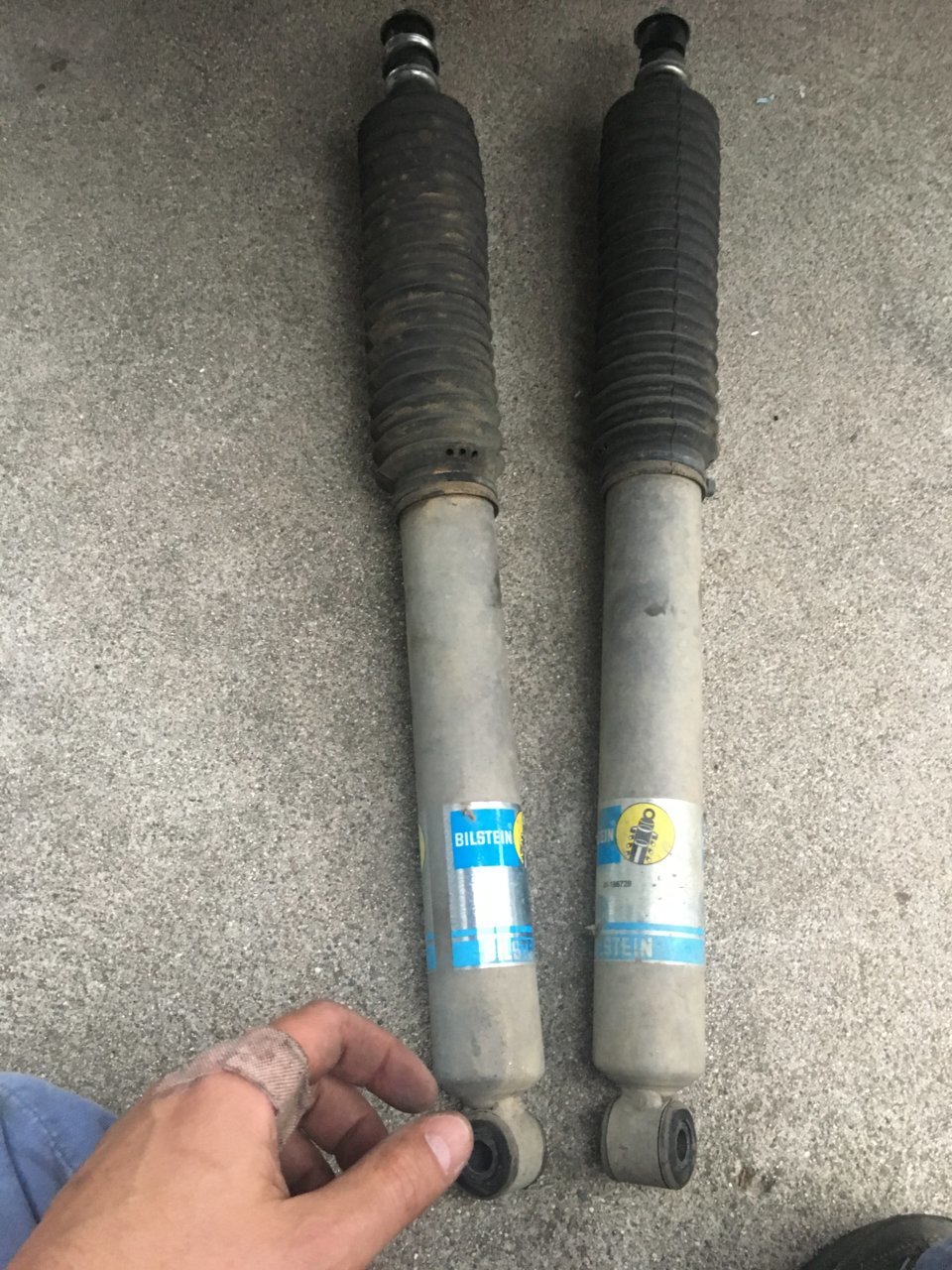

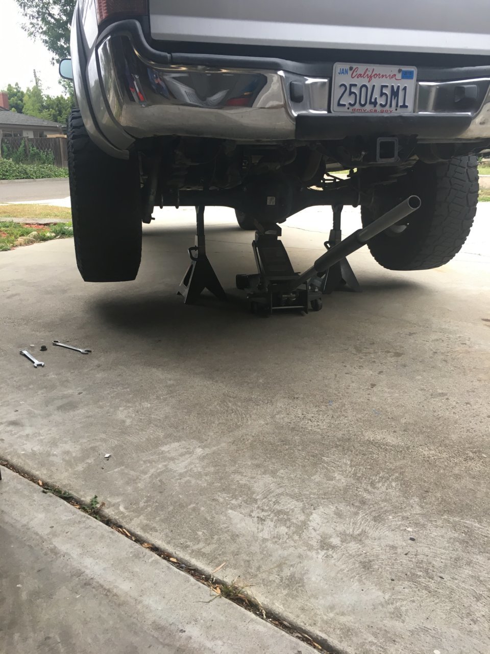

    I finally replaced the Bilstein 5100’s in the rear. I ended up putting in the OME Shocks that we’re given to me by a local TW Member for a 6pack of beer(thanks Mikey). I painted them black though...yellow didn’t work.
    This is a temp fix until I get my hands on some extended length shocks :D

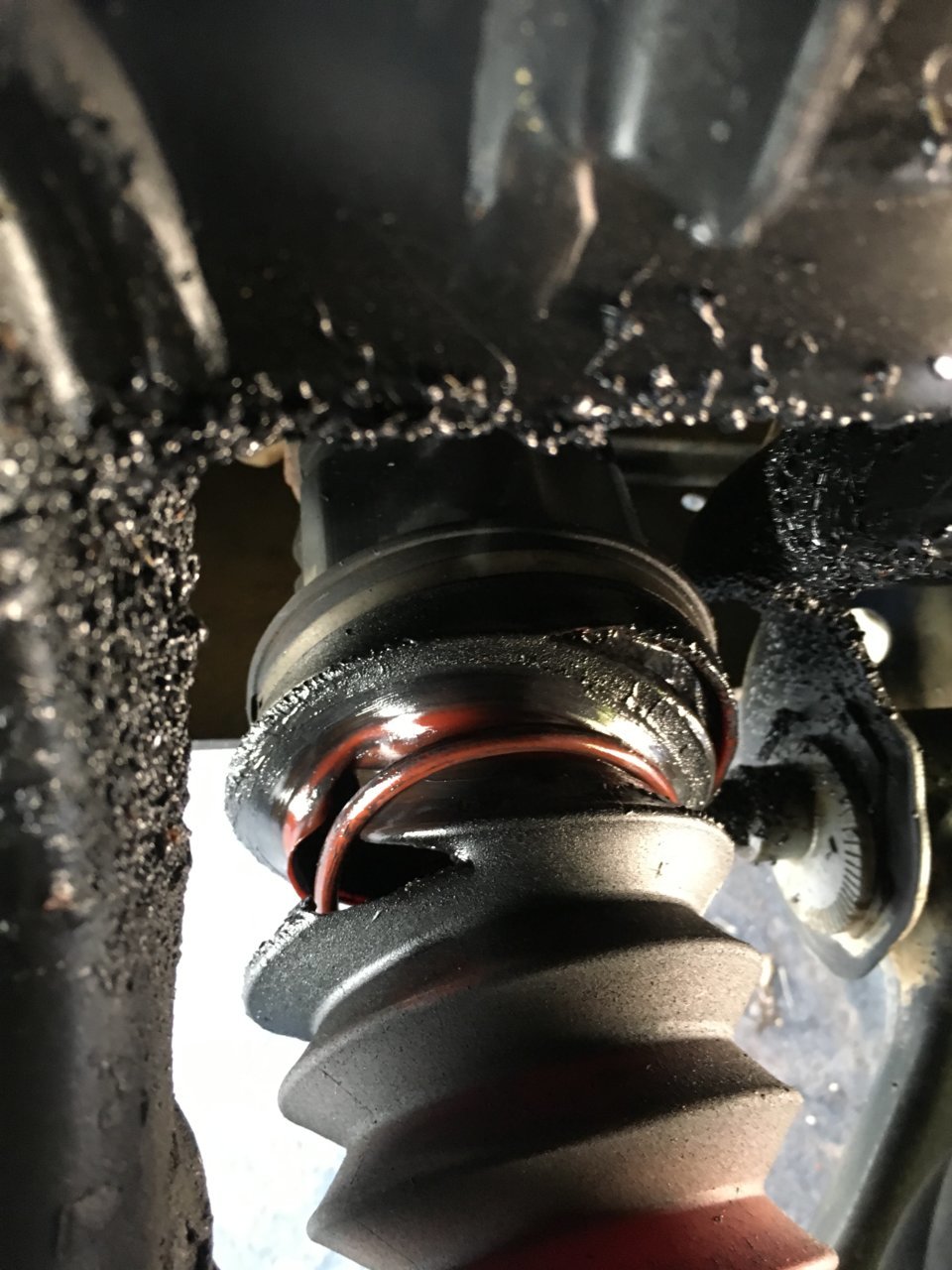

    So, the other day I noticed that the passenger inner cv boot was blown and spitting grease all over the place.
    I’ve had the CVJ Axles on for just under 3 years now. The drivers side is still in tact but, I’m wonder for how long. Now I’m faced with making the decision of either ordering 1 or 2 replacement cv axles and possibly having CVJ use a more durable inner boot instead of the extended red silicon boot like last time. I’m also thinking about lowering my front end as well. I just have too much body roll when I back the collars down on the coilovers. I’m under the impression that the 650lb springs are too soft but the 700lb springs are too stiff. Is the answer to this equation...700lb Springs + Steel Bumper = Better Ride?

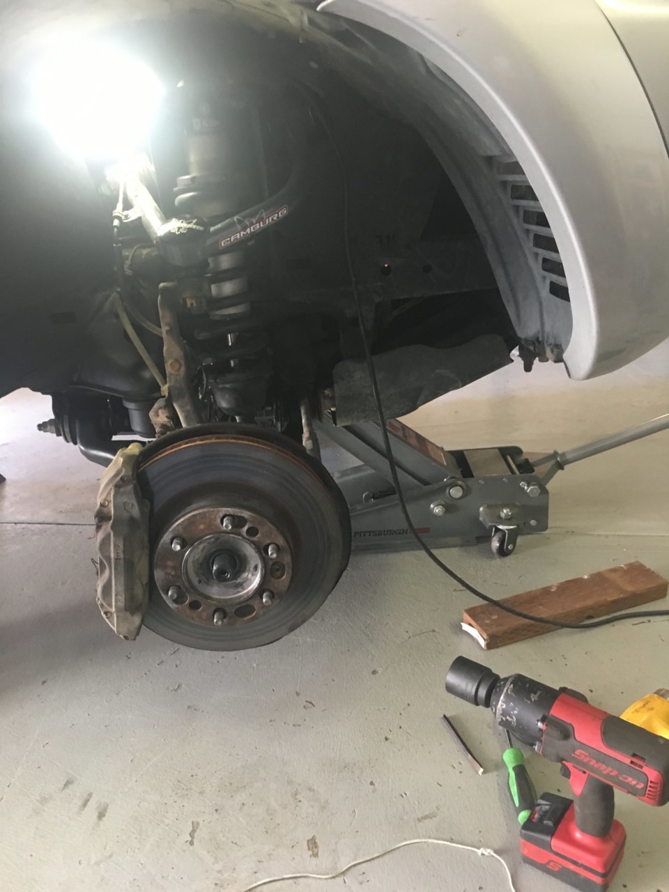

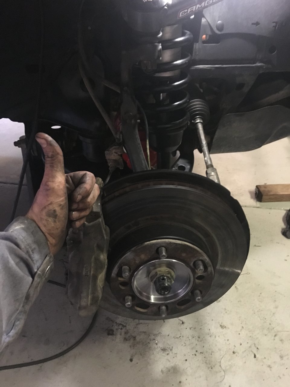

    11/23/2018

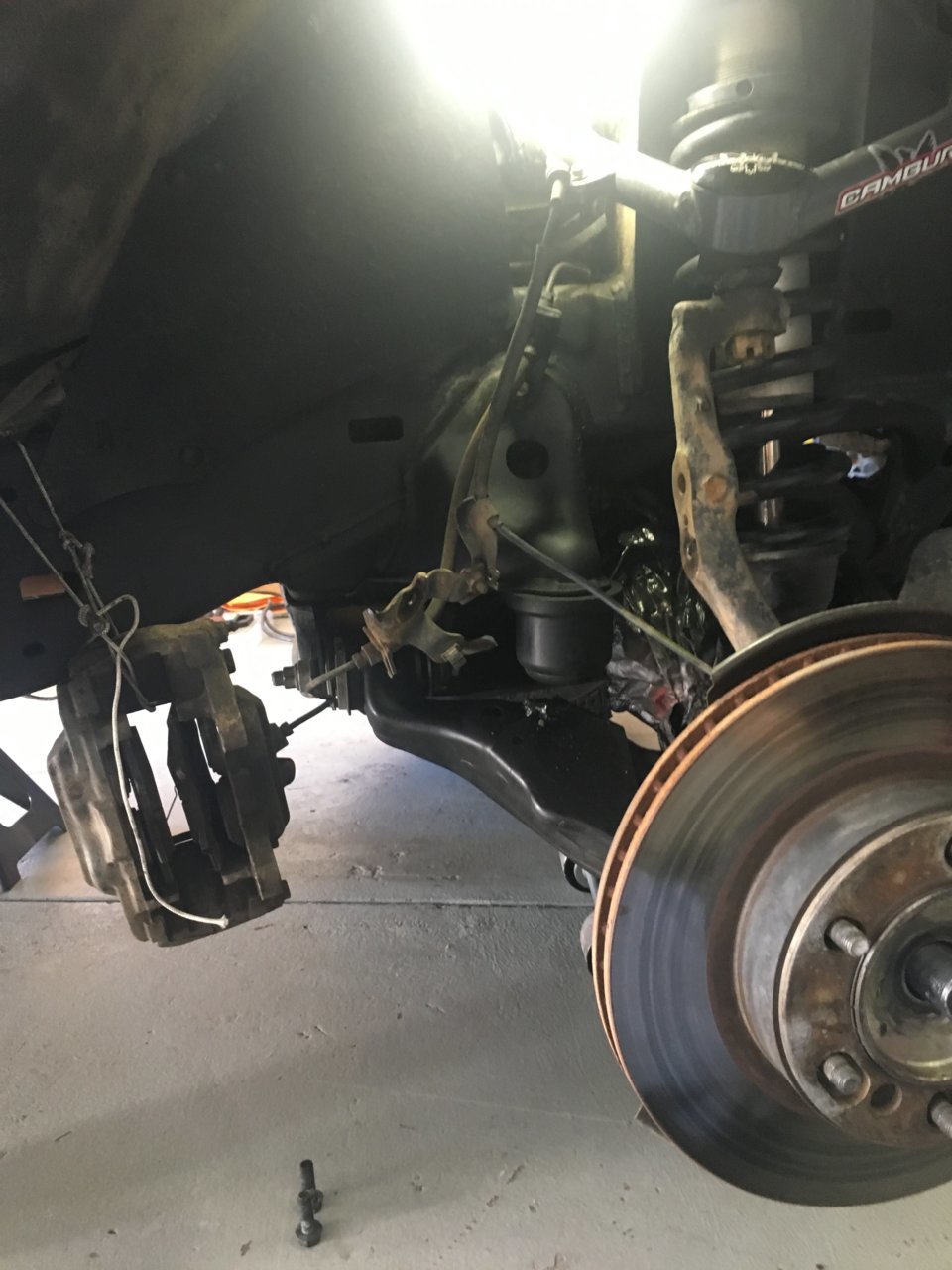

    Replaced Passenger Side CV Axle
    2995ABBD-D6B3-47C7-BCB7-D325C564B416.jpg 38075A86-CF12-4F78-B6A1-C62D27E73CE4.jpg 6BDB3E7E-1370-4173-9A46-8BABB30BD30D.jpg B3423B64-3A7E-4A8A-9607-73B5D4AC2963.jpg
    This job turned out to be more of a pita than I thought due to me not remembering to buy a new inner hub seal. That and I was hella tired & grumpy lol

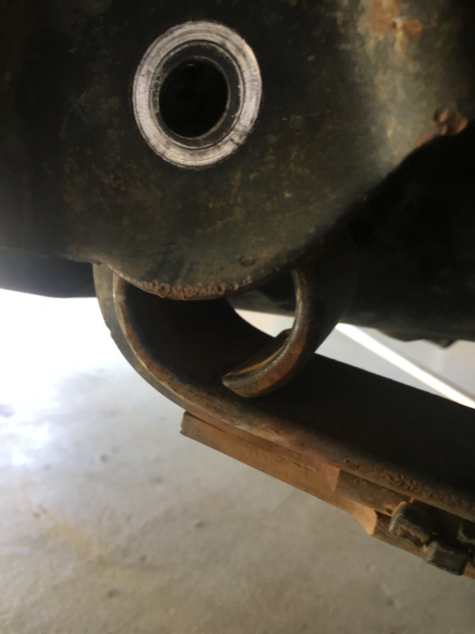

    4/13/2019

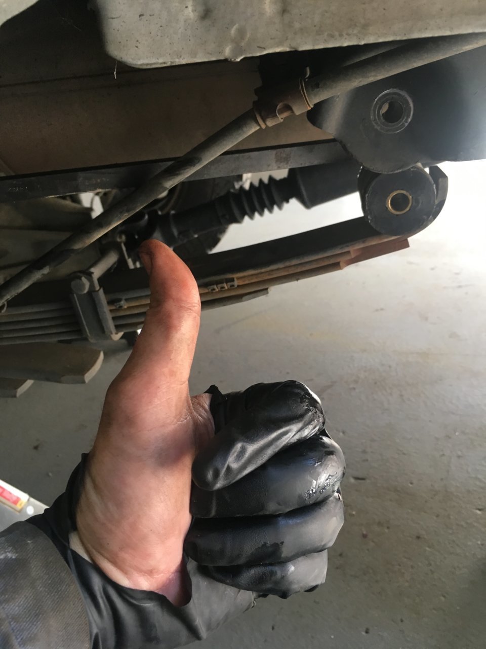

    I replaced the leaf spring bushings in the front hanger on both packs in an attempt to eliminate the sound the original ones were making. Pressing out the old bushings wasn’t too tough...just used a larger socket & hammer :D
