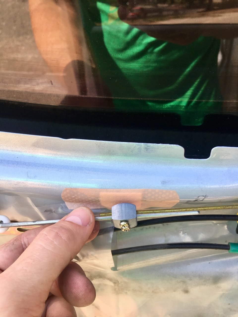

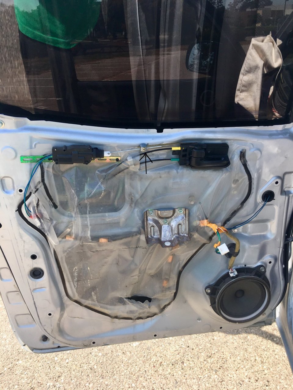

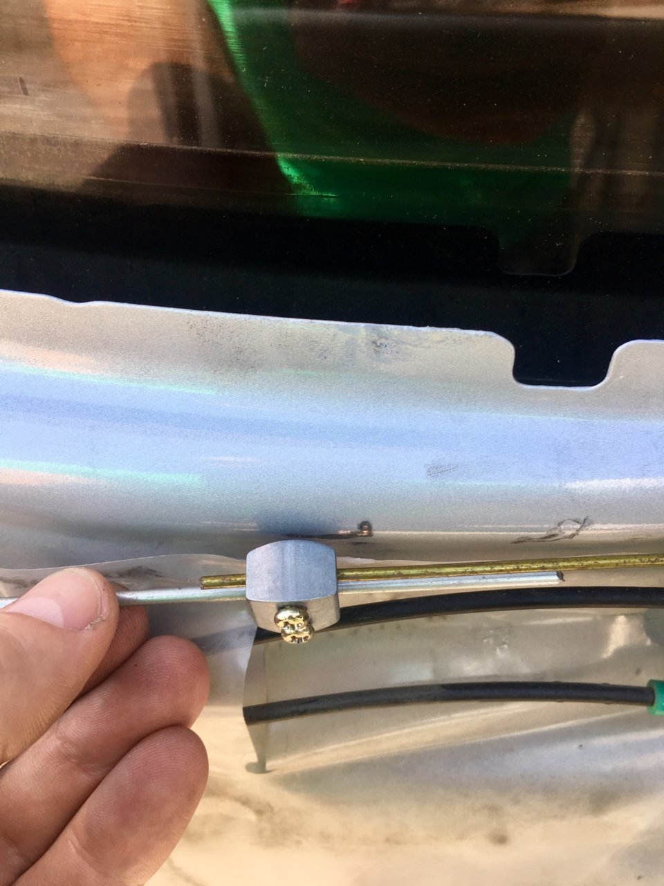

    So I had this knocking sound coming from the rear drivers side door. I took to door panel off to investigate. I found the source was this little bugger bumping against the door frame when I went over bumps in the road.
    So, I fixed it :D
    lowmower, d.shaw and deadhed61 like this.

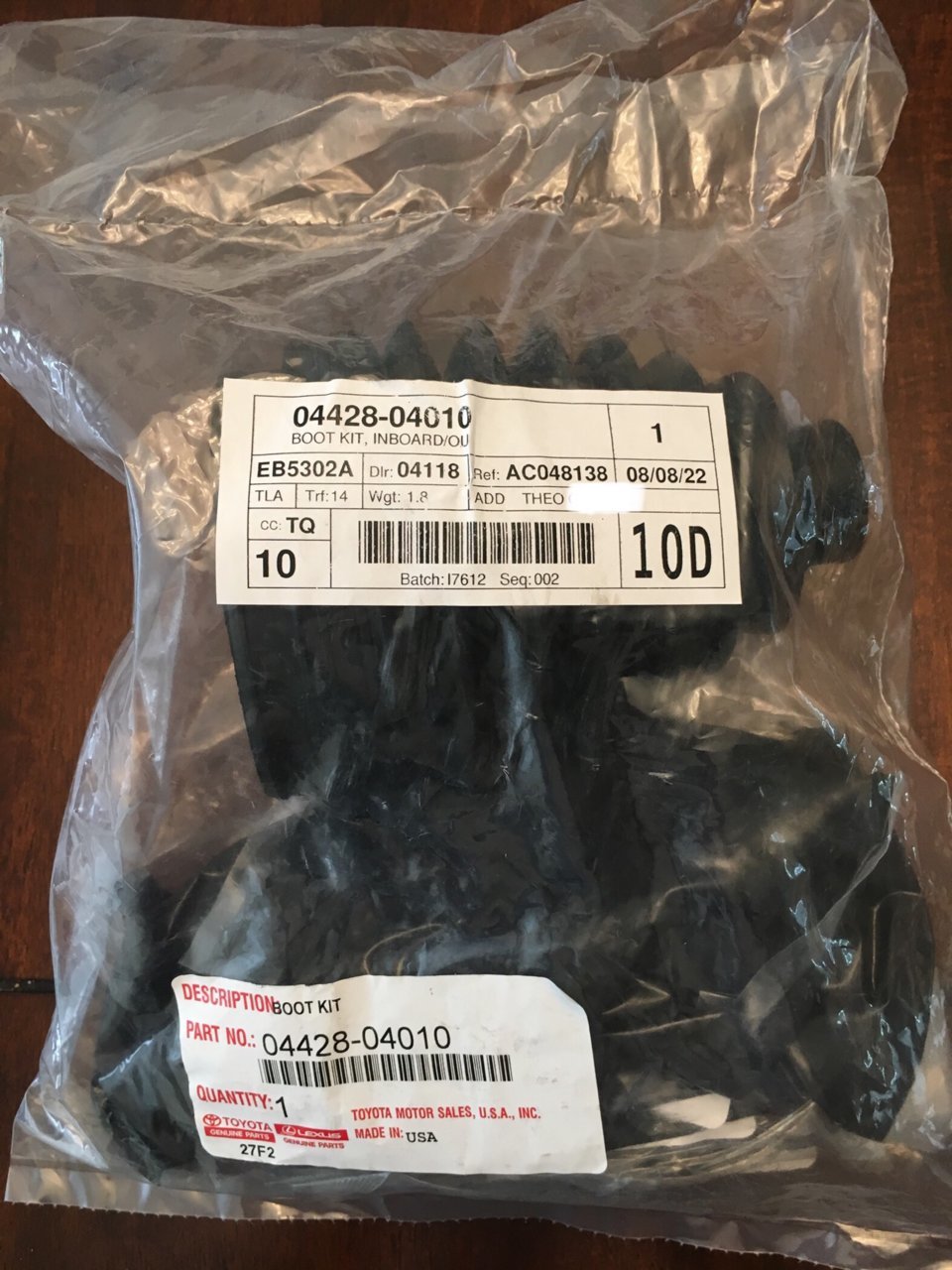

    The OEM CV-Axle Boot Kit finally arrived.
    Now to buy or borrow the right tool for the clamps & attempt to rebuild the cv axle.
