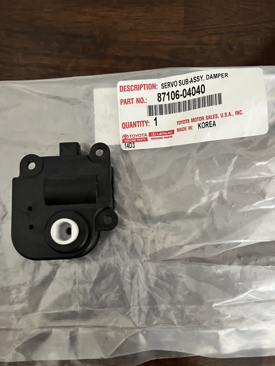

    4/30/2023
    Pulled this out because every time I used the Air Recycle button I heard a loud knocking sound coming from behind the glove compartment. Now to find a good replacement asap.
    I’m guessing this is an aftermarket part I pulled out. It looked like the previous owner installed it. I’m contemplating on putting an OEM part in there.
    :EDIT: So I read on Toyota Nation forums that the OEM Part says “WOORY” on it.

    Mine occasionally makes the same noise!! :rofl:I thought is was just a bad actuator or the flipper was getting stuck/broken. Did you confirm the noise was coming from the actuator before taking it out?
    "click-click-click-click-click-click" is what mine does. I just push the button again and it goes away. :anonymous:

    Umm, I didn’t confirm but from everything that I read on TW about it, I’m almost certain that this part is the culprit. I’m just trying to make sure the replacement part number is the correct one: 87106-04040

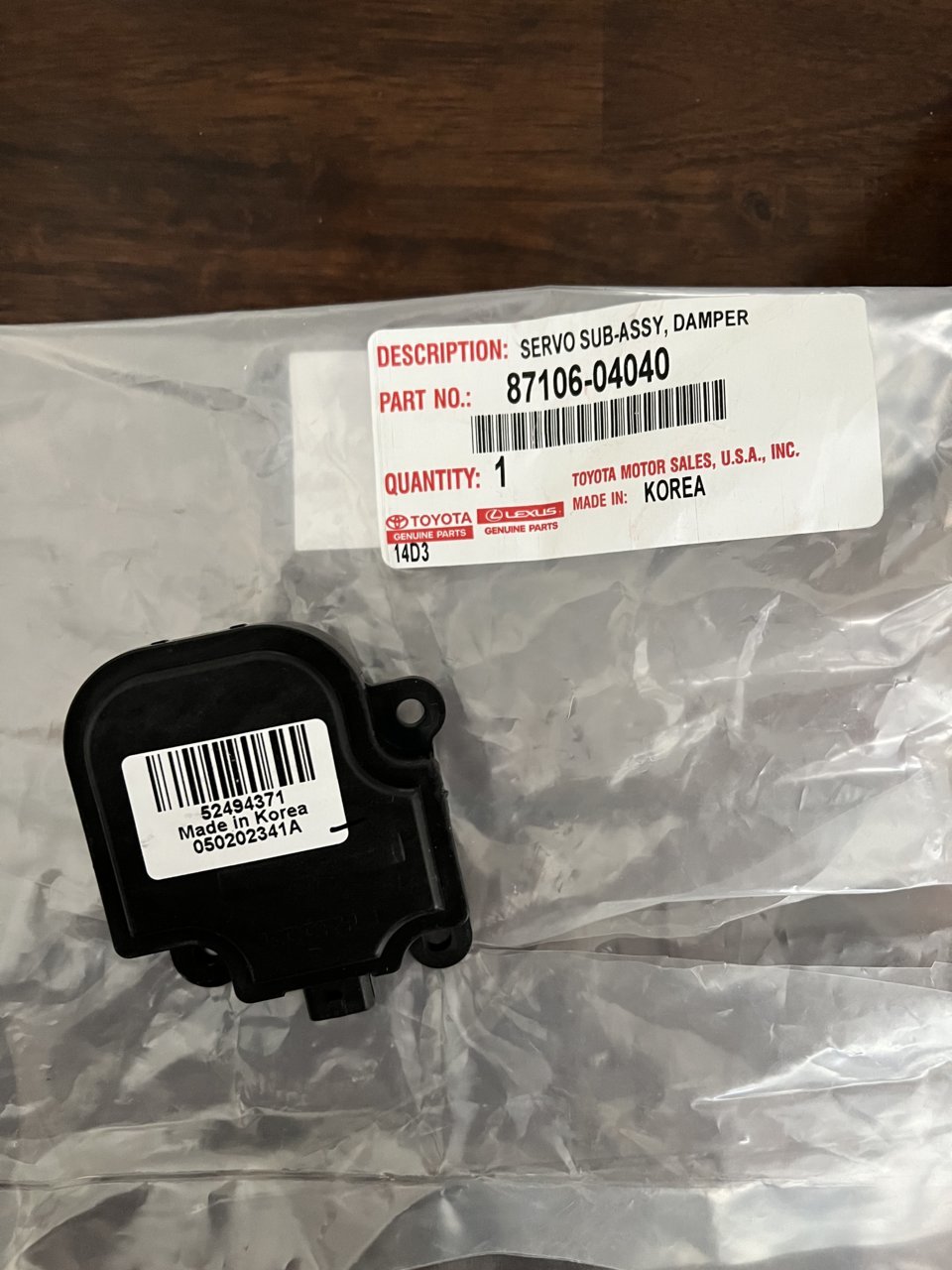

    5/12/2023
    Ok, so today I finally received the replacement part for my air circulation in the cab. I’m going to put it in tonight and hope it resolves the clicking sound issue that came from behind the glovebox.

    :boom:5/13/2023
    Ok, just installed the new “Servo Sub-Assy Damper”. I say something closes when it actually opens but, I’m pretty tired today and am not going to make another video because of that. Use a small ratchet with 7/32 sockets.
    https://youtube.com/shorts/xHhF3ESaBL0?feature=share
    I’m hoping the clicking/knocking behind the glovebox goes away now. I’ll update later.
    :EDIT: It fixed the problem. :thumbsup:
