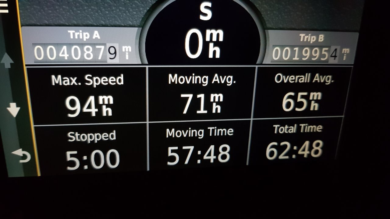

    Went straight to stage 2 at 60K and put on at least 10K since.
    Cat in place with provided O2 sensor bypass.
    Driven almost 2K almost nonstop twice.
    BassAckwards[QUOTED] likes this.
