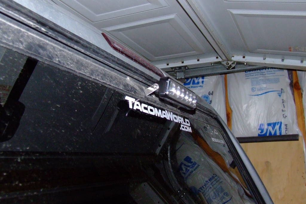

    Can you snap some daytime photos of how you have the lights mounted. I put the 6LZ where the stock trailerplug is. Fits nicely

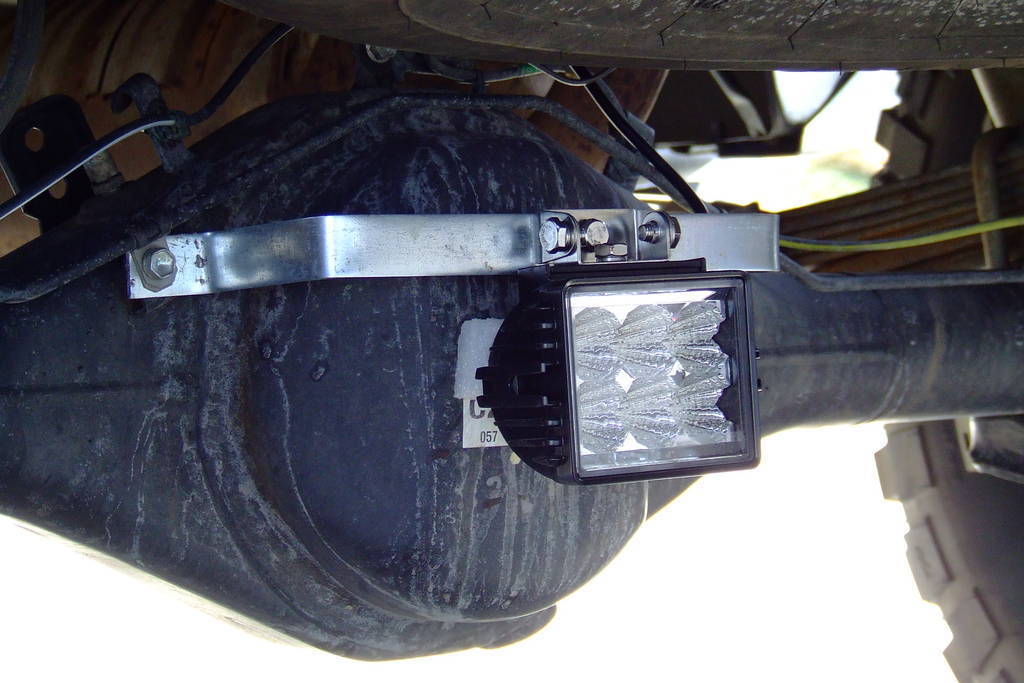

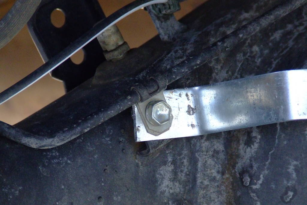

    I wanted mine to be safe from getting hit while on road or off (I've seen people drag the receiver & I've dragged my bumper before I added the receive).
    I'm thinking of getting another one of each & putting the 2nd 6LZ on the top of the license plate holder and the 2 Hawk 6Ds up front.
    The 6LZ is mounted to the shell window frame just above the glass.
    The Hawk 6D is mounted to the silver (zinc coated steel) metal band I bent to fit from to the two tabs on the axle that hold the brake line.

    Looks good. I was initially thinking of putting the 6LZ above the license plate but you'd have to modify the bed it looked like to fully open the tailgate.
    It would also be sick if you could mount it between the bumper and the top of the trailer hitch. Tuck it up out of the way
