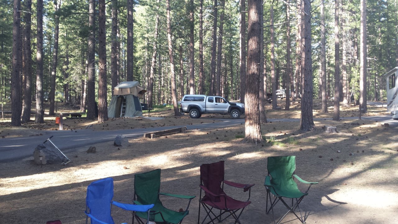

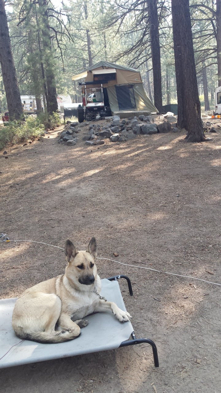

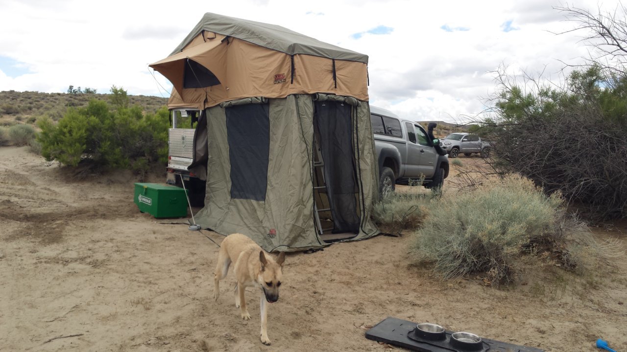

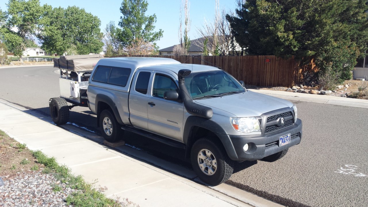

    A couple of days after ordering from URD I got a killer deal on a Rubicon trailer with RTT.
    After towing the trailer up the hills & mountains around here (NW Nevada by Reno & Lake Tahoe) I knew I needed the upgrades on the way. I love the set-up. I liked the Idea of the RTT, but didn’t want to have to take off shell & mount bed racks to use it. I don’t know if my shell would hold it (and didn’t care since it barely fits in the garage now & wouldn’t if I had racks to mount RTT on).
    In 5 minutes I’m setup.
    Since my wife of 32 years passed in February I got a dog & more into my Taco & camping.
    Buddy like my Taco
    This is a great set-up & I’m I the process of setting up the back so I can easily access my camping stuff.
    20180527_131511.jpg 20180527_192955.jpg 20180607_181934.jpg 20180803_161143.jpg 20180803_161300.jpg 20180808_104356.jpg
    The front of my bed already has a 200aH gel battery & 2KW inverter/solar charger. I still need to mount & connect my 2 100W solar panels.
    After that comes a 5’ pull out that will hold 1st my Dometic CFX75DZW then there will be a set of pull out shelves that will hold my pizza oven, gas grill, & 22” Blackstone griddle. I’m not sure about Blackstone & grill but I know my Uuni pizza oven will be screwed to the plywood since the drawer guide will slide all the way out & off. Then I can just carry it to a table & fire it up. I'm not sure yet how much extra space after that for assorted shit, but on top of it all will be quick fists that will hold the frame of my 9' inflatable pontoon boat & 55lb thrust trolling motor. I got the boat & a trolling motor because Buddy loves to swim & play in the water so much & it would be easy to pack.Screenshot_13.jpg Screenshot_15.jpg
