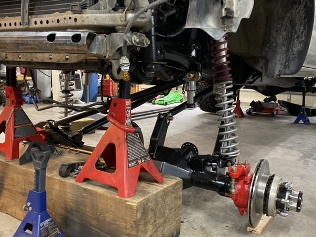

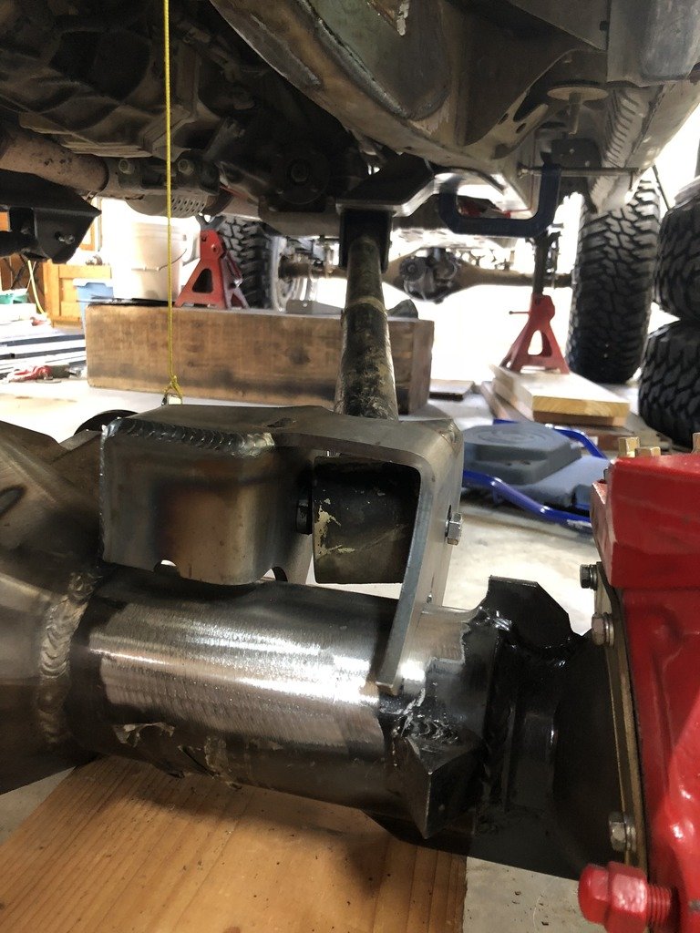

    hey guys, so I'm doing a SAS with a diamond housing on an 04' double cab. this morning i started mocking up the link brackets and the angles don't seem right. does this look off to anyone else? I'm planning on running helms so these links are temporary but it doesn't look right to me, this is my first 3-link and I'm doing it all by myself so any help would be greatly appreciated.

    I have the same kit for the DS drop Diamond. Mine is Brian's prototype and have been through quite a bit to dial it in.
    What is the width of the axle? Mine is @ 62". It appears your link tab needs to be moved inwards. Do you have an extracab, RC or 4 door?
    I can get measurements for you if needed.

    ... also, his kit was originally designed for a PS drop @ 65" WMS width. I had to rotate my DS link bracket inwards 13 degrees which cured some of my issues.
    Let me know... I can save you some time and head scratching.

    yep its a 4 door, it was a pre-runner that was converted to 4x4. WMS i think is 63 but i have to check (i travel for work so I'm not home much). rotating the bracket seems like a good idea I'm just hoping i can get it to work without too much modification to the brackets. I would be very interested to know your link lengths and placement dimensions of the mounts to compare with what i have mocked up. Ritchie i have read your build thread and your truck is awesome, thanks for offering some advice. i can't wait to finish my truck, most of the hard work is finished just need to do the front axle suspension and some small stuff. The truck already has a supercharger and i am installing marlins dual ultimate cases too

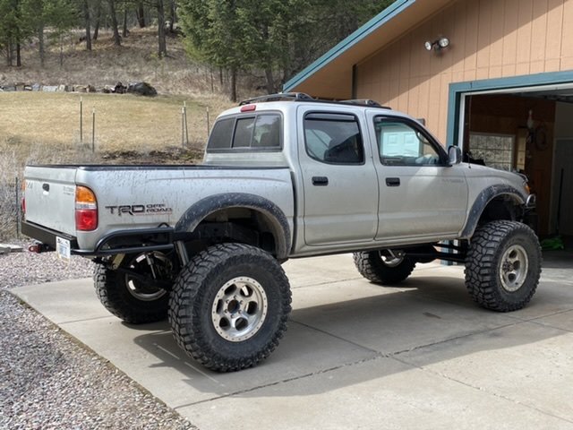

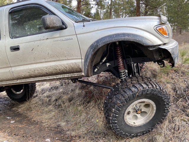

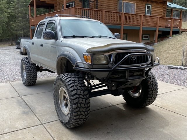

    finally finished her up, still need to add the hydro assist steering, sliders, crawl box and a few other things but I’m driving it and it works great. I am pretty disappointed with the 4WU kit (I know everyone is going to disagree with me) but whatever, it’s finished now. The kit took a lot of modification to work and the customer service was absolutely terrible, if i ever meet him he isn’t going to like it. I’m just glad I can finally enjoy my truck!

    If anyone is interested, I used Alcan spring to make me some custom rear springs and 12” fox adjustable shocks in the rear custom valve’d from downsouth motorsports. The rear flexes as much as the front and it rides super stable. Those are 37” coopers with no rub.

    Looks good man... a bit tall from the pics. What is the frame height?
    How much lift with the Alcans?

    7” lift with #250 of gear, they are a little shy of that though. Frame is 26.5” empty, 1” or so lower loaded. The truck performs great for what I wanted, overland and snow wheeling.

    Truck looks good. That height will probably be great. I was all happy that I built a low rider until I took it wheeling and I wish I was higher, getting beached on evreything sucks. The reality is the tacoma is so damn long its pretty stable and needs that height.
