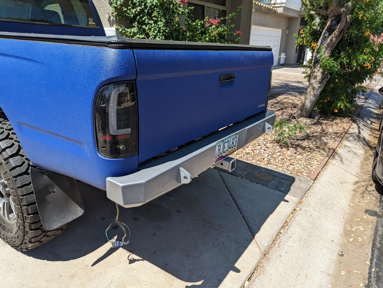

  17. Aug 14, 2023 at 5:09 PM
    #17
    treyus30
    treyus30 70% complete 70% of the time
    Jun 24, 2015
    #158054
    8,406
    Trey
    Mesa / AJ, AZ
    '99 5VZ-FE Twin K03s w/Haltech
    Historic plates and 2 bar
    Paint it in rustoleum so it's easy to touch up at any point
    (installing & painting sliders the same color)
