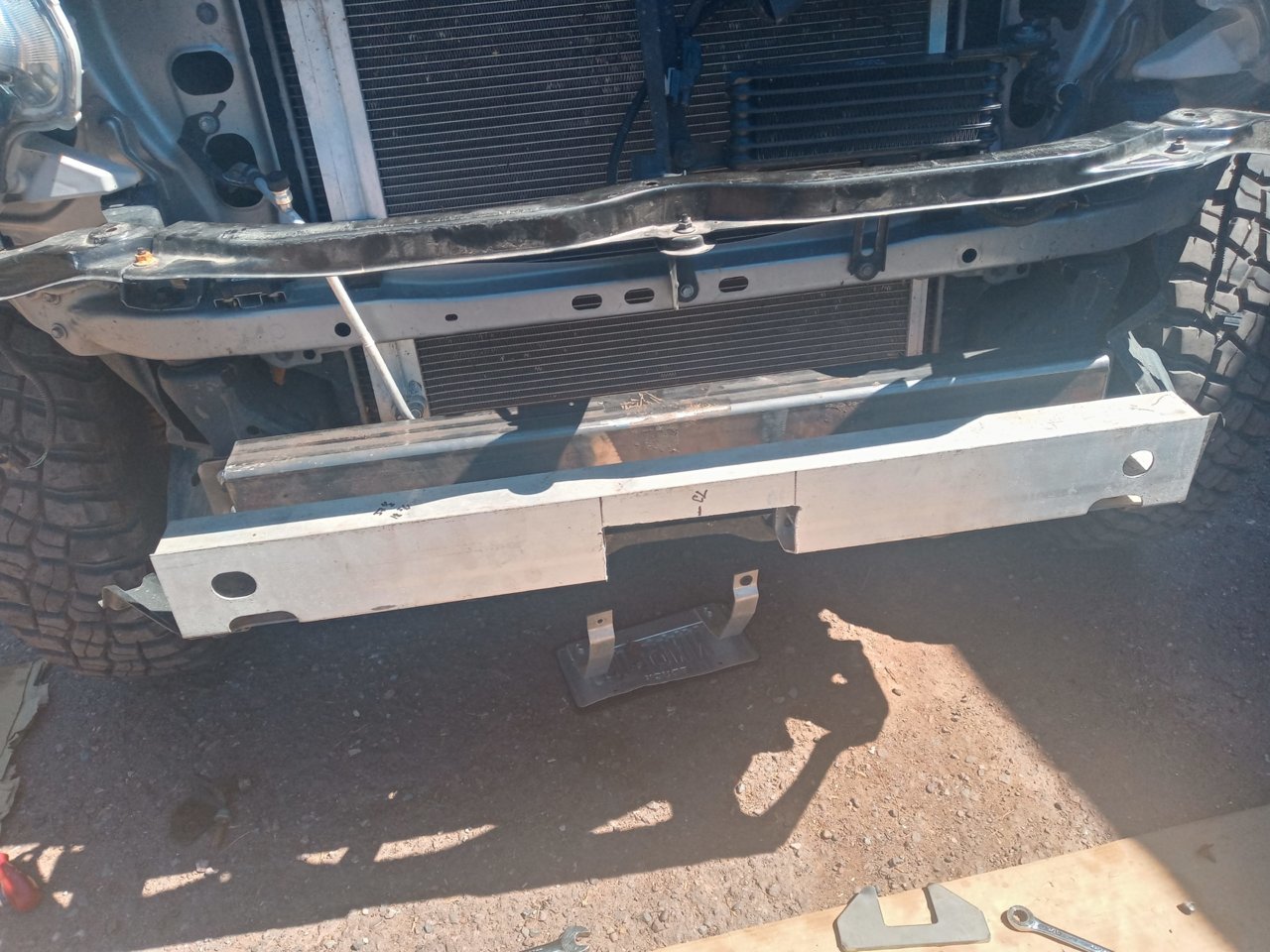

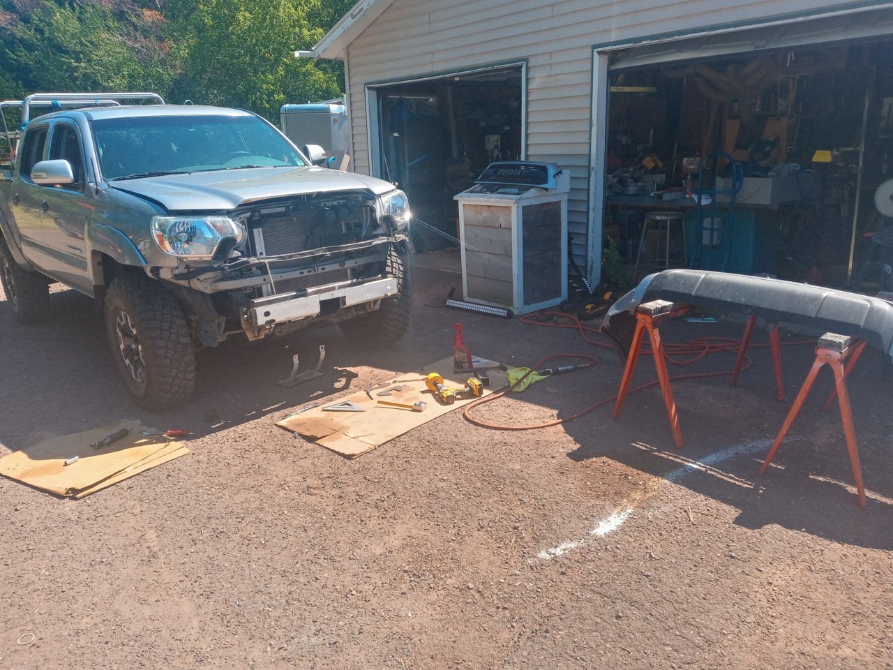

    Disassembly is easy and takes all of about ten minutes. There are several videos using a Google search. Another half hour and every thing has been disassembled, assembled mocked and ready to cut. The factory aluminum cross bar needed to be notched and this took about 40 minutes.

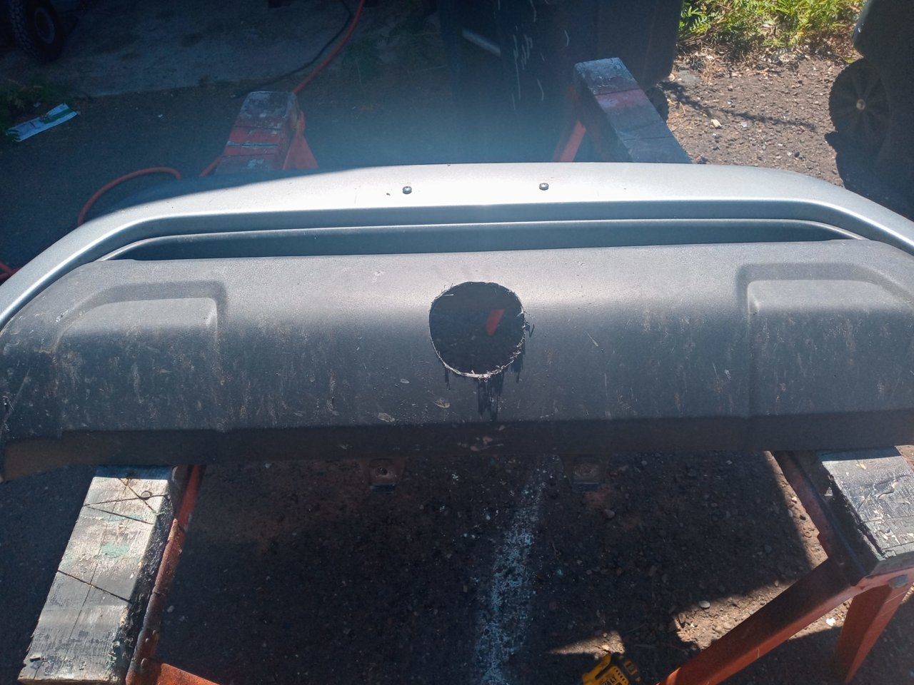

    Now it was time to mock up the bumper, and make a hole for the receiver. Scary!

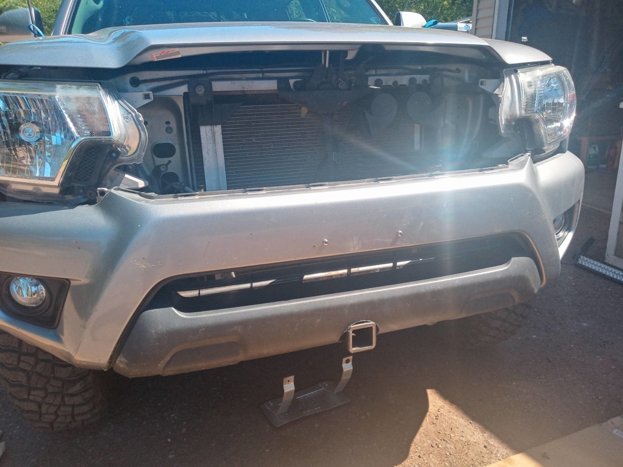

    And... It fits like a champ! The actual receiver part is 6" to short so I am going to locate another one and get this welded together later this week.

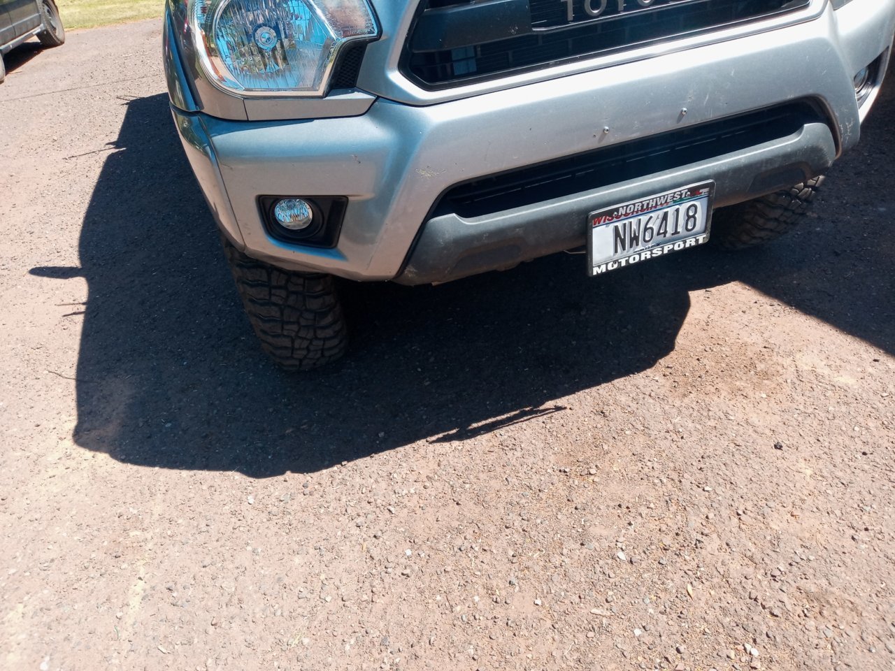

    4x includes a nice license plate holder that goes in the receiver, so none of this will be seem-just like now with everything buttoned back up
