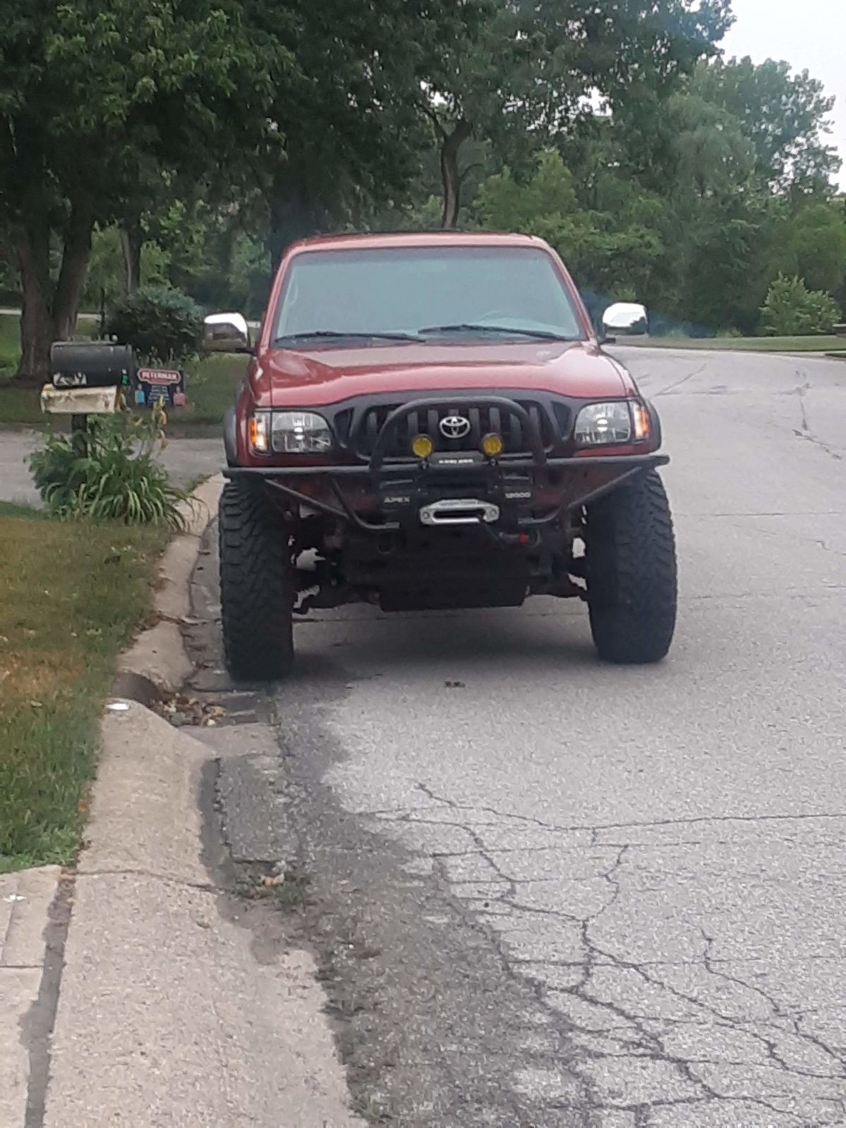

    Yeah, that winch is pretty big. I couldn’t relocate so I cut my grille. My bumper also has more depth so easier to make fitIMG_4993.jpg

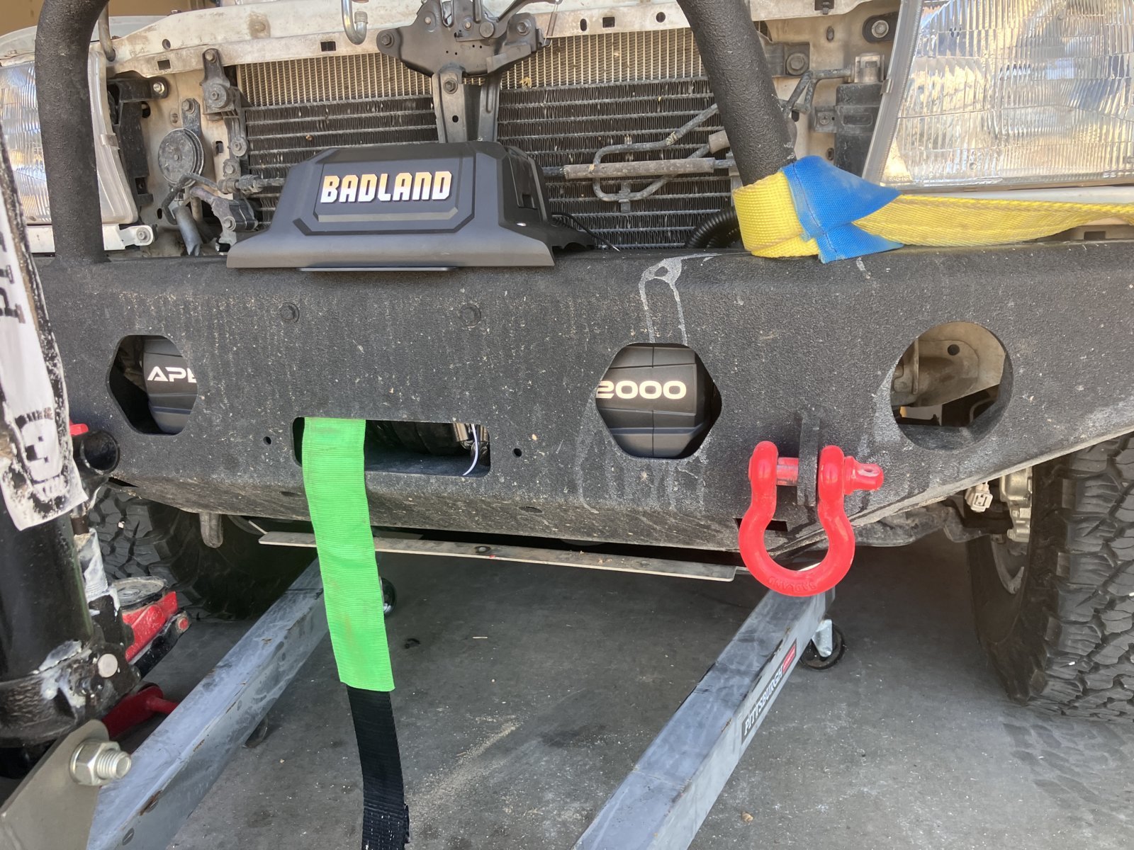

    Heres a couple pictures of how I cut mine. Just remember you'll have to cut wide on the driver side so you can open the cover to turn the winch on.
