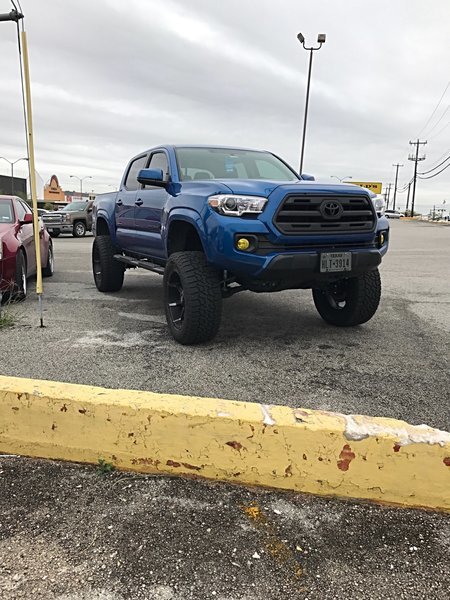

    Just out of curiosity. Did you have to do any cutting on your truck? I'm being told 35 inch tires isnt going to fit on my truck without cutting. I was really trying to avoid cutting my truck. but, i'm worried about the space in my fenders.

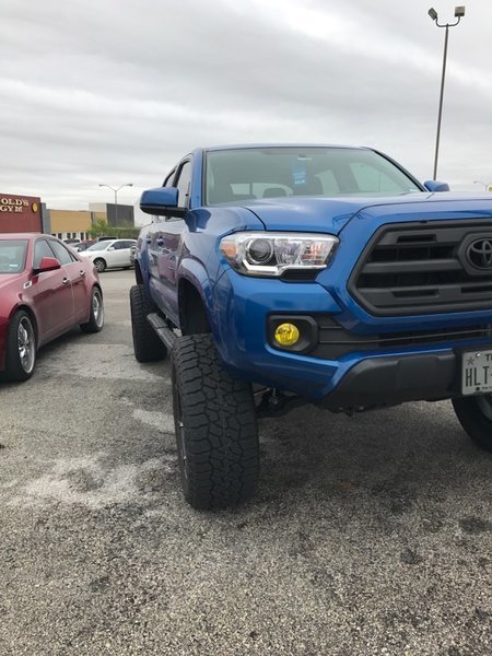

    When I had just the 4" lift, yes I had to trim off the end tab on the bottom part of my front bumper and trimmed some of the plastic fender well. I also used a heat gun to push in some of the plastic where it was rubbing as well. I also saw I was rubbing on the cab so thought I was going to have to do a cab mount chop..but Once I went to 6.5" I cleared the cab at full lock and in reverse and don't rub on the fender anymore.

    And whoever is telling you could be right and wrong at the same time. It all just depends on the type of wheel you go with and the specs of it as well as the tire tread. Some treads are beefier/more aggressive than others. But really all comes down to the wheel specs as far as the offset. But just prepare to trim if needed.
