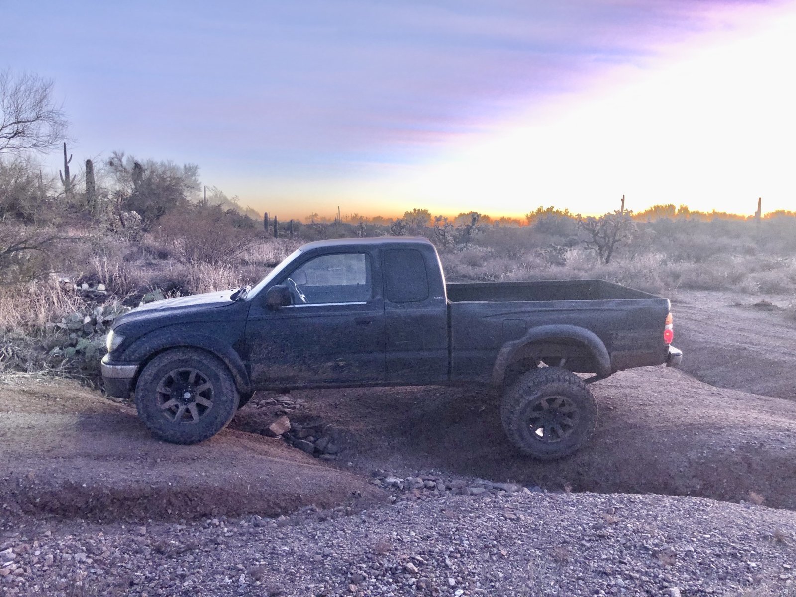

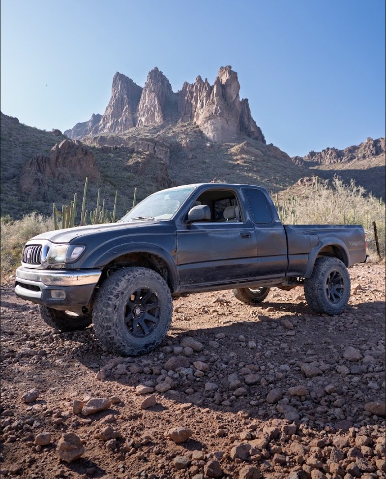

    Hey guys, last year I did a 4x4 conversion on my 2001 Tacoma Prerunner and wrote it all down. Hope this helps someone.
    Thanks,
    Jerry
    Edit: updated pdf 03/24, also added sick picture of my truck
