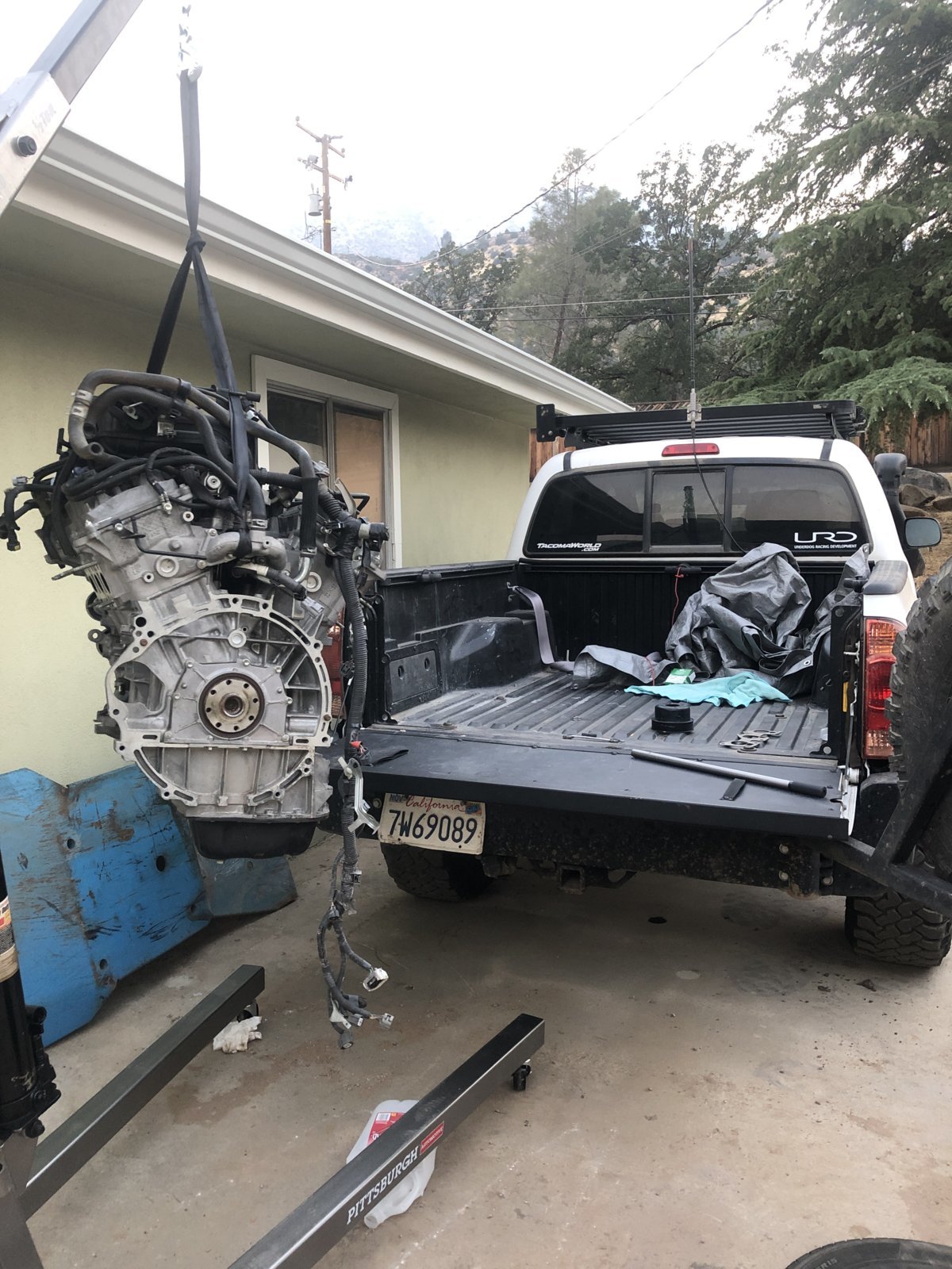

  8. Jul 2, 2024 at 6:48 PM
    Oreo Cat
    Oreo Cat Worst Member
    Sep 19, 2016
    #197755
    5,373
    Coeur d’Alene, Idaho
    my 4x4 truck got a replacement engine from a 2wd truck
    Ricardo13x and FjTaquito[OP] like this.

  10. Jul 2, 2024 at 7:40 PM
    Oreo Cat
    Sep 19, 2016
    #197755
    5,373
    my dad helped every now and then, took me a few weeks since I had no idea what I was doing
    FjTaquito[QUOTED][OP] likes this.

  12. Jul 2, 2024 at 8:13 PM
    Oreo Cat
    Sep 19, 2016
    #197755
    5,373
    I got it from a Toyota dismantler in SoCal, they used a fork lift to get it into my bed where it sat until I bought an engine hoist and transmission jack from harbor freight

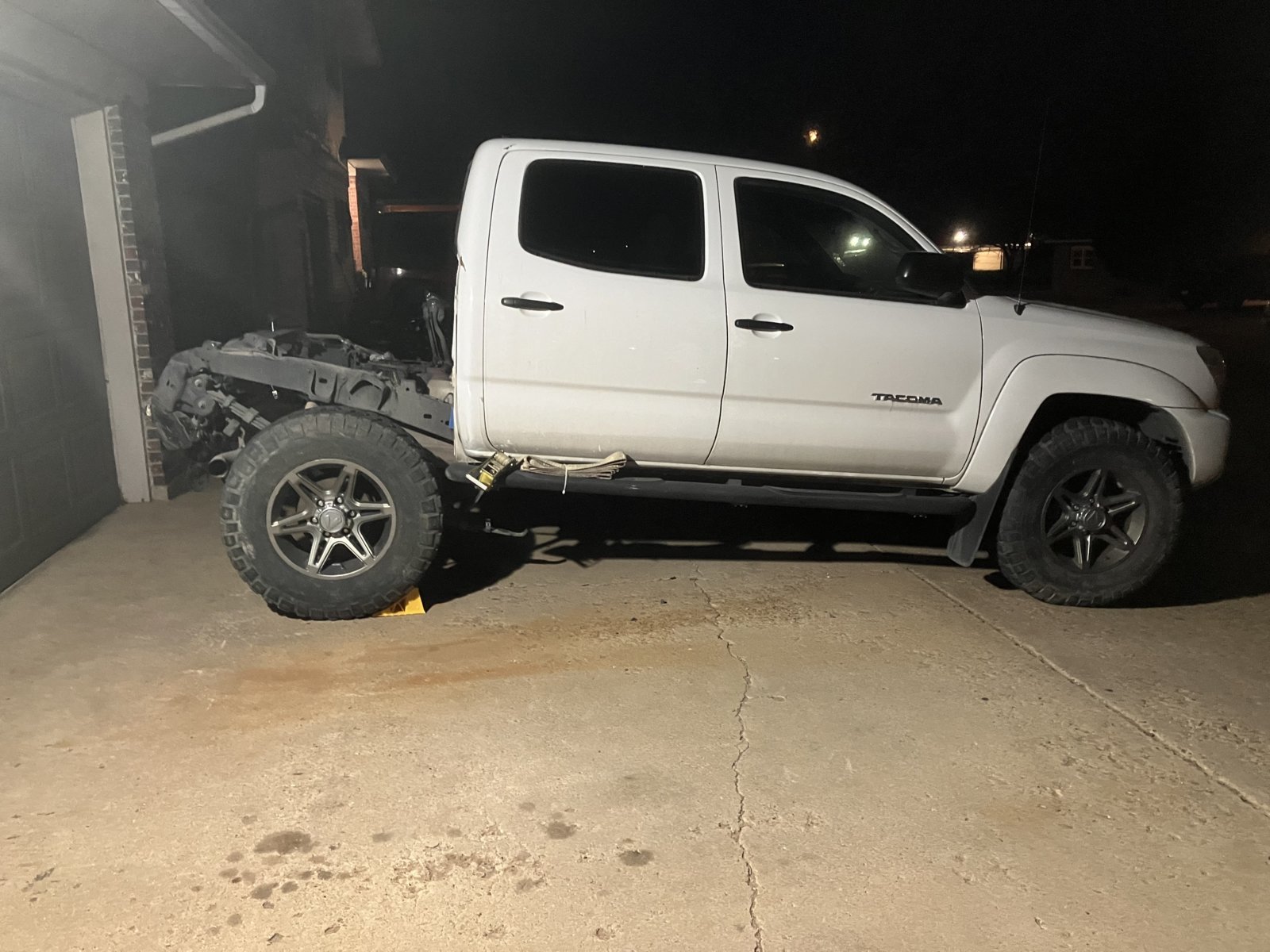

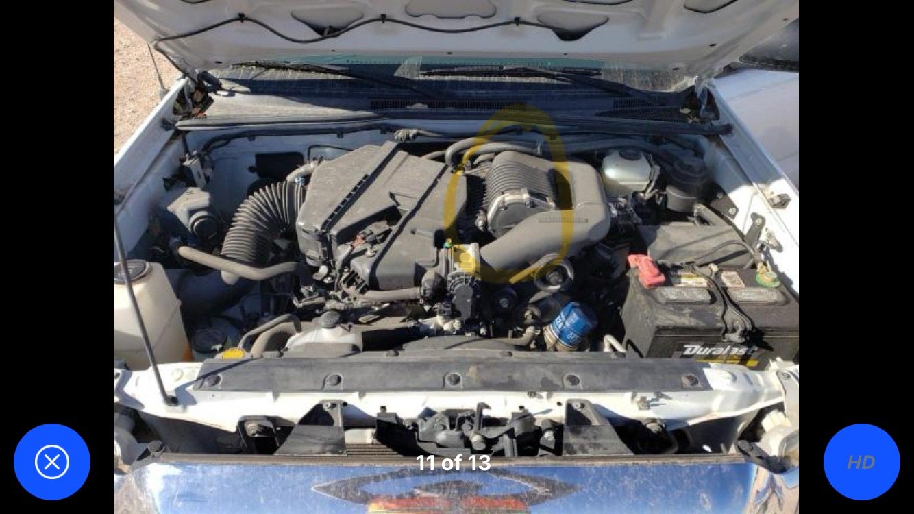

  18. Jul 2, 2024 at 9:54 PM
    #18
    KetoClutch
    KetoClutch Well-Known Member
    Jan 26, 2022
    #388481
    99
    Whit
    Borger, TX
    2012 DCLB
    Bilstein 6112/5100, OME heavy springs, SPC UCAs, Sumimoto bumpstops, Ultimate headlight upgrade, Grille, Raptor lights, Sound deadening, foam insulation, Speakers, Sub, Head unit, Power rear sliding window, Locked center console & bed cubbies, Shark fin delete, Hood struts, Bug visor, Window visors
    No smog or inspection issues in the Texas panhandle. My build is starting from a rear-ended (Magnuson) supercharged 2015 from a salvage auction, with a 2012 daily driver. I have a strong love-hate relationship with the 2.5 gen IMG_1283.jpg
