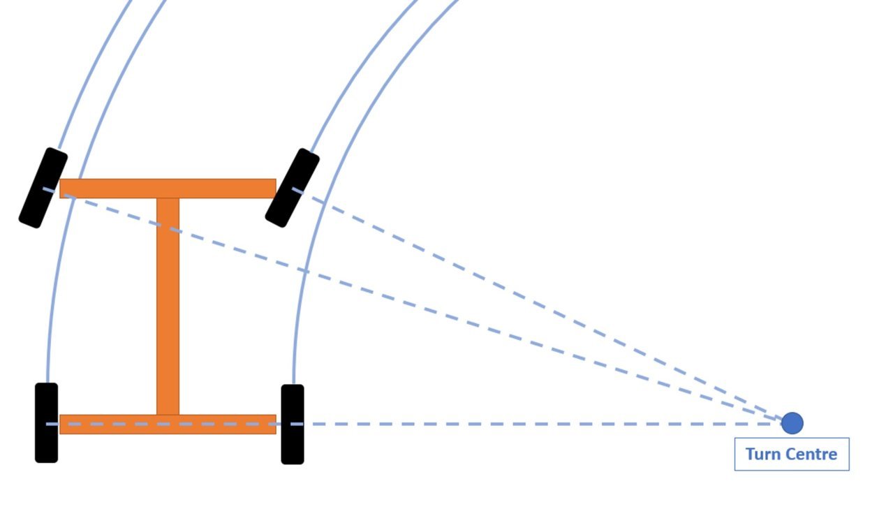

    Speedfreak
    Speedfreak Member in poor standing
    Sep 22, 2017
    #230756
    4,918
    Dave
    Canada Eh!
    2017 Tacoma TRD Sport DCSB 6MT, Blazing Blue Pearl
    Manual Mall Crawler
    Here, maybe this will help...
    In 2wd and in a turn, all 4 wheels will spin at different speed. The inner will spin slower while the outer will spin faster. The differential allows this speed diffence through the side gears in the rear. The front and rear diffs also spin at different speeds because then travel at different arcs.
    Now when you engage 4wd, you lock the front driveshaft to the rear driveshaft. They spin at exactly the same speed. This now locks both front and rear pinions and ring gears to the same speeds. So now when you turn a corner, the front and rear diffs can not spin at different speeds because they are locked together at the transfercase. With high traction, this will build twisting pressure in the driveline until a wheel loses traction and slips or a part fails and breaks. This what is referred to as bind. In low traction, like snow and ice, the wheels can slip much easier, allowing release of the binding.
