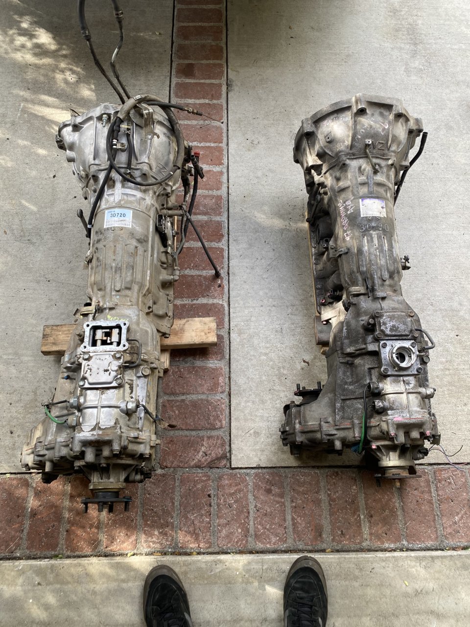

    Do you think the tail housing/tcase adapter, is the same for the foward shift 4cyl and the v6 one that you have with the blank covering?
    If you went with an output shaft swap, you would still have to make sure that that tail housing that bolts to the tcase will accept the tcase shifter and work properly. You need that adaptor piece to be able to bolt your tcase to your original tranny. I think I would be searching for a proper 4cyl transmission and tcase, as others suggest and sell the v6 stuff.

    Okay. Hopefully this is the last time I edit this post of mine here. Digging into part numbers, there is a difference. If I were to order a reman from toyota for a 2002, it would be
    350003G110 for a 6cyl and,
    350003G280 for a 4cyl.
    This turns out to be a bell housing difference. When we look at internals and pull the input shaft of the transfer case, that input shaft is the same for both 4 and 6 cyl models. So, no difference with a 4 or 6 cyl in that respect.
    @dunc_werks -- if I were in your position, I would -
    Find a 4cyl transfer case first. Try that first. Might not need to get a different transmission. TC first. What @GEN1_MK2 said
    Do this:
    Good luck. I think the 4cyl tc will work.

    Thanks. Am currently in route to pick up a 4cyl trans and case.
    Ironically I have already bought the spindles, locking hubs, cv’s, and 4.56 front diff off this parts truck.
    I did take a look at the top plates on the trans and case, they’re a different profile so swapping a shifter is a no go. Also the driveshafts I have need that 2 inch forward movement to fit. So 4cyl trans and case it is.

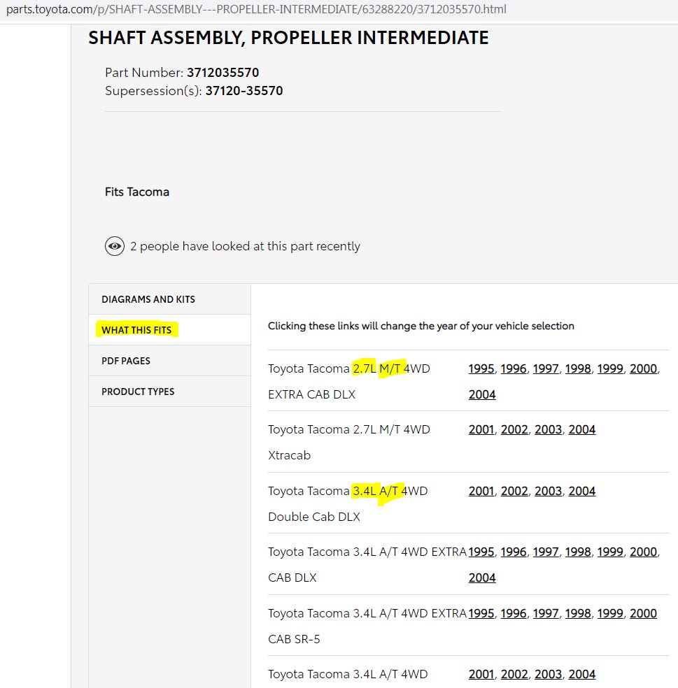

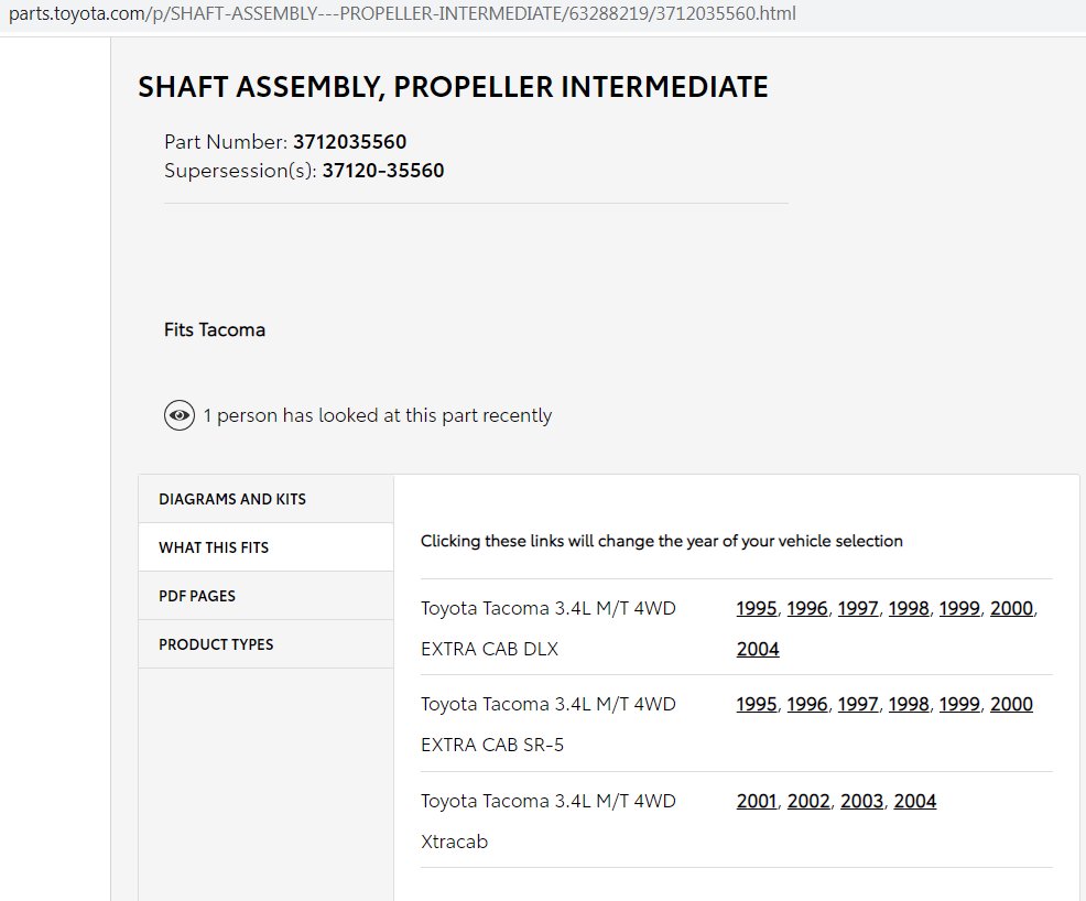

    Awesome! Congrats! So with the drive shafts, as long as its not from a MT, you should be good to go. When I was looking at part#s for the front of the rear ds they were the same between both 4 and 6cyl. The difference was with MT and AT driveshafts.
    I went the route of aftermarket because I could not find a suitable 4WD rear ds. What did I end up doing? Dropping off my prerunner stock ds and have it shortened. This aftermarket is going back into a box.
    see below:
