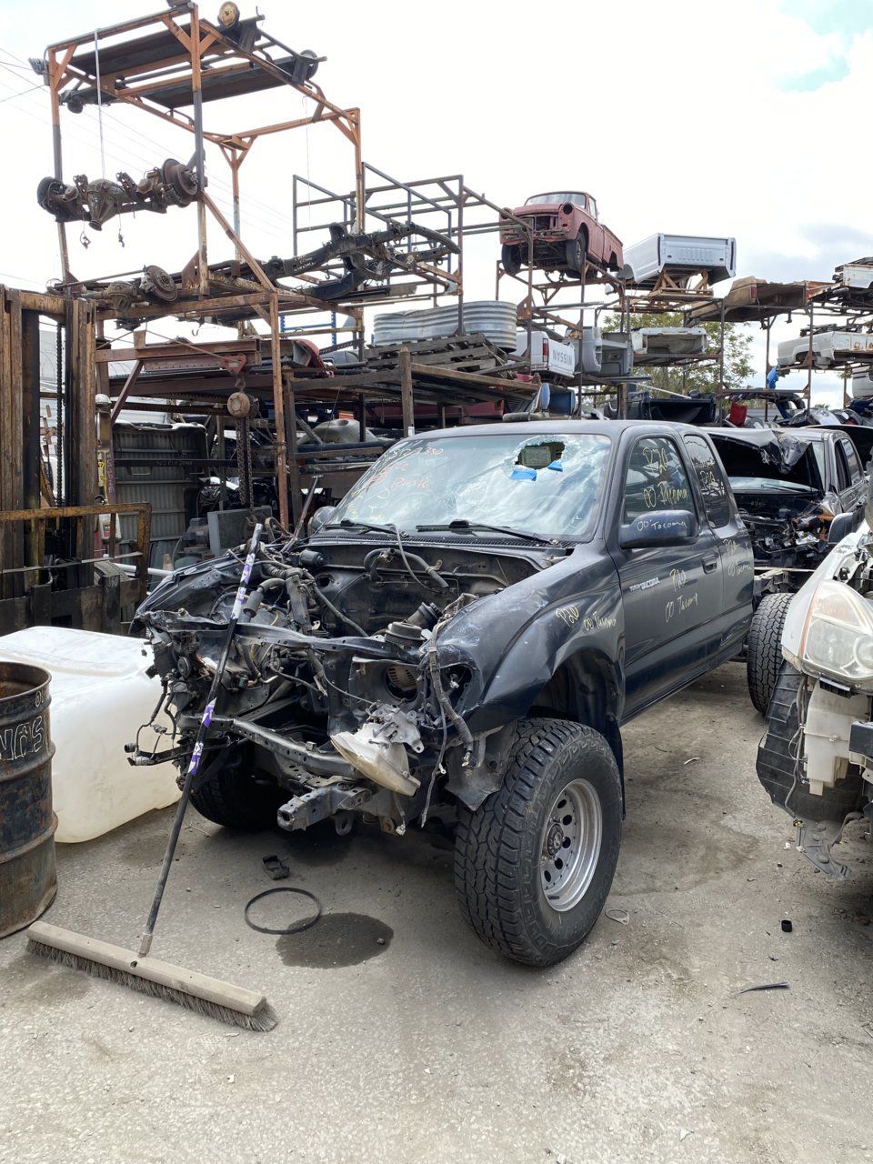

    02 PRE
    Thanks.
    Transmission, transfer case, front diff, cv's, spindles, hubs - came off this 2000 extended cab 2.7 4x4.
    My setbacks could have been avoided if I knew the difference between the 6cyl and 4cyl placement in the vehicle and how toyota accommodated that with the transfer case shifter placement.
    Glad to answer any questions - I've put a good 600 miles on it already and no issues to report since. Appreciate everyones help here - sincerely.
