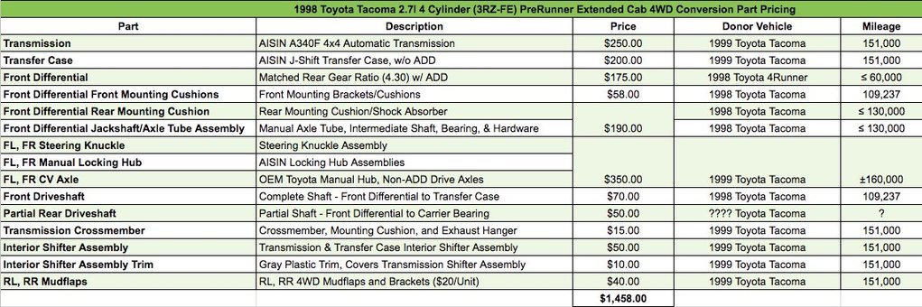

    I'm in the process of doing my swap right now. Here's a list of parts you need. This list assumes you're using manual hubs, j-shift, and a manual jackshaft. ADD will be much much cheaper.

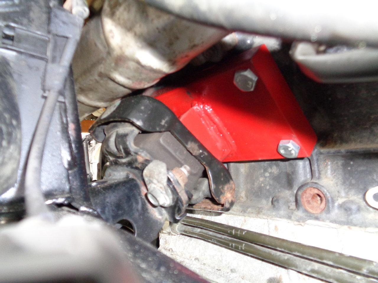

    The front diff is a strait bolt up application. I have the front diff of an 06 tundra in my taco. the engine mounts are home made. I moved my transmission cross member then made motor mounts. I studied singtoe's thread along with torque of the devel and yotaoffroad27. From the head lights to the tail lights my taco is tundra. Here is a picture of my motor mount. i bet it will not be long before someone is making them for swaps.DSC00006.jpg
