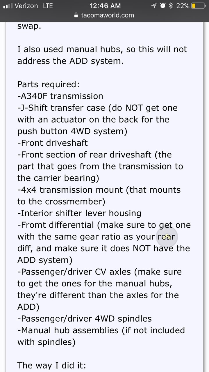

    Here’s a list of parts for a first gen pre to 4x4 manual hub conversion. Cant remember where I snapped it.

    I am going to look at some parts. The donor truck is a 98 Tacoma regular cab with a manual trans. What I am looking to get from this is the entire front 4X4 unit. Spindles, manual hubs, Axles, Diff assembly 4.10 gear, Front drive shaft (I believe it will need to be shortened for my auto trans application). J shift transfer case. Should bolt right up when I either find the A340F or swap out the 4x4 output shaft to my tranny. He has offered up the B03A rear end as well but I haven't decided if I want another one. I suppose if I got it I could do the work on it to accept an E Locker 3rd member when I find one. It looks like I can get all these parts for around 750. I may also take the rear drive shaft as it would give me material to make shafts the correct length in case I can't find affordable shafts.

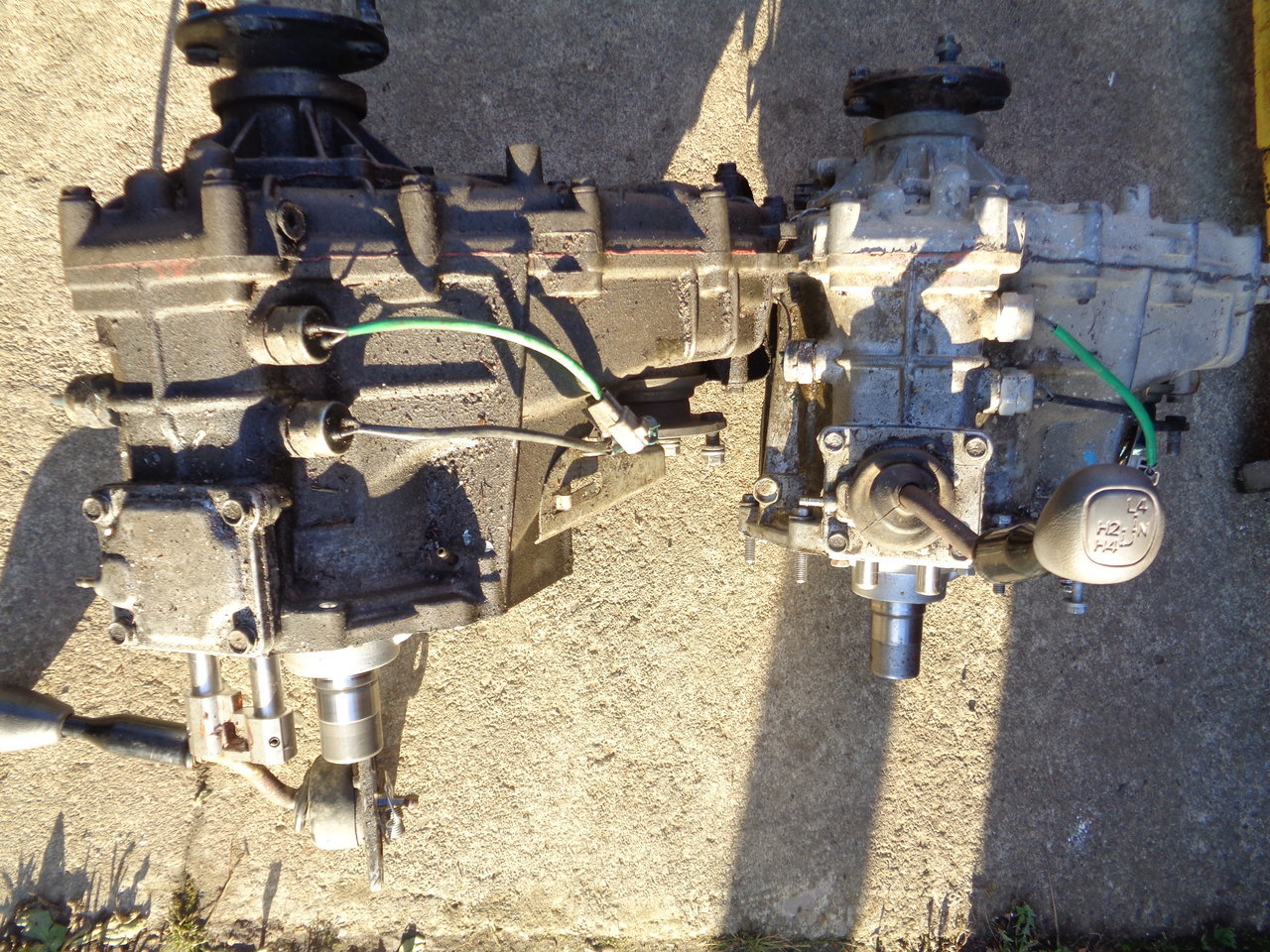

    I am preparing to do another pre-runner double cab to 4x4 swap myself in a week or two. One thing that sucked was I have two front diffs on hand, nether were the correct gear ratio 4.56 and 3.58. I needed 4.10s. I got one with the ADD, but change out the axle tube. This at lease gave me the opportunity to verify ratio. The only possible delays are the manual hubs being pressed into the ABS steer knuckles and having the front portion of the drive shaft shortened. For those I am at the mercy of the machine shops. Be mindful of 4 cylinder to v6 the t-case are different, top shift (v6) and forward shift (4cyl).

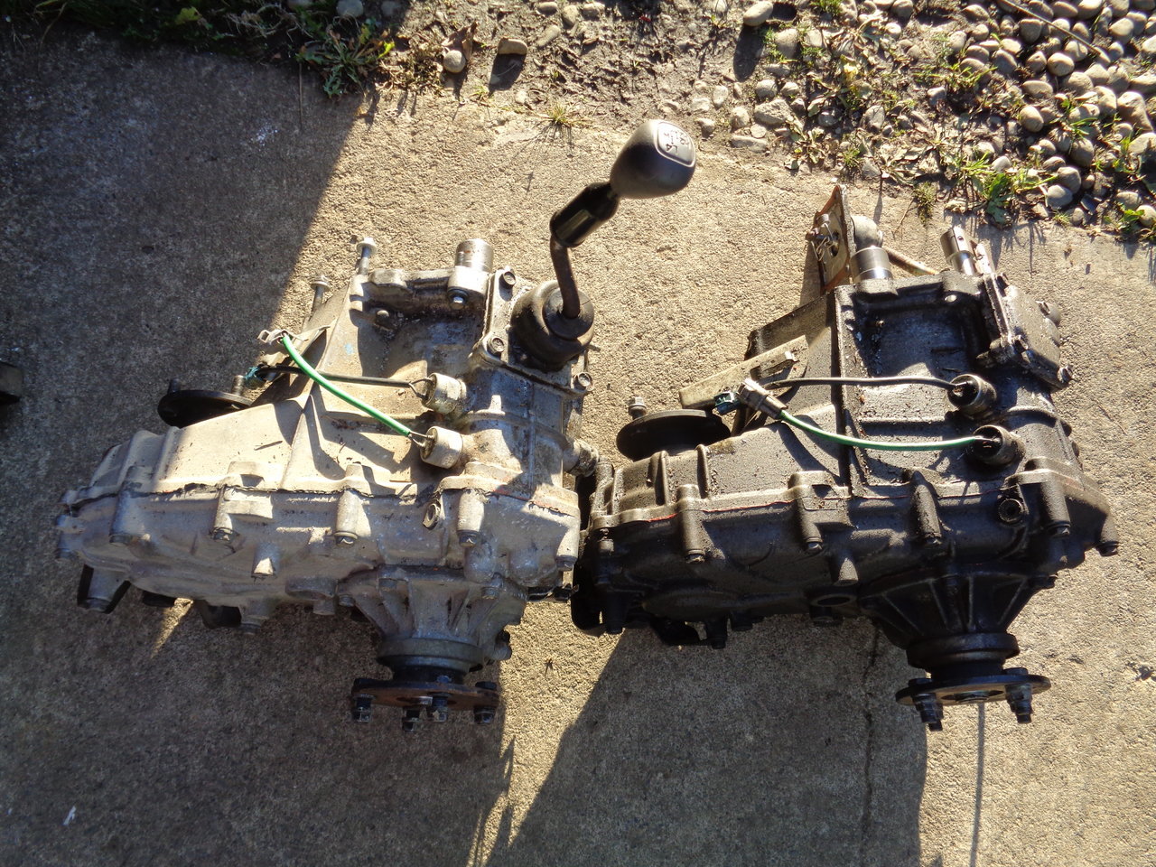

    This is for automatic transmission, that I am aware of. The clean transfer case is v6 top shift and the other is 4cyl forward shift (1999 Tacoma). The 4 cylinder engine was moved back 3 inches requiring a forward shift transfer case. I found this out when I first changed my v6 truck to 4x4 with a 4 cylinder donor truck. I did not get it right away. I had to find out when the shift lever would not mount. I just put it in 4 hi and drove to get the correct transfer case in front wheel drive as I did not have the rear drive-line yet,LOL.

    This 1999 Tacoma was a 2.7 auto 4.56 gears and a forward shift Transfer case.

    OK. So it is still an R100 just a different shifter orientation. From the picture it looks like I could swap in the top shift to transfer case if need be. Thanks for mentioning this as I would not have known to look for this difference and would have found out like you did.
