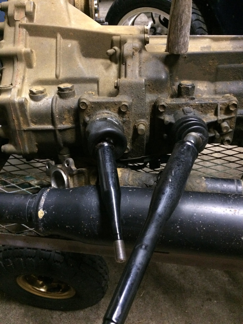

    Tbimm
    Tbimm [OP] Well-Known Member
    Sep 23, 2017
    #230865
    126
    Tom
    Belle Chasse La.
    2000 Tacoma Prerunner
    Bilstein 5100's front and back. OME 880 front coils. General HD rear springs. Fuel 16x8 Enduro rims. Dick Cepek Extreme Country 285/75/16's Some kind of headers. K&N cold air intake.
    Here is a picture of the transfer case out of the 98 Tacoma I am buying parts from. 4cyl, standard trans. Looks like I now need to see if he will crack them apart to count the splines.

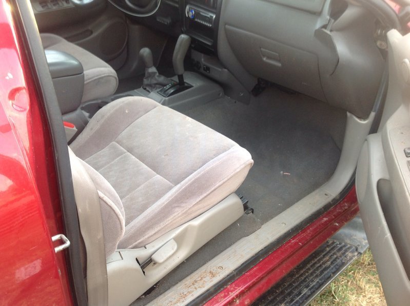

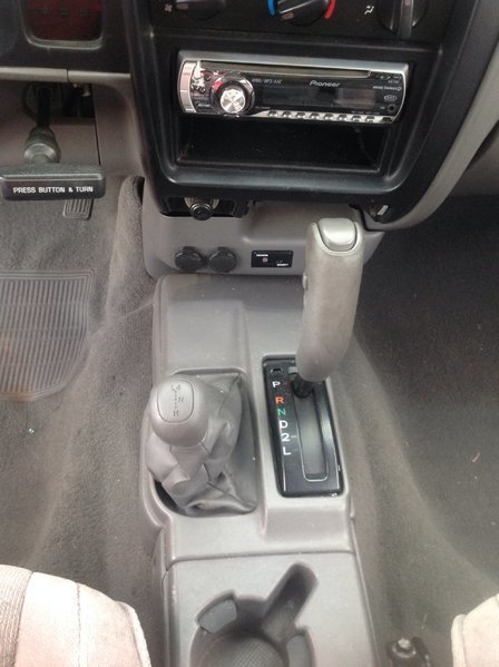

    jtanner21
    jtanner21 Well known scammer
    Jul 14, 2017
    #224044
    694
    2004 Tacoma 3.4l Extra Cab
    So far for my 4x4 swap For my 04 Prerunner I have Auto Transmission, Transfer Case (ADD), axles, full driveshafts, front differential (ADD), interrior shifter housing, 4wd Spindles, and transmission mounts, might be missing a few things but what else do I need? Mainly curious about the ADD system and what extras I need to find to

    Do you have the entire interior shifter assembly? You can use your 2WD one but it's cleaner and easier to just swap the whole shifter assembly.

    I have the whole assemby was going to take it apart and keep mine but if it's easier to swap the whole thing then I can do that.

    You wouldn't have to cut the hole for the t-case shifter and transfer the rubber boot - the whole shifter assembly is held on by 10 or so bolts.
    Now do you have the pushbutton t-case or the manual j-shift?
