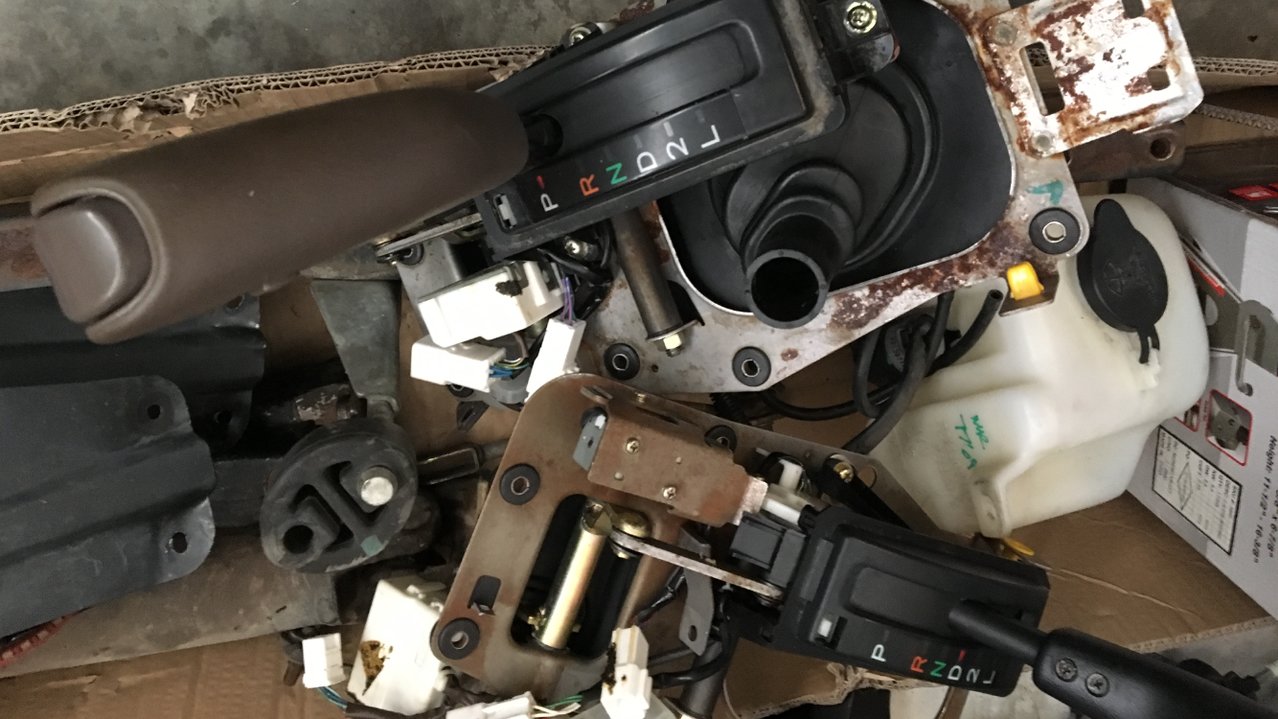

    I'm actually using the shifter console and front differential from a 1996 4Runner Limited. Unlike the Tacoma the 4Runner came with black interiors and I personally like how it looks compared to the Tacoma gray/tan/brown.
    Depending on your gear ratio it'll be easier to find on 4Runners compared to Tacomas. For example, I have a 4.30 rear which is incredibly rare for the front end on a Tacoma. Very common on certain 4Runners on the other hand.
    Tacoma shifter on top, 4Runner shifter ok the bottom. They're identical.
