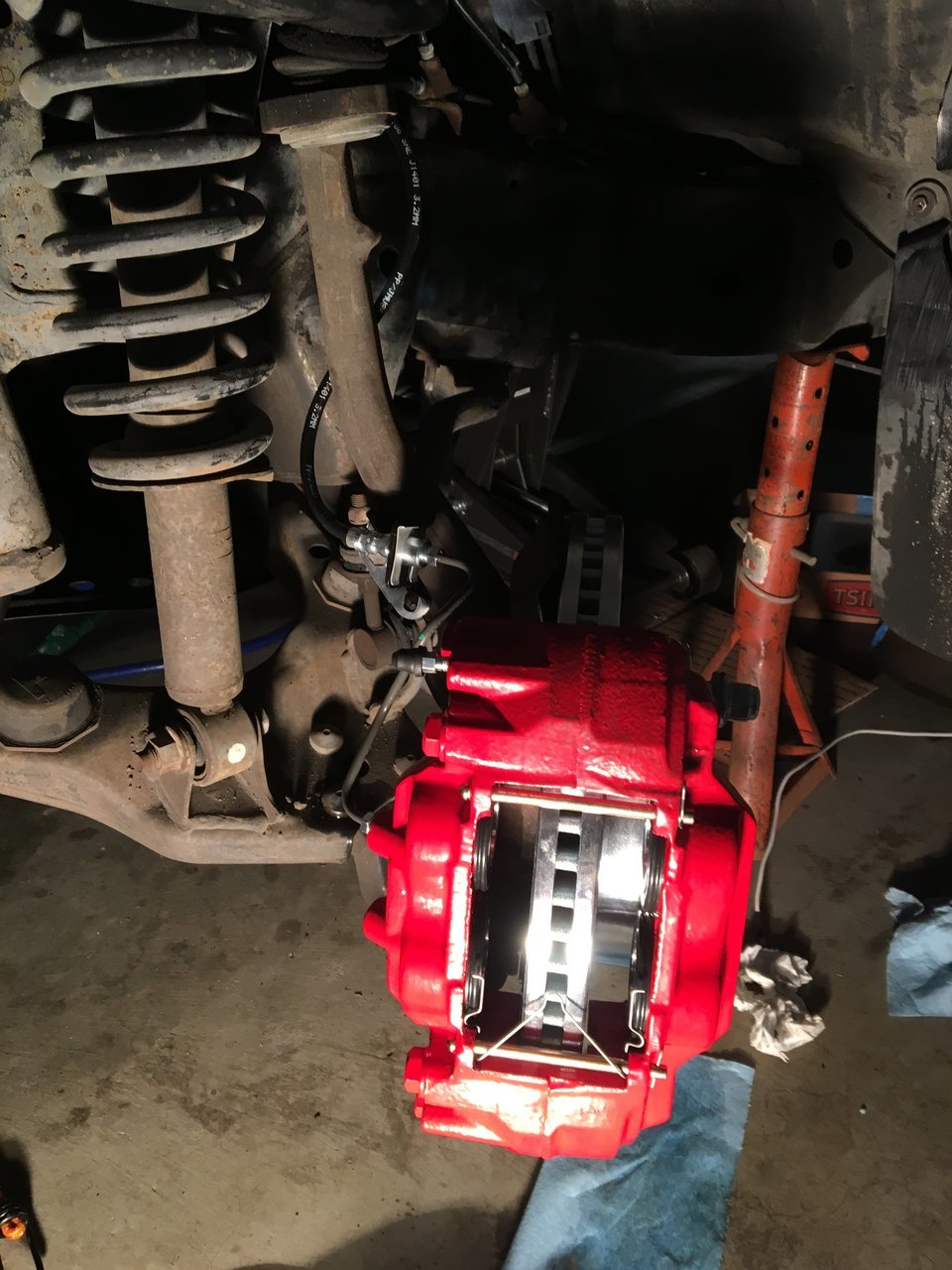

    I would buy aftermarket brake lines like the one from LC Engineering. You can't use the stock Tacoma like unless you drill out the banjo bolt. Tundras don't use banjos they use a hardline with a flare end

    I like the LCE kit because it is identical to the Tundra setup. The Tundra/Sequioa use a soft brake line followed by a hard brake line to the caliper.

    The LCE kit says it is for swaping Tacoma to S13WE calipers, are the 13WL calipers the same? I'll be using the (larger) 13WL calipers. Also does the LCE kit extend the brake lines, or just replace them?

    I just messaged LCE asking if this kit will work with 13WL calipers... the answer was
    Quote - "No sorry"

    Exactly the same. I'm running them on my truck. The S13WE is just smaller than the 13WL - the brake lines are still the same. I used them no problem I don't know why they're advertising them for S13WE.

    ...lolwut? I am using their S13WE kit just fine no issues. Installation was a breeze.

    BartMaster1234
    Aug 21, 2016
    #195197
    45,867
    Tyler
    Pittsburgh, Pennsylvania
    Flux Capacitor

    Yup I’m also running 13WL and just utilized the stock hardlines without any issues. Cut the dust covers and called it a day.

    The 13WL and S13WE are identical brake line wise, the difference is the piston size and physical size. They both used the same brake lines and hard brake lines with the same flared fitting

    I don't know if that Tundra knuckle will swap, but no need. I have 13wl brakes on my 00' 4runner (so worth it) just trimmed dust shield. I also have slotted rotors on my 96 LT Tacoma (3 sizes smaller than 13wl, lighter truck tho) and it stops great! Good pads will go along way, IMO make what you have work.
