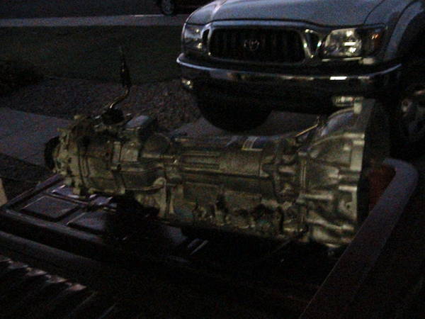

    Whatcha talking about? the transfer case thats already installed?
    Whats that do?
    How do you take out a transmission and swap output shafts?
    Help :(

    It's an 89 Toyota Pickup. I got some stuff done to it.. FJ axles going under it soon.
    Split cases

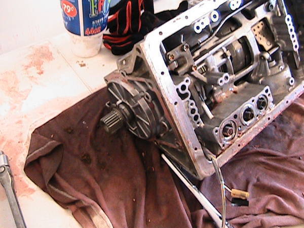

    Will it look like this?
    And this?

    And it's possible to turn your 5 lug into a 4wd...easiest way would be to SAS..doesn't seem like it but your 5 lug front was never designed nor will work for a front driven suspension.
    Unless you could modify some Ranger/Explorer shit to work up front..which anything can be done..with time and tools and mostly importantly skills OR money gets shit done.
    You still then gotta do a case cross member, then swap tailshafts out on 2wd transmission to be able to bolt a case..or swap in a 4wd transmission.
    Front driveline..steering of some sort.

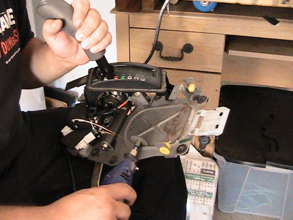

    Do I have to pull this stuff out?

    and cut this?

    Some shit like that..or it seems like it goes like that.
    Doesn't always work for some dumb reason:anonymous:
