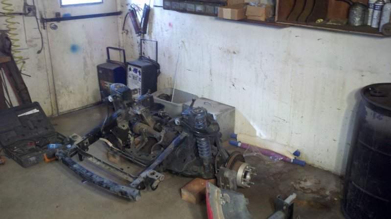

    I sold my front frame and all 4x4 parts when I did the sas for $600 minus the transmission. I think I could get that price all day long.
