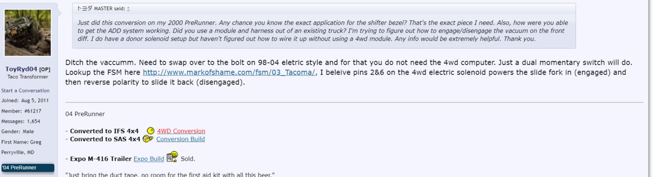

    https://www.tacomaworld.com/threads/toyryd04s-4x4-conversion.442349/
    As for ADD and having to run vac and all that assorted stuff - might want to review that thread I just listed. Note the OP kept ADD and in fact has it setup where it works without vac.
    Not saying its easy and its certainly going to require some creativity. I went the manual hub route and I'm fine with it but damn if sticking with ADD doesn't sound interesting. Oh and yeah, his PreRunner is an 04.
