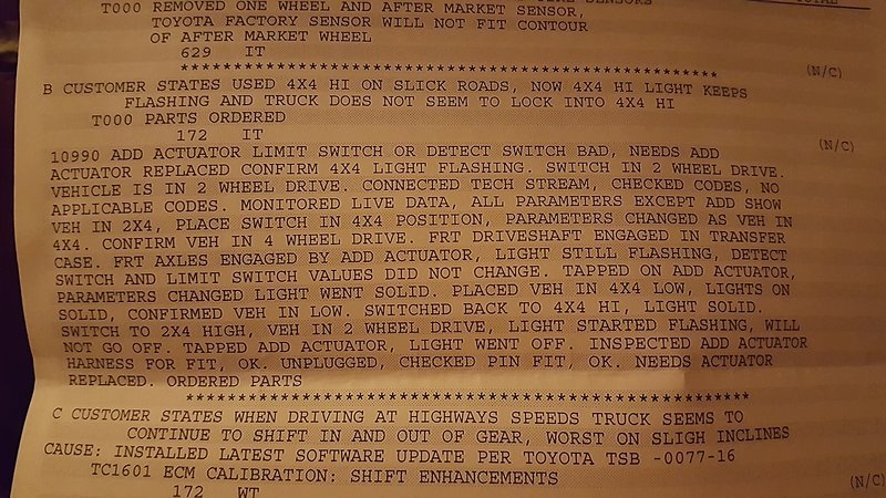

    Okay so i spoke to my dealership service manager (great guy BTW Steve @ SpradleyBarr Cheyenne) about this and he cant figure this out and before i drive the 1.3 hours to the dealer i thought i should go to the source for thoughts....
    I recently threw my truck into 4H for about 30 seconds while driving @ 15MPH. Switched it back and the green 4X4 dash light has been blinking now for 3 days????
    Tried neutral shift, reverse, putting it back into 4H and back into 2WD etc.. and no luck
    Thanks folks

    UPDATE:
    So, after putting my truck into 4H for 15-20 seconds on a flat dirt road my 4X4 green light would not stop blinking when i put it back into 2W. Took to shop and they said the below "Actuator Limit Switch " was bad and the part is ordered. They said mechanically the trucks 4x4 system is engaging and good its just the electrical sensor thats bad BUT today we had snow and i put it into 4H and got a flashing yellow triangle and a notice on my dash LCD stating "4 wheel drive from 2W to 4H did not function-a malfunction has occurred"?!?!?!
    Ughhh

    If I read your report correctly it appears they unplugged the actuator, but doesn't state they plugged back in. If that's the case that may be causing the error message yoy saw this morning. I'm just guessing as I am not that familiar with this system, I'm used to actual shift levers for engaging 4 wheel drive. By looking you can tell if it's unplugged.

    Thanks Guys,
    It goes in next week to have switch replaced. I guess its a 5-6 hour work order. Whole front diff has to come out... we will see;)
