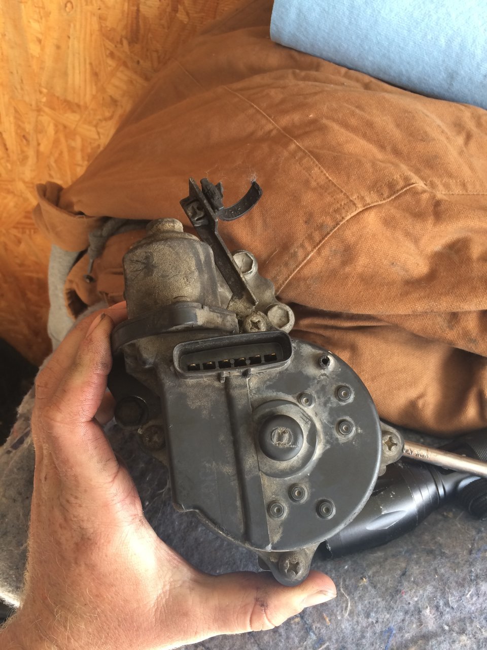

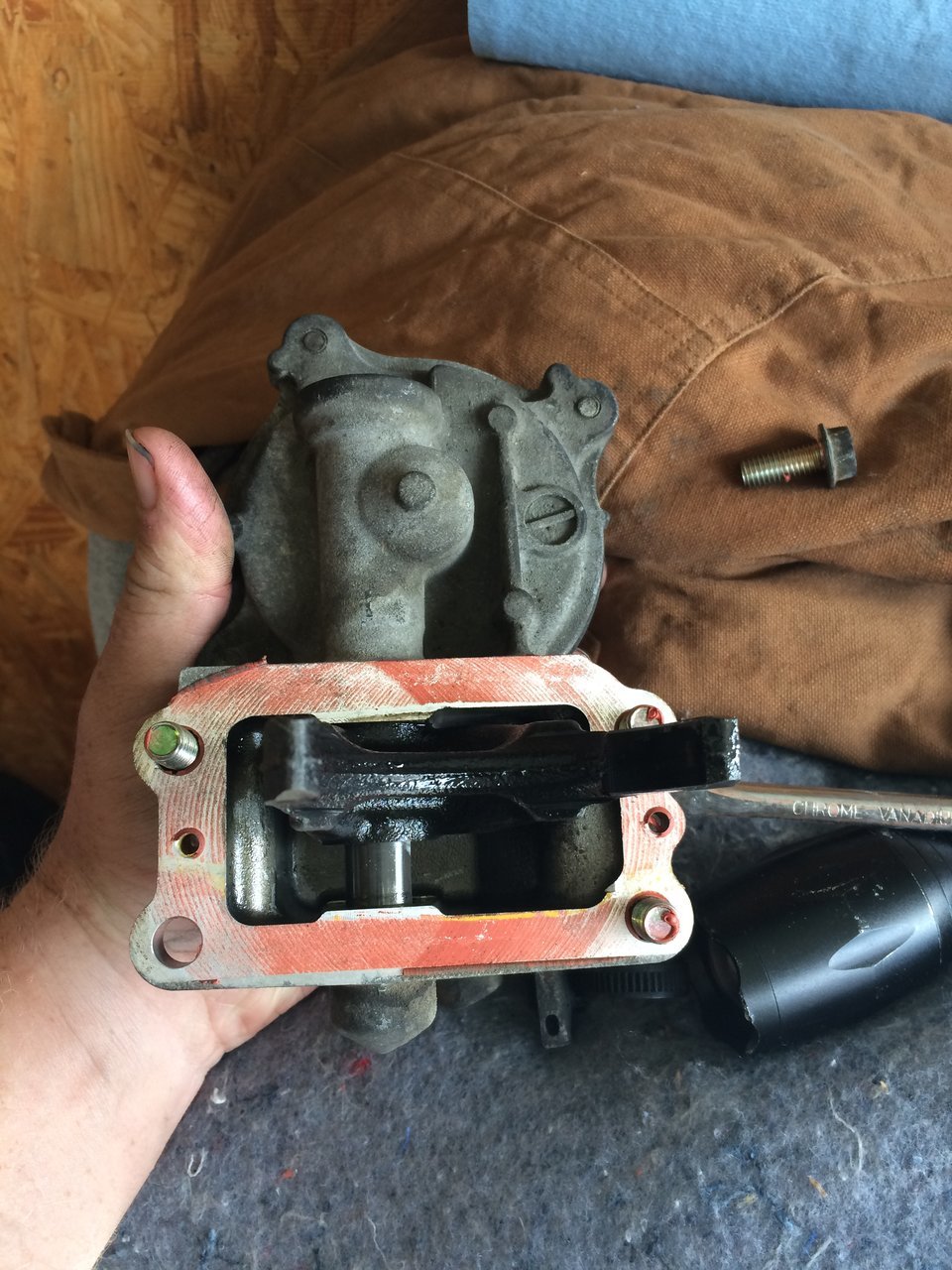

    hey guys I was planning on install my diff into my Pre-Runner conversion truck today but hit a snag.
    I took the actuator off the differential to do the hose clamp trick so it will be fixed to 4x4. The problem I'm facing is that the fork will not slide freely so I can position it with the sleeve inside the diff into the locked position. The fork is on the opposite side it needs to be. Also the small nipple that you hook up the vacuum like is also broken. So any ideas, tips...
    any help would be appreciated

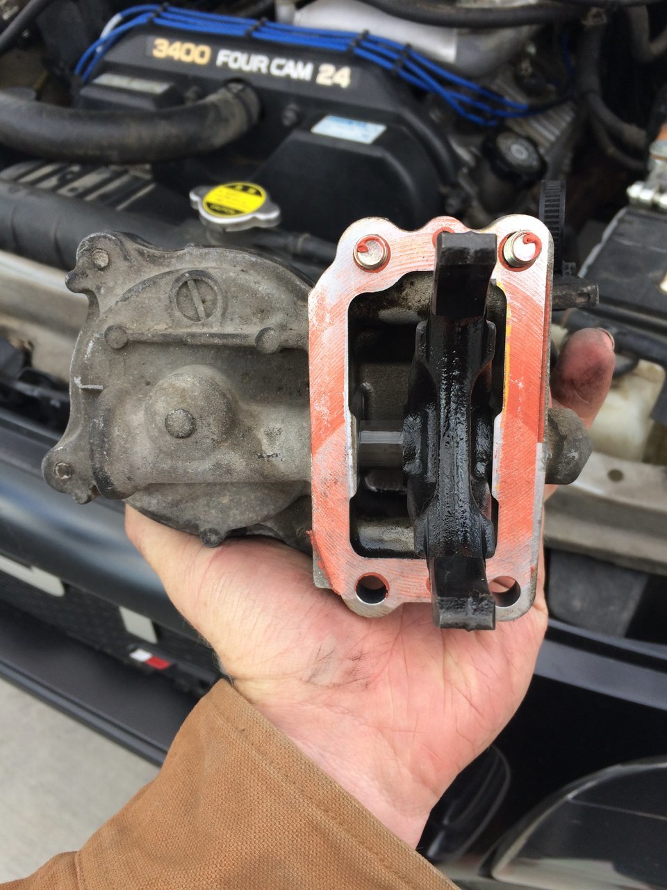

    The fork is stuck in that position

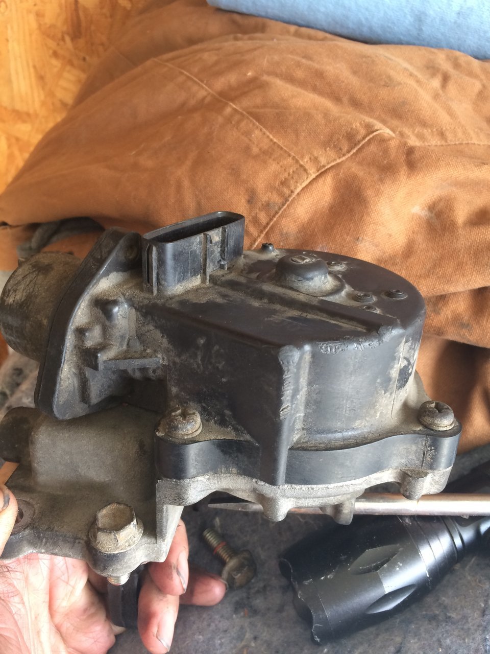

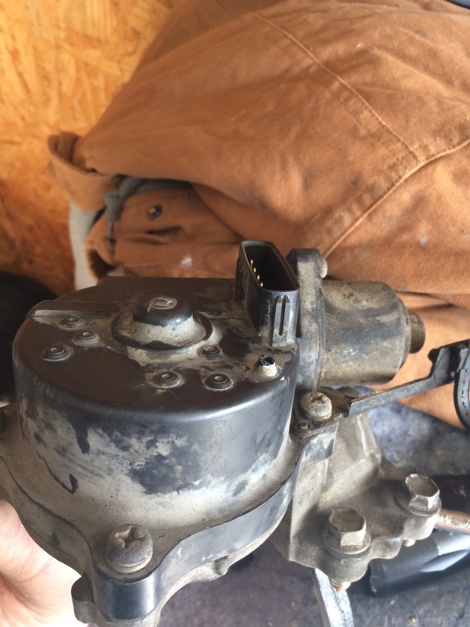

    You have the later style all electric actuator. The hose is just a breather vent. You will need to "run" the actuator to the locked position or take it apart, separate the gears, move the fork then put it back together.
    To "run" it, touch 12v+ and ground to the two pins for the motor. If nothing happens reverse the polarity. See "ADD motor", second pic.

    Thanks man! I’ll hook up some wires and see if I can get it to move

    Got it! Thanks man.

    Due to the nature of the gear system (worm gear), all the mechanical advantage is on the motor side. Hence you can't just push the fork back and forth like the vacuum type. A clamp is not going to hurt and may provide piece of mind.

    Yeah no worries man I got it fired up and the fork moved over
