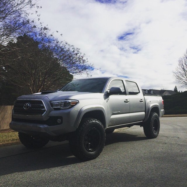

    Anybody having this issue? Mine seems to be doing it after 40mph
    Running the drive shaft bearing drop kit.
    Noise goes away if I go from h2 to h4
