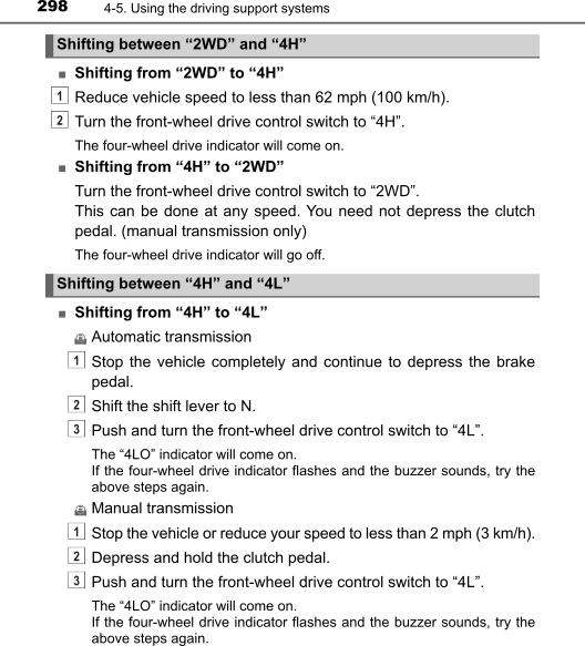

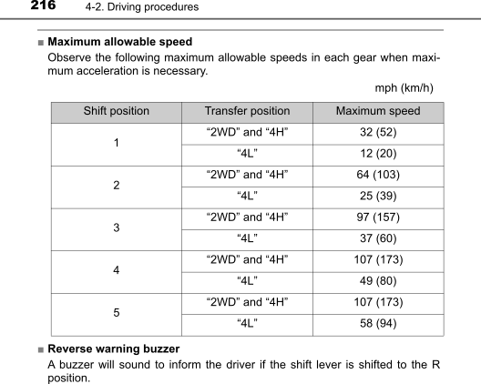

    This is from the 2020 Tacoma Owner's Manual:
