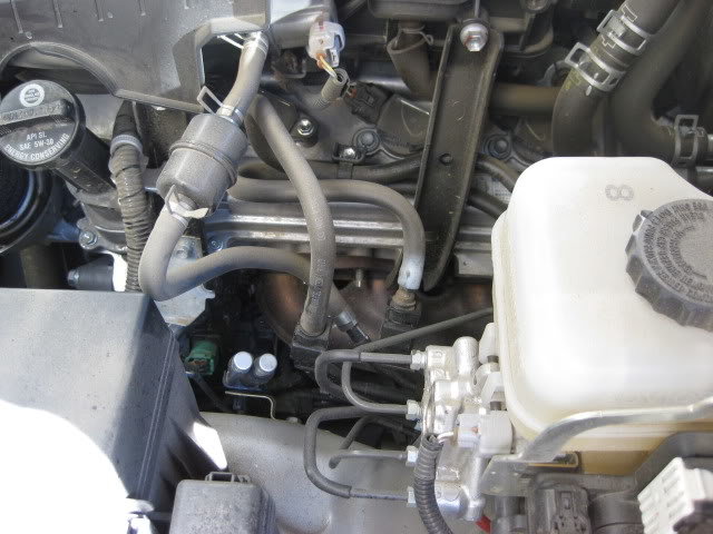

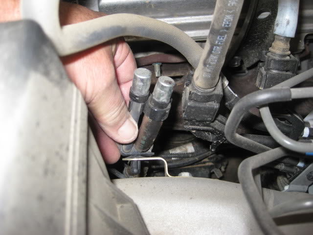

    Yup,
    The two rubber tubes that are attched near the battery with silver caps on top are the breathers for the front differential and the ADD. This is something many of us have down on the rear differential so it doesn't get contaminated... see link in my sig. below!

    Front differential and ADD breathers:
