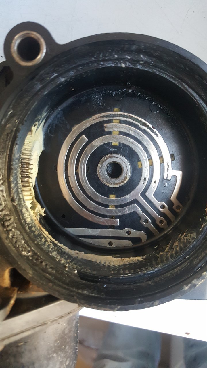

    you might want to take it off and looks at it. it's held on by 3 screws. the connections on the cap were worn down on mine. I replaced it with one from a junk yard and fixed the issue.

    this is what mine looked like that caused the problem

    Thank you for the reply- done for the evening next step is to replace the switch with the continuity issue- then check out the xfer case actuator.
