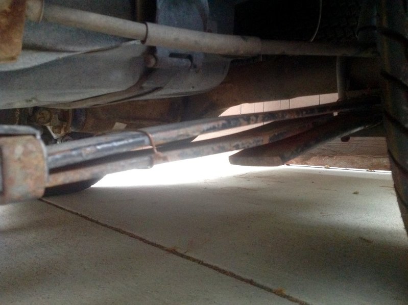

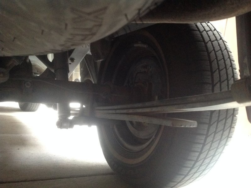

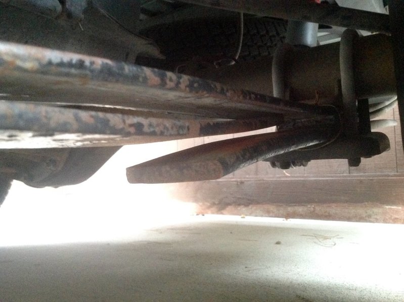

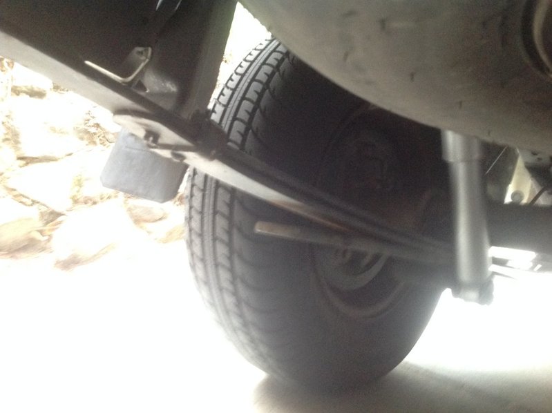

    Sweet, thank you! I'm on a pretty tight budget and appreciate any advice. The first pic is my passengers side, second is drivers side, and the third and fourth are the broken leafs on the drivers side. (Excuse my ghetto tie wire rig, didn't want the broken leaf to hit my tire or gas tank)

    Thanks for the pics, good angles..... OK looks like you have a 5 lug SUA & those are nasty breaks, don't even think about a new set of aftermarket springs....yet anyway haha. Now since most the 'yotas rollin' around are 6 lug SOA & you are SUA the fix for you is a little different, if you're mech. inclined go to local wrecking yard & look for some Chevy S-10's , once you've found some notice that they're SUA as well,you need the rear springs off this to build yourself a solid leafpack that'll hold up. I'll post up a pic or 2 of some springs I've done...

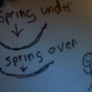

    Disregard my crappy drawing but hopefully it'll make my point..
    Ok despite crappy drawing you can see that the SUA (you)spring has more radius than the SOA below it, now the problem will be is when you go to clamp the SOA 4x springs to the more ARC'd SUA main spring you are going to end up lowering your truck because the main spring is going to yield to the shorter/stouter/less ARC'd donor springs....
    mohavestubbs[OP] and T4RFTMFW like this.

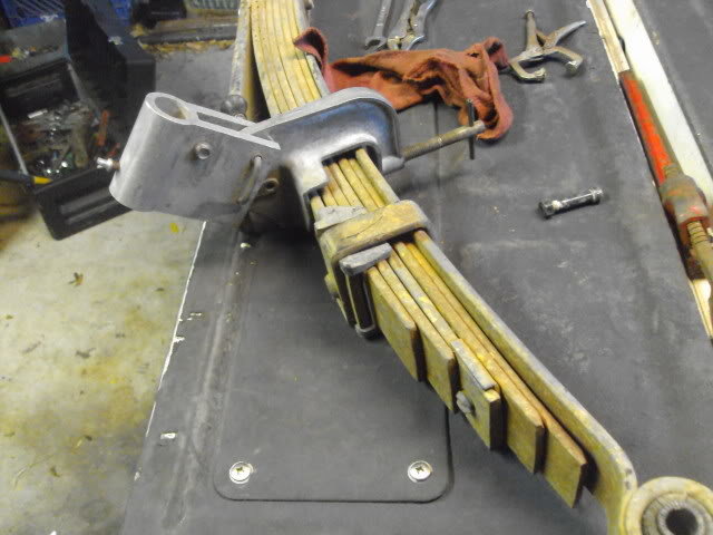

    1 ton chevy S-10 SUA springs.....(you don't have to find a 1 ton OEM s-10's will do)DSC06814_ca69e29931434d65337435a97977c148b8aada4e.jpg
