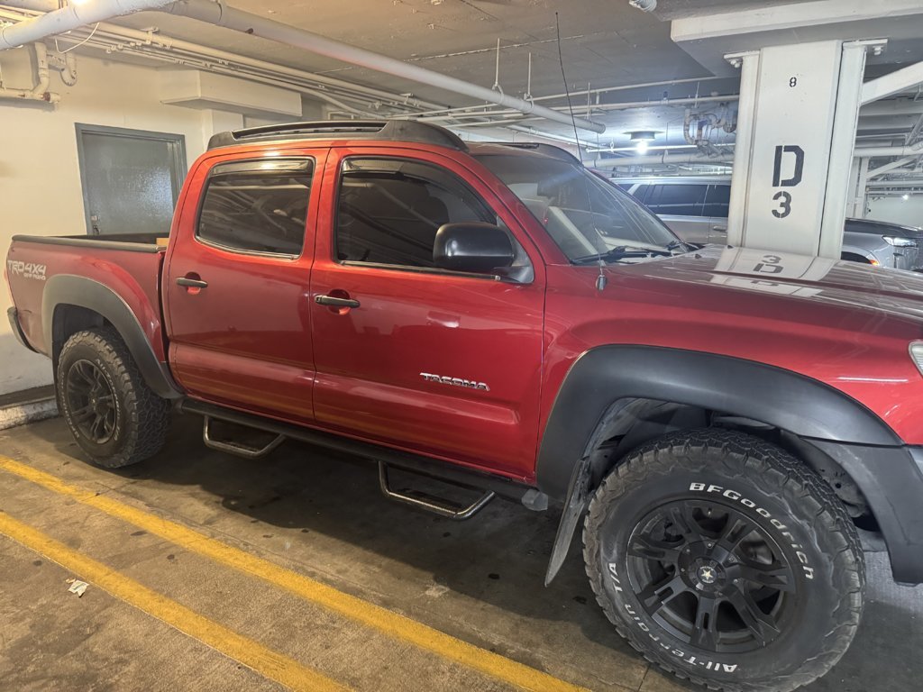

  17. Oct 8, 2024 at 12:57 PM
    #17
    08taquito12
    08taquito12 [OP] Member
    Oct 7, 2024
    #458403
    21
    Jason
    2008 red Tacoma
    This is the truck
    Dm93 likes this.

    Nice looking truck
