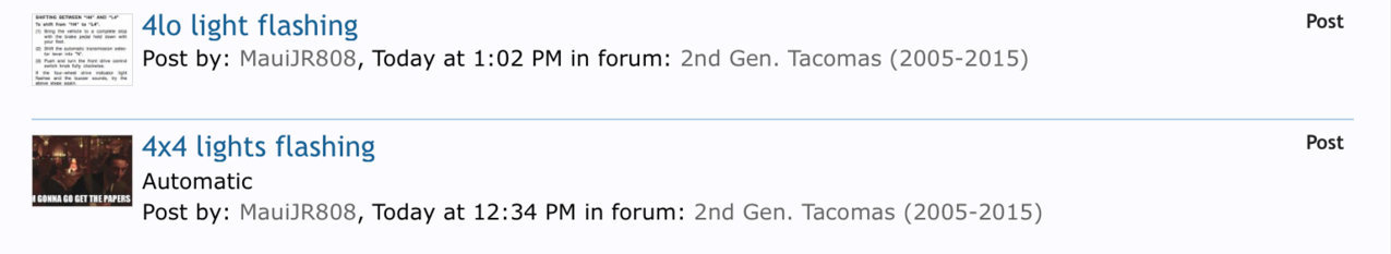

  8. Jan 20, 2021 at 2:15 PM
    WillTheThri11
    WillTheThri11 Well-Known Member
    Mar 19, 2019
    #287199
    111
    Will
    2006 Tacoma Access Cab TRD 4x4
    Bilstein 5100s
    why did you post this twice?
  9. Jan 20, 2021 at 2:55 PM
    No Shoes Nation
    No Shoes Nation Well-Known Member
    Sep 20, 2019
    #305845
    906
    2008 Taco SR5 Access Cab 4.0 4x4
    Hmm . . . none as yet, that's why i'm here . . .
    Why did you read it twice
