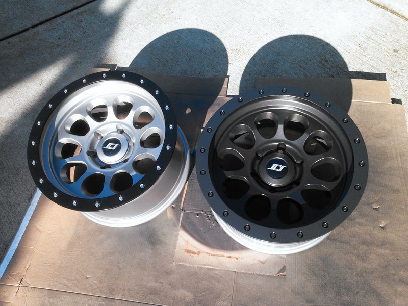

    Cut & broke off some stuff.
    curing in the garage now.
    jubei and BYJOSHCOOK like this.

    The more i look at the copper edition the more i like them. I emailed vin and he has a ser of 4 coppers that are blemished. I was going to buy them but they are a little too blemished for me. Just going to wait till march when he said they we be back in stock and order a full set of 5.:rofl: The price of the blemished wheels vs new wasnt worth it

    How'd you go about paint them?

    i just used some spray paint off the shelf. cheap and easy to touch up if needed after some time. (or if i just want a new color someday)

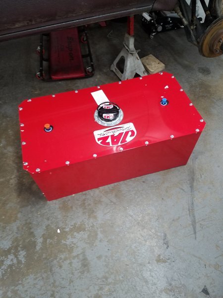

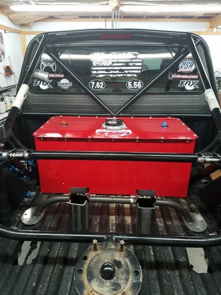

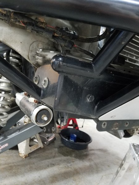

    Dig the bumper, is it welded or bolted on, if so I'd like to see how you bolted it on. Thanks!

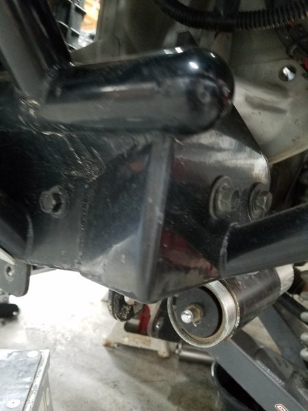

  17. Feb 12, 2017 at 1:06 PM
    #117
    Long_Travel_2002
    Long_Travel_2002 [OP] Well-Known Member
    Feb 22, 2016
    #179105
    572
    ivan
    memphis
    2002 tacoma LSA swap prerunner
    built supercharged LS, T56, Linked, caged.
    Thanks, It is bolted on. It bolts on in the stock locations 2 in front, 2 on either side, and 2 up from the bottom each side. And the fenders bolt to it as well. 20170212_145706.jpg

    Looks very well made :thumbsup:

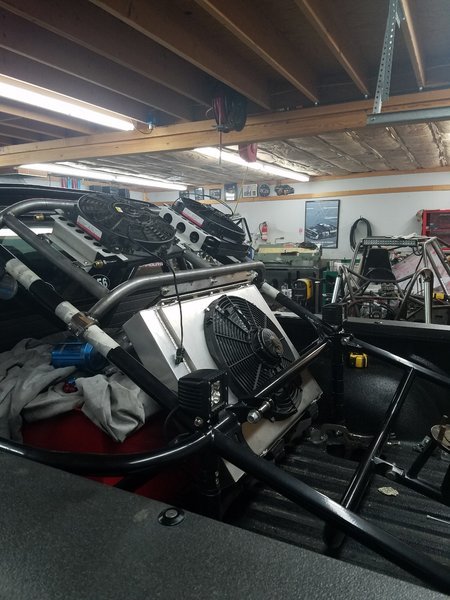

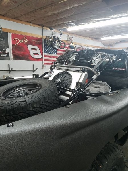

    Got all the fans finished up in the rear. Looks so sick

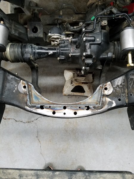

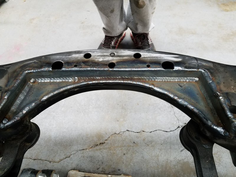

  20. Feb 15, 2017 at 8:41 PM
    #120
    Long_Travel_2002
    Feb 22, 2016
    #179105
    572
    ivan
    memphis
    Notched the front crossmember a little bit just dor some extra clearence. 20170214_175841.jpg20170214_175847.jpg
